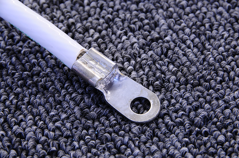

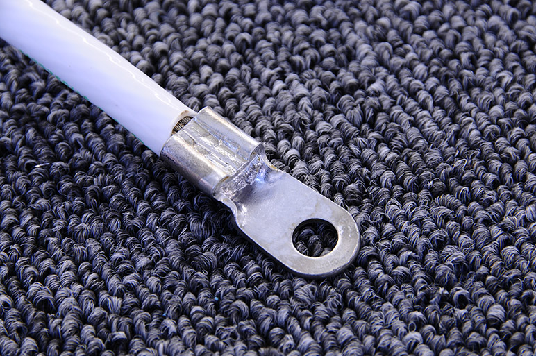

It would seem that crimping *after* soldering is a sure way to ruin a good termination. However, adding a small dab of well wetted solder to the *lug* end of the terminal after crimping seems like a good belt-n-suspenders approach to me. What do you think of this technique, Bob?
technique, Bob?
What you've shown us certainly doesn't hurt
as long as you don't get solder on the washer-
surface of the terminal and make it "un-flat".
But I cannot offer that it adds anything
useful.
