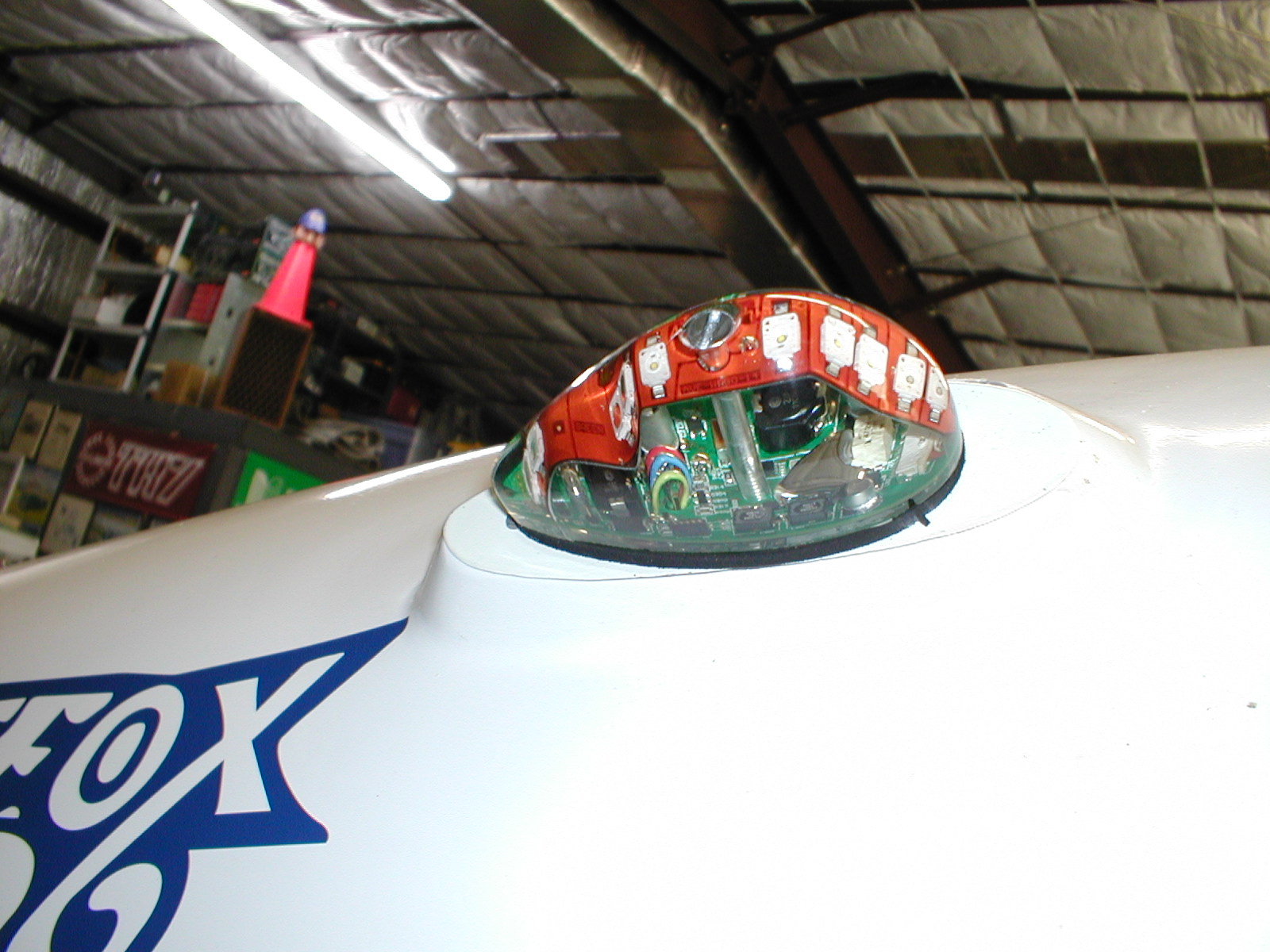

Hi,
I am new to this list as I decided to expand my information input.
In regards to The Aveo strobes,I have them on my Kitfox. The amp load is very low and that is why I bought them. I removed my Whelens and sold the set on EBAY. Now I wish I had them back. The Aveo's work well but they are no where near as bright as the Whelens.
        Dick Maddux
        Kitfox 4-1200
        Rotax 912UL

PostPosted: Tue Jan 27, 2009 8:52 am    Post subject: Strobe Lights Reply with quote
Dick,
I to have switched out my Whelen strobe system for the Aveo. I on the other hand really like the system vs. the standard strobe setup. First I would say the important issue is visibility in flight not on the ground. Our tests (not formal) show that a new Whelen strobe is a bit more visible then the Aveo. We also found that the Aveo is more visible then the Aeroflash system. Most importantly we noted that on three airplanes that had Whelen systems that were two years or more in age the Aveo was the same or more visible. The pros to the Aveo system: in most installations a 3 plus pound weight savings was achieved, a savings of 170 watts +/- 20 depending on which brand of strobe you installed( that's 14-amps on a 12v system), the Aveo does not put out high voltage and therefore is less problematic with RF noise, the Aveo light life has a 20,000 hours life and is virtually maintenance free, the Aveo unit takes up much less space, and most importantly, if you find the right dealer the price is half or more depending on which brand of strobe you purchased.
Just my take,
Mike Larkin
