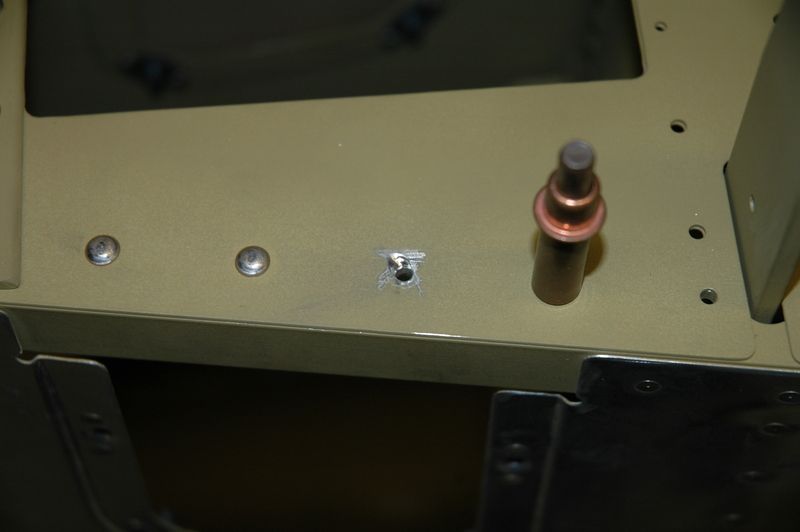

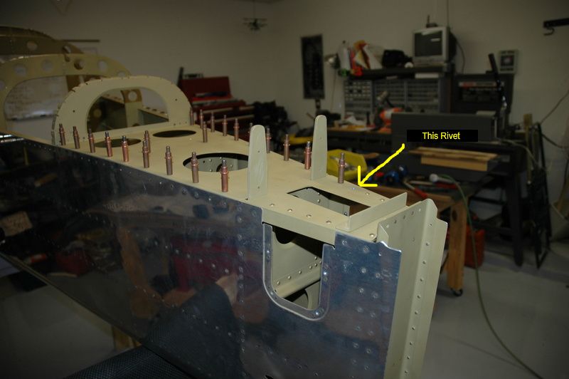

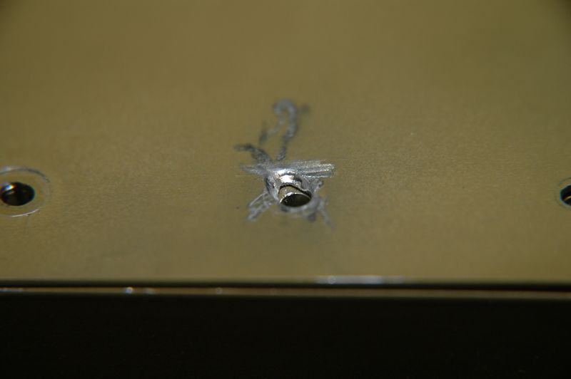

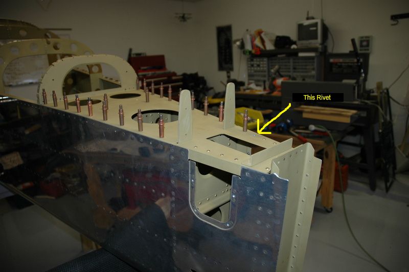

Hi Everyone,
I'm going to be sending this to Vans too..
Tonight I was riveting the aft deck to the longerons of the tailcone. In the process, I screwed up a rivet and tried drilling it out. At that point, Murphy slapped me on the back for a second time and I managed to drill adjacent to the original hole.
The good news is that I just barely touched the surface of the longeron, so it's just fine. The damage has been limited to the aft deck only.
In the photo's below, you can see the longeron on the bottom and you can see that I've polished out the error to try and reduce the possibility of cracking later.
I've got a couple of options.
1) I can drill for a 5/32 rivet, but that won't completely remove the mistake.
2) I thought about drilling and replacing with an AN3 bolt - That might remove it.
3) I thought about drilling the hole to be perfectly round (in the aft deck only) and then placing rivets on either side of the hole. In this case, the screw up would be similar to a lightening hole.
4) Just drop a rivet in and keep going.
5) Start over again with an entirely new aft deck. (Obviously last resort if I can't find a reasonable repair)
In the process of the mistake, I've been trying to figure out what the real purpose of the aft deck is.... (???) I'm guessing it is designed to keep the longerons from pull apart or pressing together in the aft end of the aircraft.
Anyone have any thoughts?

Perry, Phil wrote:
Hi Everyone,
snip
the mistake.
The drill will wander in the oblong hole, making a larger oblong hole.
might remove it.
Gross overkill. And gross looking also!
Far more work than necessary.
I vote for this one. Should have been choice #1. All you really need
is to attach the longeron to the aft deck. Setting the rivet will
mostly fill the hole.
Only if you're a real purist. I would bet money that there are quite a
few holes just like yours out there with a std rivet in it.
Yep! If that's the only boo-boo in your plane, you're way ahead of me.
I'm no expert by any means, but I think you put yourself through far
more stress and anxiety than necessary. But, just to be on the safe
side, maybe one of the experts will let us know if my reasoning is Ok or
not!
Best of luck.
Linn

PostPosted: Sun Jan 25, 2009 11:06 pm    Post subject: No expert here ...... Reply with quote
What - you do not have a perfect plane like I have?????????
The aft deck is very important structurallyvto prevent excessive torsional stress on the tail feathers.
I am an absolute neophyte here but my suggestions (and I stress they are only my uneducated suggestions)
1. drill it out and set a #5 rivet there. It will get a clean set, and it will fill out most of the hole.
2. Add a small doubler plate on top if it does not interfere with the mounting of the tail feathers. (I do not think that it does there.)
3. I do not like the AN3 bolt suggestion - hole too big - might compromise the longeron.
4. Finally - ask an A&P or one with an I/A. they do these kind of repairs every day.
To err is human - but to really screw up you have to be an airplane builder
See you OSH '18
Q/B - sold.

PostPosted: Mon Jan 26, 2009 7:12 am    Post subject: Mistake on the aft deck Reply with quote
Mike,
If you don't like the AN-3 bolt you will hate the tail cone to main fuselage longeron connection...there are three of the on each side, counseling may be required for you to drill those holes and install the bolts to deal with all the hate you will build up inside!! Smile
There is also two AN-3's that hold the stabalizer mount angle to the deck. So Linn, it's already ugly!! besides the fairing will hide it in the end. Since the SB came out for the tailcone, I'd bet there are a BUNCH of rivets in that area on lots of -10's from drilling off the deck and redoing it.

PostPosted: Mon Jan 26, 2009 7:26 am    Post subject: Re: Mistake on the aft deck Reply with quote
Phil,
An AN3 bolt would work IF you could keep it on the centerline of the longeron. I would do what AirMike suggested, go to a larger rivet.
Another option would be to go to a #8 screw. Just polish up the unwanted hole a little with a dremel to get rid of the possible crack starters, drill to a #8 screw, use a large washer on top if you can't stand anybody seeing it, and torque it with the red colored lock-tite. Screws are much stronger than rivets, anyway.

PostPosted: Mon Jan 26, 2009 10:17 am    Post subject: Re: Mistake on the aft deck Reply with quote
Don't fret too much - we have all done this. The standard method to deal with it is to go with a larger rivet. Drill it out for an AN5 rivet. If it is still a really ugly hole, then try an AN6. The rivet will deform and fill the voids so a somewhat oval hole is OK. The larger rivets have much bigger heads and will also hid the sin.
