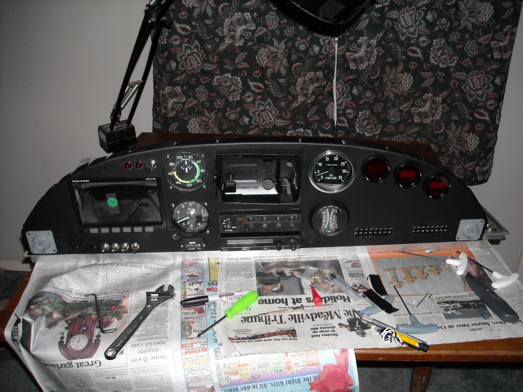

Does anyone have pictures of their old-school sight gage fuel indictor installation? I have about 4" of vertical room in my panel to affect an installation. Picture attached.

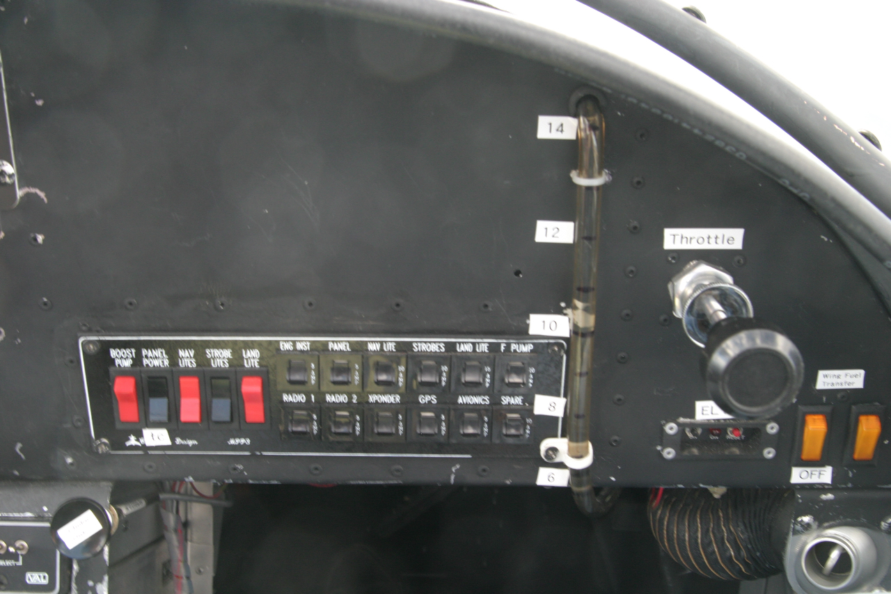

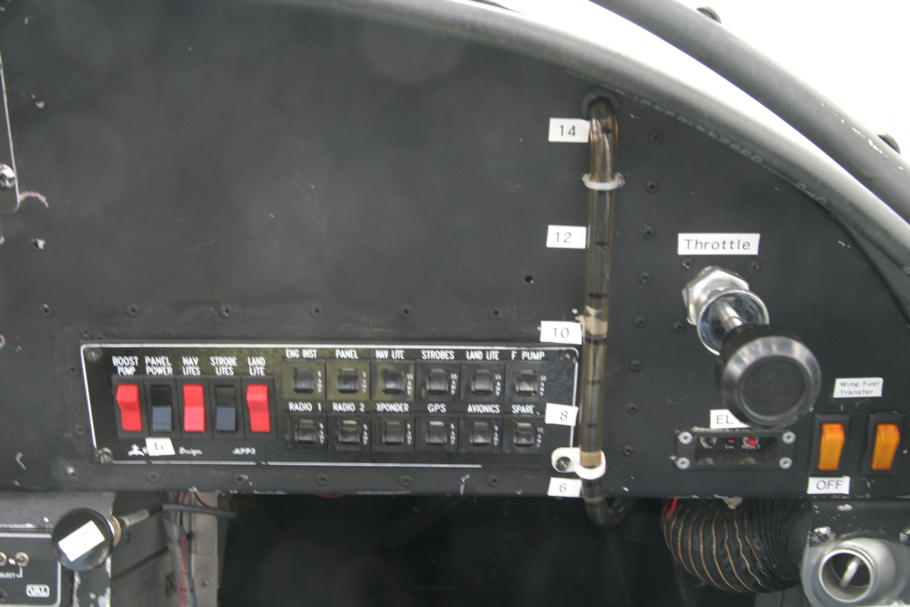

Bill
Above is the sight gauge on our 601 HDS.

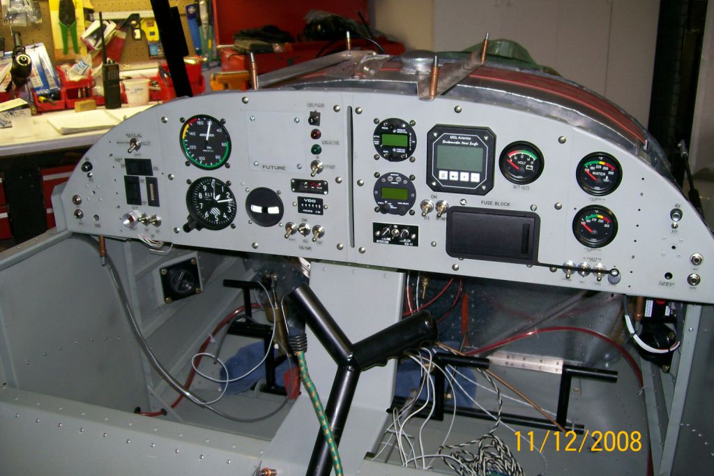

Bill,
Here is what I'm doing. I have a slot in the IP in the middle for the tubing. There are 2 L's riveted to the backside of the IP. I'll use tie wraps or cotter pins to secure the tubing as in the original HDS drawings.

Thanks much for your input. Unfortunately, I don't have room left in my panel to accommodate a sight gage. I can barely start nuts using 14" pliers considering everything I have to work around.
So, here's my plan B question. What sender would you put in? I'm not worried about the wing tanks, just being able to monitor the header during wing tank fuel transfers. A sender with a "Full tank" alarm would be the most useful.
