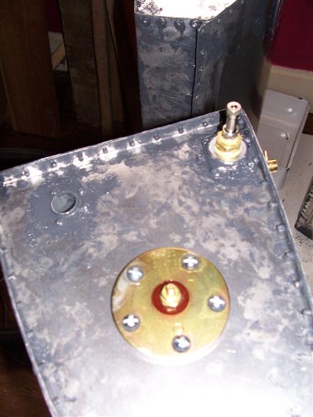

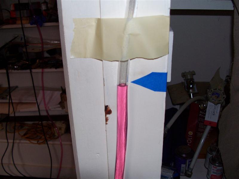

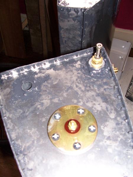

All,
I've assembled my fuel tanks with proseal and rivets. I put about 1/2 psi air in them and have a clear tygon tubing with red food dye attached to a door jamb as pressure indicator. I pump air into the tank with a bicycle pump. I raise the level of the fluid 13.8 inches to give my 1/2 psi and have a pointer to show where I stop adding air. My problem is that I've tested 2 of the 4 wing tanks and they both leaked! The first leaked down several inches in about 10 minutes and I was able to find the leak with sudsy water. The second took an hour to leak down an inch and I haven't been able to find the leak. I'm reluctant to put more pressure in the tanks. Has anyone gone through this, and what was the solution to both finding and fixing the leaks? I can't even get my hand through the filler, so applying more goo from inside seams impossible. Solutions I've considered have been to cut a large access hole in the back of the tank, patch my leaks from inside then patch the access hole. Another thought was form a U shaped bead of aluminum to wrap around the leaky joint, with plenty of proseal thus forming an fix from the outside. But I still need to find the slow leak on tank #2.
If I'm not clear about my methods I'm going to post some pictures on the web site: http://daniel.dempseyfamily.us

here you can see the air valve

My leak detector is just a water collumn

PostPosted: Tue Jan 20, 2009 5:32 pm    Post subject: Leaky Prosealed Tank Reply with quote
May not have a leak in #2 . Make sure your temp is stable
If I remember correctly, PV=rT. Pressure X Volume = gas constant X absolute Temp

Paul,
Thanks for the guidance. Sounds like you did one of the ideas I've been contemplating. Now if I can find the leak in tank #2.
Tony,
Thanks, but it's not temperature. This can be proved by putting the air back in the tank. The indicator always goes down, never back up.

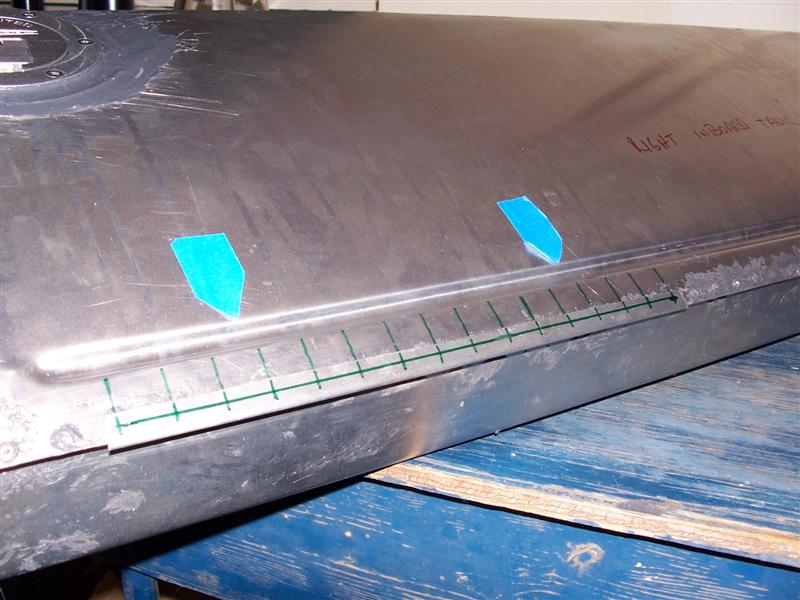

A follow up to my leaky tanks post
Two of my 4 tanks leaked. One leaked on the front seam in 2 spots. The other leaked around one of the threaded fittings. Rather than using a sloshing agent I tried the following.
The leak at the threaded fitting was right in a corner that I packed with proseal mixed with a little bit of fiber glass. This was done on the outside of the tank. There were lots of rivets shop ends poking out for the proseal to grap onto.
The other one was on the long straight seam. I bent up a U from 5052 aluminum and after removing the rivets from the leaky area I wrapped the seam with this U and drilled it to use the same rivet holes. Next I stuffed the U with proseal, hammered it on with a mallet and set the rivets. I should know late tomorrow if this worked.
Here's a picture of the patch.
Dan Dempsey

PostPosted: Tue Feb 03, 2009 9:14 am    Post subject: Re: Leaky Prosealed Tank Reply with quote
Just a final word on this thread. Both the patches worked, so I'm finished with the tanks until installation time. Thanks to those who responded.
