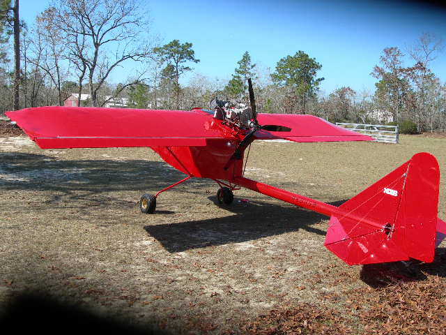

Jimmy Young
Joined: 24 Nov 2007
Posts: 182
Location: Missouri City, TX
PostPosted: Tue Jan 20, 2009 9:07 am    Post subject: Acceptable CQ range for a Slingshot Reply with quote
Kevin,
Is your plane N# 863GB, engine installed by Jerry at Greensky?
If so, I watched Jerry fly it around the pattern in Florida about a
year ago, on a day with close to 20 mph surface winds. Observing from
the ground, it looked like it was flying fine and handling well. If
it's not this one, nevermind. If it is, give him a call to discuss;
he's a really nice guy and I'm sure he would help answer your questions.
Jimmy Young
Houston
FS II
 Filesize:  569.49 KB
 Viewed:  500 Time(s)
Jimmy Young
Missouri City, TX
Kolb FS II/HKS 700
