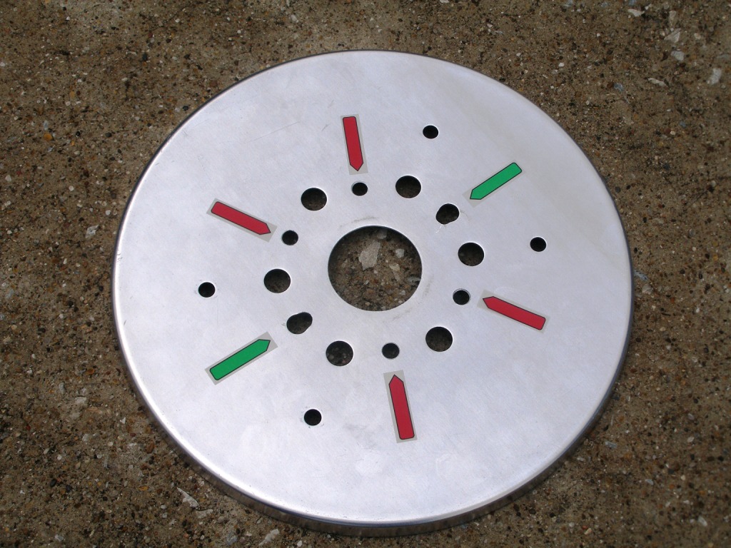

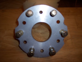

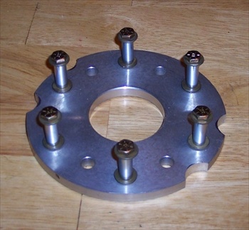

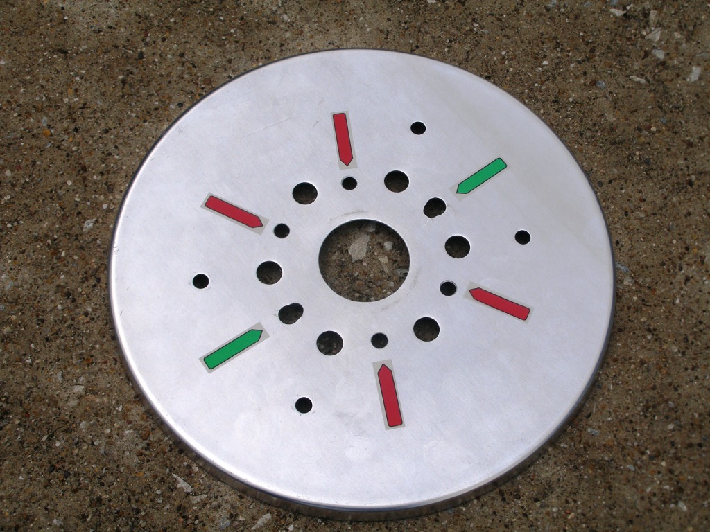

PostPosted: Fri Jan 23, 2009 6:05 am    Post subject: Spinners Reply with quote
John,
Here is the drawing and a photo of the rear bulkhead bolt pattern. You will notice that two of the holes are "enlarged" existing holes. This is OK since the alignment of the bulkhead is assured by the close fit of the bulkhead center hole to the WW hub and a good fit with the other holes.
Van's apparently has several different forward bulkheads for this spinner. The one I got sits far enough forward to clear the Warp Drive prop hub. I didn't have to do any modifications to make it fit that way. I guess the secret is in getting the correct bulkhead.
Let me know if you have questions.

PostPosted: Fri Jan 23, 2009 8:45 am    Post subject: Re: Spinners Reply with quote
Jay,
Are you saying you don't have the propeller bolts passing through the front bulk head? Is there anything holding the front bulk head on to the prop? I don't see any use at all in such an arrangement. Normally one would use spacers, and long enough bolts to attach both bulkheads to the prop/hub assembly.
As to the drawing, it looks like you've confirmed that William is using SAE-1. It appears Vans has drilled the bulkheads for SAE-2 which I believe is 6 bolts on a 4.5" circle. (don't quote me)
Thanks for the post. Denise may skin me alive but I may be purchasing the Van's spinner. I still need to find out if there is enough space (I need at least 3 3/4" between bulkheads, and would like to know the weight of the assembly. One of the list members said he may get those dimensions for me this weekend. If he does I'll post them here so the group can benefit.

PostPosted: Fri Jan 23, 2009 9:30 am    Post subject: Spinners Reply with quote
Jay,
Those are very helpful pictures of rear bulkhead. I will do as pictured. My front bulkhead is also small enough to clear (~1" in front of) the Warp Drive prop hub, and I have no idea how to mount it. Does your front bulkhead mount directly in front of the Warp Drive prop hub?

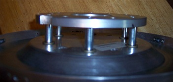

PostPosted: Fri Jan 23, 2009 9:11 pm    Post subject: Spinners Reply with quote
The spinner that Van's sells will work just fine if you do some modifications to it. The Hole pattern is SAE 2 and you can either enlarge the holes in the lower bulkhead or you can drill new one's using the prop hub as a drill guide. If you use the prop hub it will be self aligning with the center hole in the bulk head and then you can simply drill new holes. This bulkhead is in compression so either way (enlarging the first set of holes or drilling new one's) will work just fine.
As for the top bulkhead you can either continue to try and get the one WW makes if you ever get an answer from him....... OR you can go to Lowe's and buy 6 1 inch spacers and 6 flat washers and drill the front bulkhead and crush plate for 1/4 20 screws and that will give you the perfect height for a Warp drive prop.
If you are using a wood prop you will need 6 3/4 spacers and 1 washer. I will post a pic of one I did and you can see it isn't that hard to do. I like the Van's front bulkhead much better than WW's because it makes the spinner rigid and WW's can be moved from side to side but if you can't get one what's the point.
