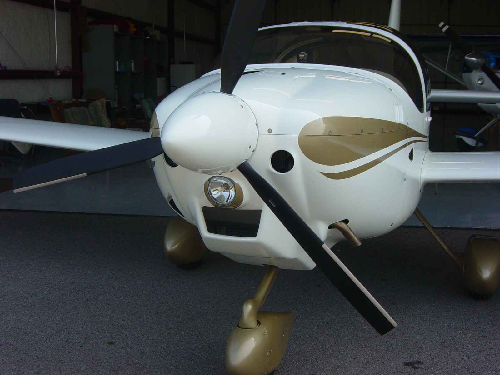

Anyway, here is a shot of the front of Gold Rush. Just in case one of
you might want to take the simple way out of the landing light issue.
This is one of the new gas lights. At first I thought it interfered
with the cooling but after some testing with used oil runs the light
wasn't the cause. It ended up being some bad connectors for my
stratomaster engine monitor.
Jeff R.
A258 - N128LJ / Gold Rush 170 hours but the runway is too soggy to fly
right now. I think the droughts over here in mid Tennessee!

Gee a "gas" light hu who gets the job of climbing out front to light the
thing for landing Smile
but seriously I take it you are referring to a HID xenon bulb.
craig

Yes,
does that landing light run off of kerosene, propane or natural gas???? Smile#)
Jeff- nice light installation. It looks as if it was always there. Those HID
lights put out quite a beam.
I have plans to use the same engine monitor. Were those bad connectors on
the unit itself, or were they some that you put in?
Greg

jeff(at)rmmm.net
PostPosted: Tue Jan 13, 2009 8:07 pm    Post subject: Retractable Landing light or LED Reply with quote
HI Greg,
They we're from my cheep selection. Lows etc. Anyway I like the monitor
and I'm sure the newer ones are better. I had one of the first.
The light runs on propane by the way. Those tanks are heavy;o)
Jeff R.
A258 - N128LJ / Gold Rush 170 hours and climbing slowly.
Jeff R.
