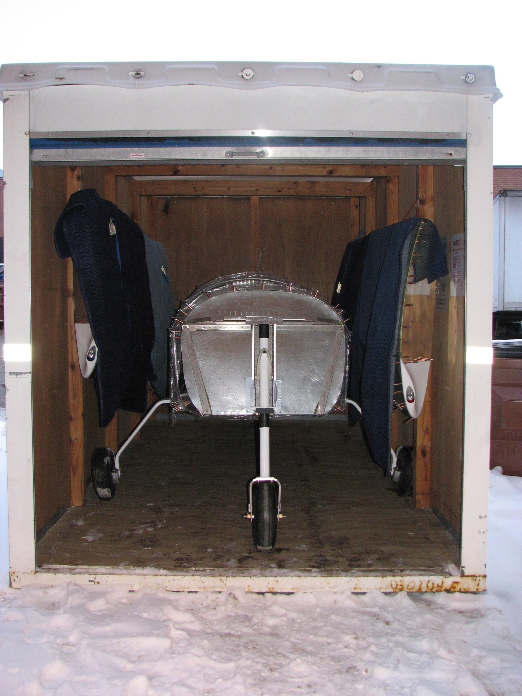

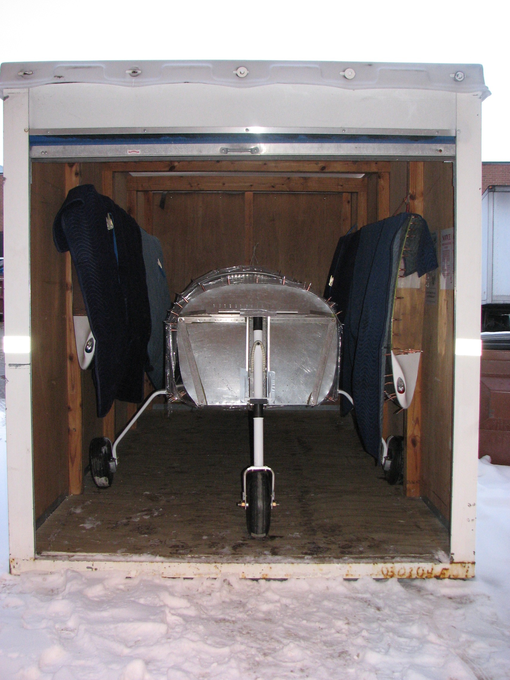

Here is a handy tip.  If you have to move/store a 601xl they fit perfectly into a 16ft POD storage unit. I hung my wings on the sides via the cargo straps I used to pull the wing skin down. I tied the tail up in with the eyelet in the unit at the rear and blocked the wheels to the floor. I also used a cargo strap to pull the main wheel down to the floor at the front. There was 2" to spare between the wheel and the door on the unit.
Cheers!
