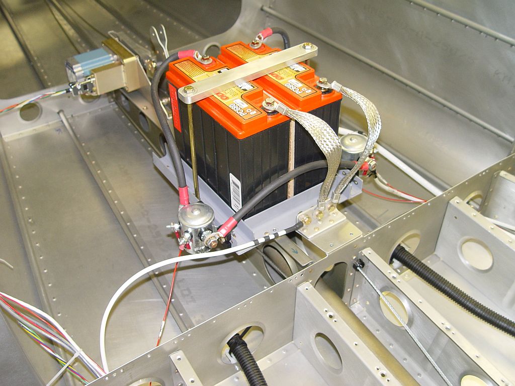

Matt, Bob has an excellent article on his site with a pic:
http://www.aeroelectric.com/articles/Battery_Grounds/Battery_Grounds.html
I'm attaching 2 pics of my interpretation. You'll notice I added the
ground wire for the forest of tabs in one pic.
Thank You.
Bill

I pretty much stole Bill's setup (previous note) but used a ground bus instead for the ground connection. These are available from B&C and it has enough room for 2 large (5/16 I think) bolted connections plus about a dozen or so soldered fast-on tabs. This gives you the option of grounding some components in the aft end of the aircraft without grounding them locally on the fuselage or having to run ground wires forward.
