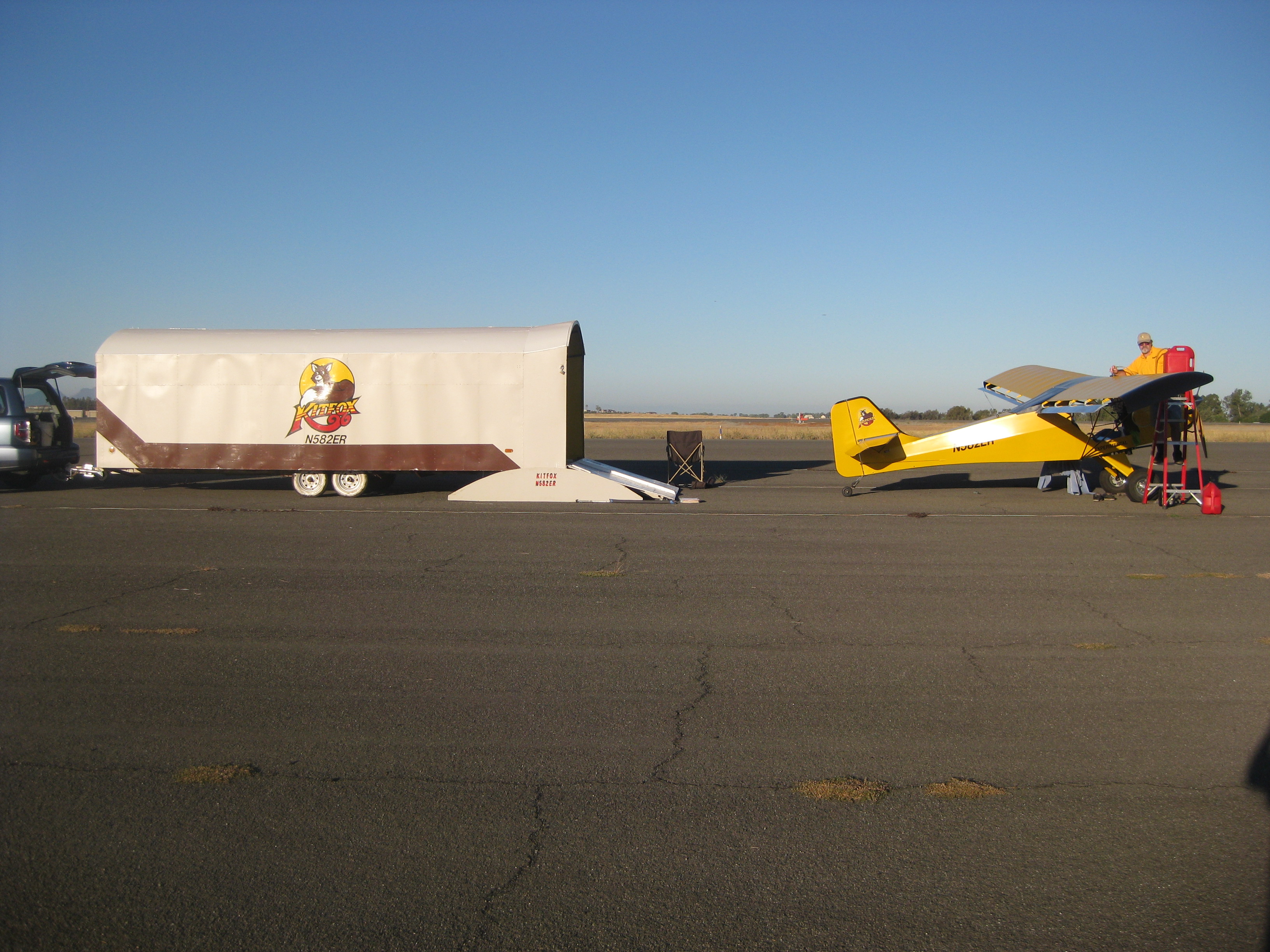

This is what I had to build to store the kitfox because I could not get a hanger, this cost me $1100, made from a old boat trailer, EMT and sheet metal. Just have to drain fuel, fold wings and tie down , tows great , stays dry. Hand painted the logo ( I did ask the John if I could ) It's 8' 6" by 23' wings are tight but when tied down Will not hit the sides . I have towed it long and short distances, works for me
