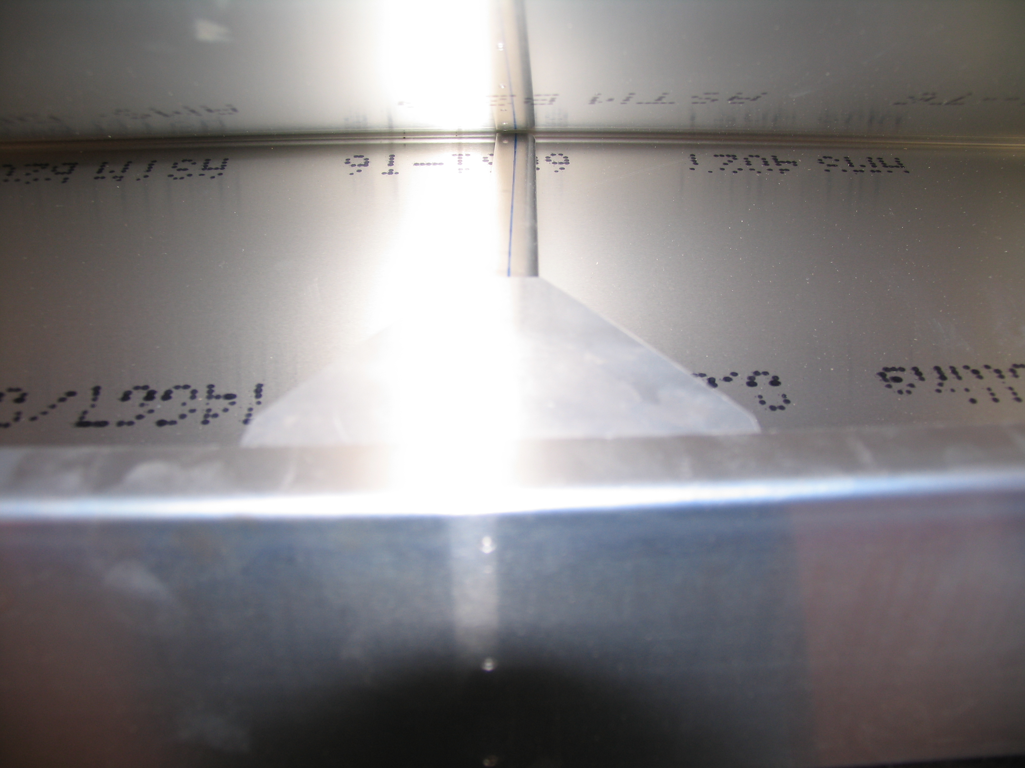

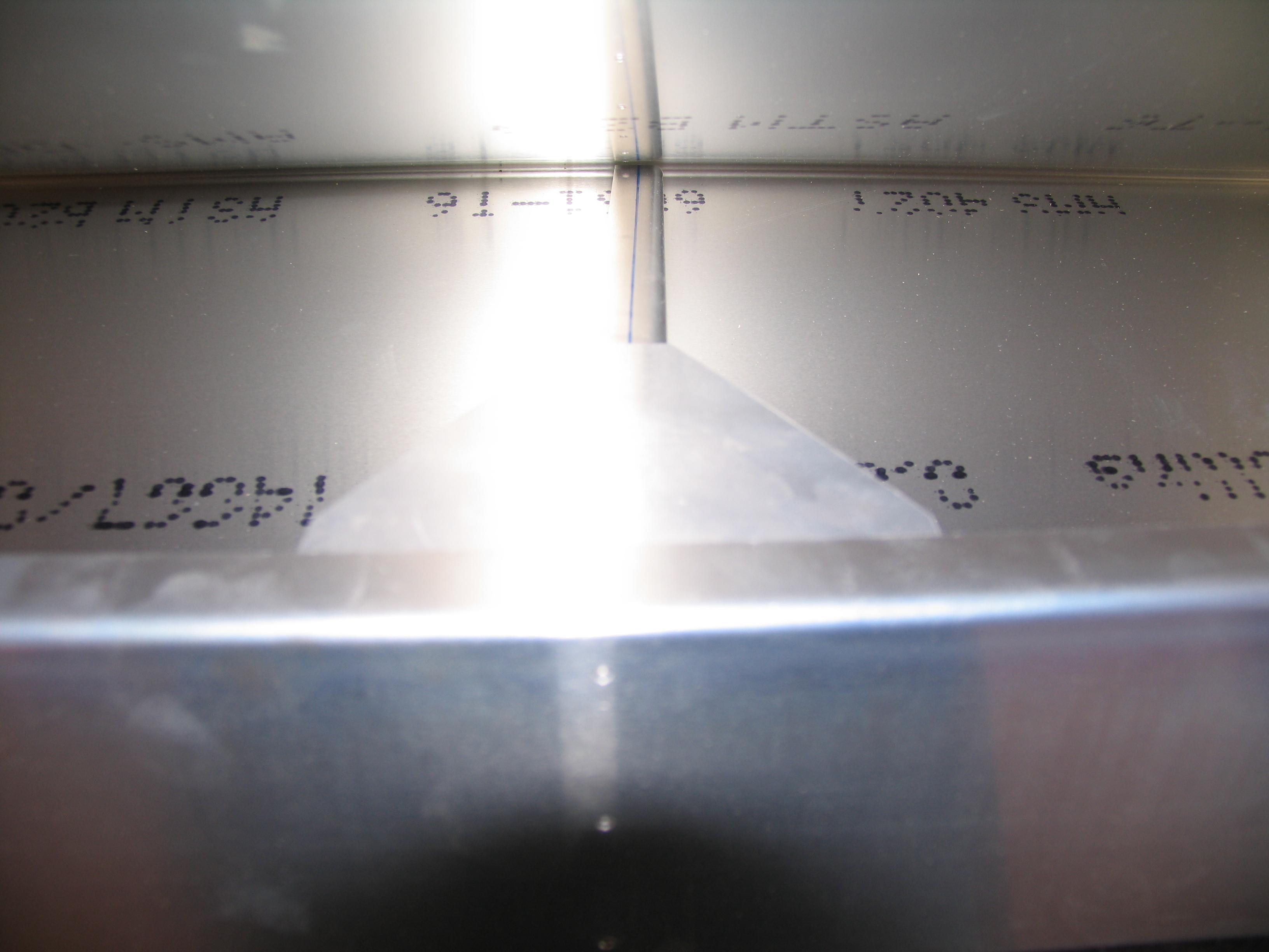

PostPosted: Thu Jan 01, 2009 8:18 am    Post subject: Re: Aileron Rib Gusset Questions Reply with quote
here's some gusset pics for reference, note that the inboard triangle gusset's long edge is oriented along the top of the inboard rib flange.

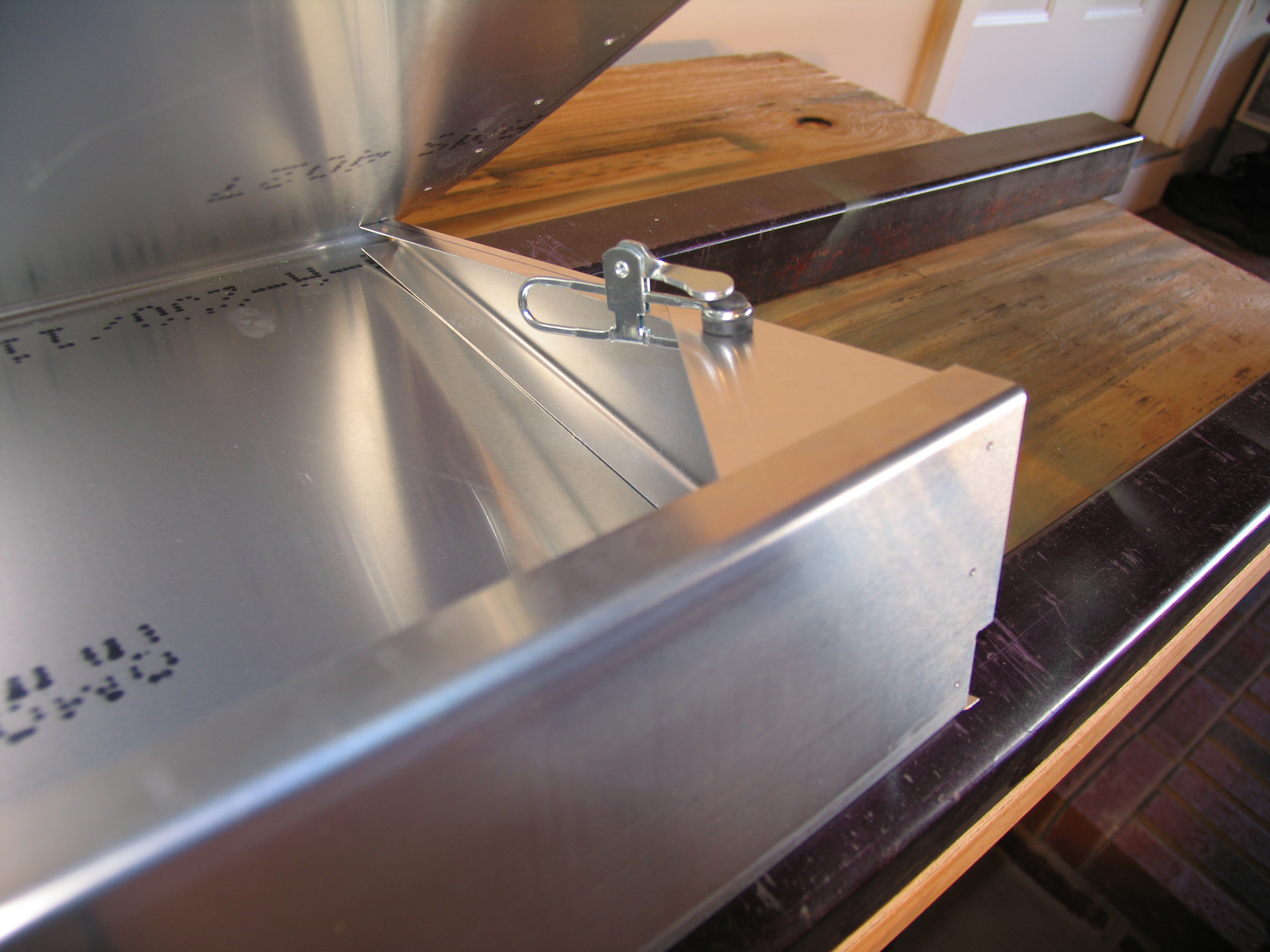

PostPosted: Thu Jan 01, 2009 1:39 pm    Post subject: Aileron Rib Gusset Questions Reply with quote
All;
the control locks in the picture are mine, and they work well. As for the Gussett, just put them under the hingless sheet metal on all of the aileron rib points, should be fine. You really dont need them if the plane is kept well. I did not have issues with my aileron eccept it was hit last night by a 9mm bullet. go figure! right in the corner and went through the wing entirely. I spoke to the Airport guys and they said mine was not the only one and last year on new years, a cheetah was shot while landing. Welcome to the Jungle.
Juan

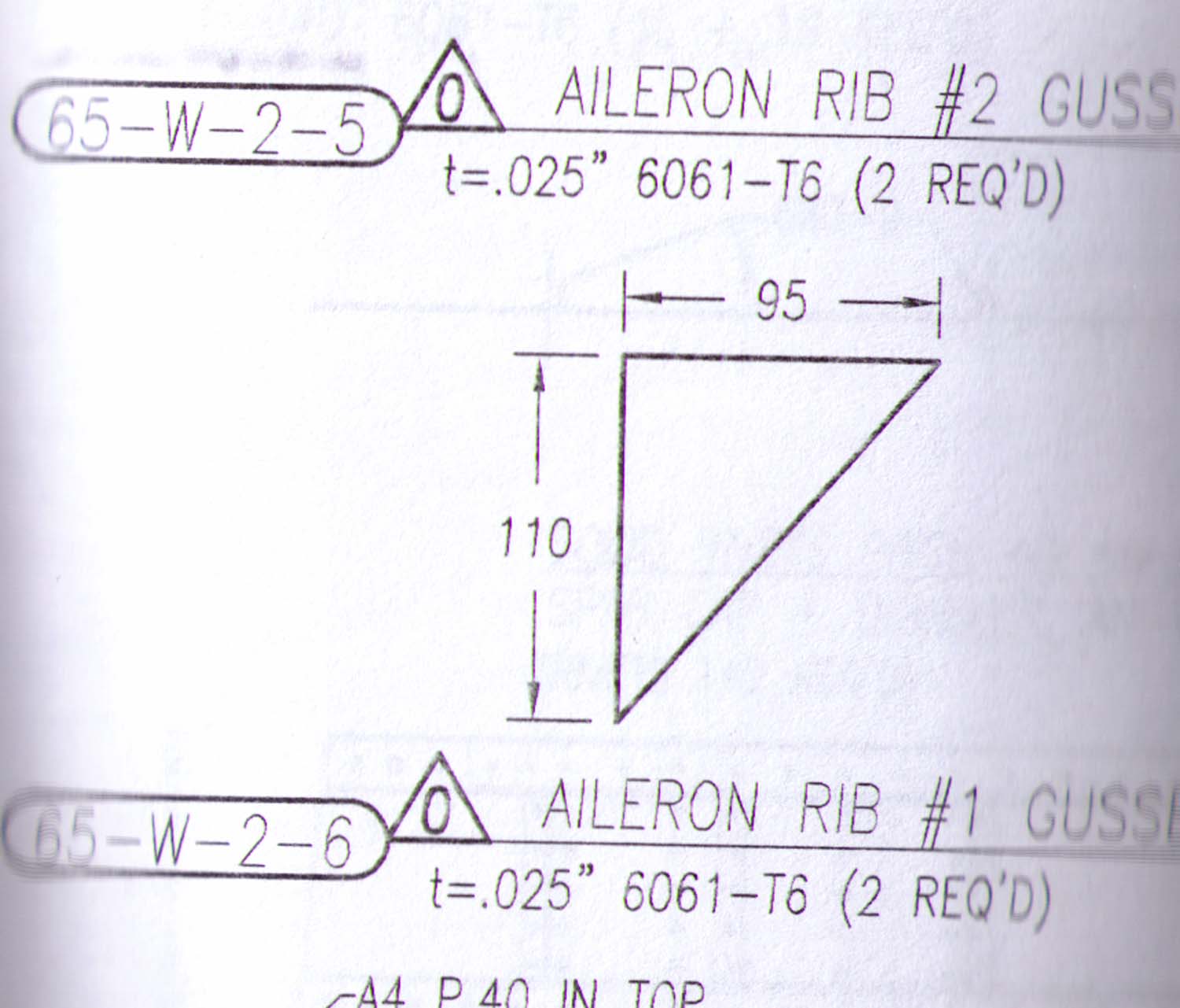

Anthony,
From your photos it looks like you have flex hinge ailerons not piano hinge ailerons,
is this true?

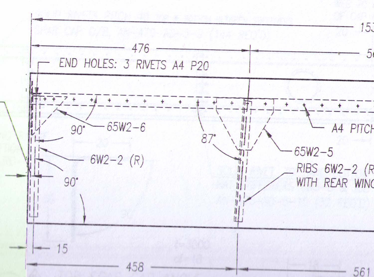

Attached is the Zenith drawing for the installation of the gussets. Does it match
your drawings?
I would contact Zenith before installing the gussets on a flex hinge. It was the
piano hinge aileron design that was having the problems talked about in the
paragraph above the drawings but the drawing shows a flex hinge installation.
This could be a defensive move by Zenith. They can always point to the bulletin
and say "See the drawing" this is what we recommended to be installed on all
601XL, and the service bulletin shows flex hinged ailerons. I don't know.

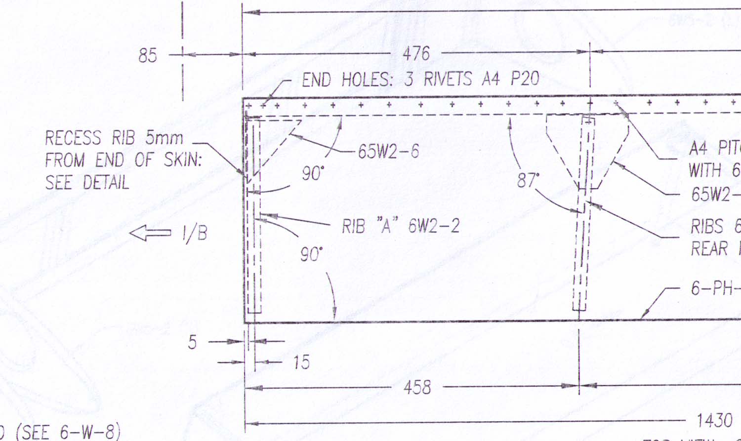

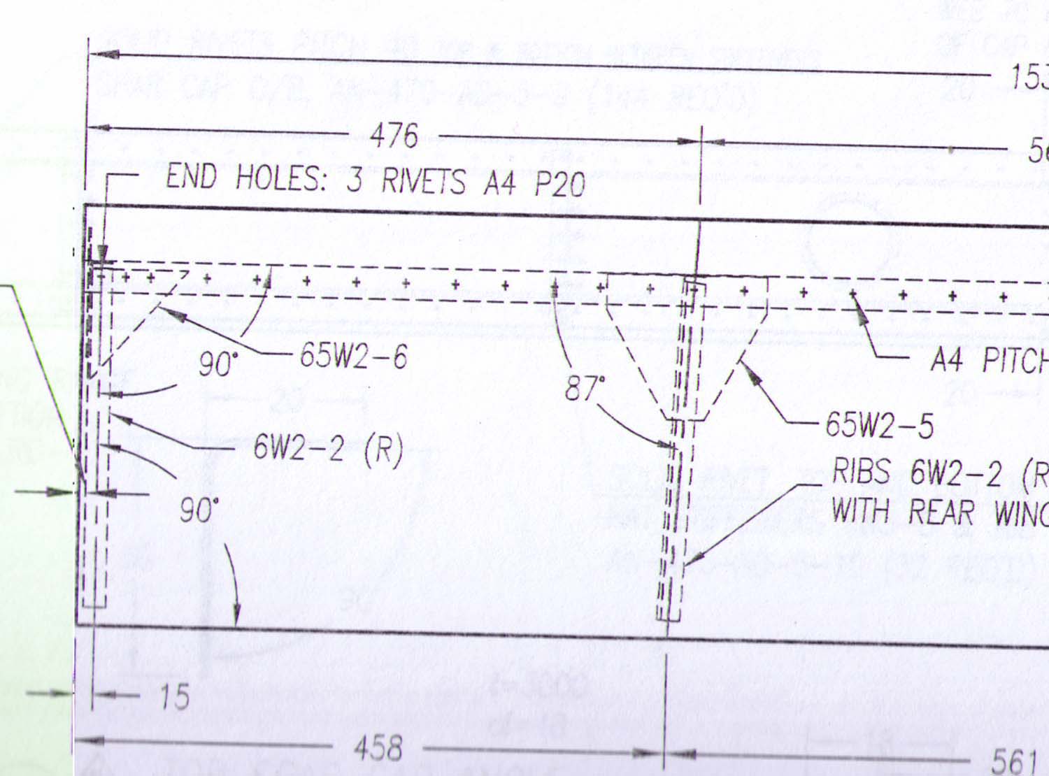

The 650 plans are more-or-less like the 601 plans. The drawings show
the hingeless version, with the hinged in the back on an "options" page.
Gussets are shown on both pages. The hingeless are attached to the
rear spar with A5/pitch 40 with A5/pitch 20 at the inboard end.
I'd have to scan the drawings to post an image. Since Jon is going to
include them in the news letter, hopefully folks can wait.
My ailerons have have been build for months. I don't think I'll be
drilling out the rivets to add the gussets. Also, someone mentioned a
concern about the thickness of the gusset offsetting the skin (true
enough) but this is not addressed in the drawings, so presumably it's
not considered a problem.
Ron

PostPosted: Sun Jan 04, 2009 3:25 pm    Post subject: Aileron Rib Gusset Questions Reply with quote
On Jan 2, 2009, at 9:43 PM, Sabrina wrote:
Ron,
Zenith has not issued a bulletin showing the PH aileron gussets,
just the flex hinge, so there is nothing more for Jon to post at
this time. If you have time, please scan the particular PH drawing
with the gussets attached, no need for all the other drawings on the
plans page.
Do you have PH or flex hinge ailerons?
http://forums.matronics.com/viewtopic.php?p 22480#222480
