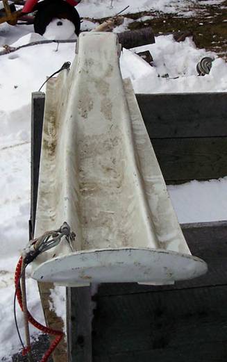

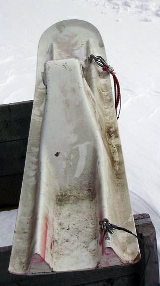

Lynn all this talk of photography is like getting a kick in the duff.  So aI went out ant ook a few "snaps" of my skis The very first one has a perspective that makes the axel look tilted C its not.  Thge reverse inserts may give you a few ideas.
Picture 1.  These skis are no doubt foam cored as they are quite stiff and weigh a lot less than the wheel and tire they replace.

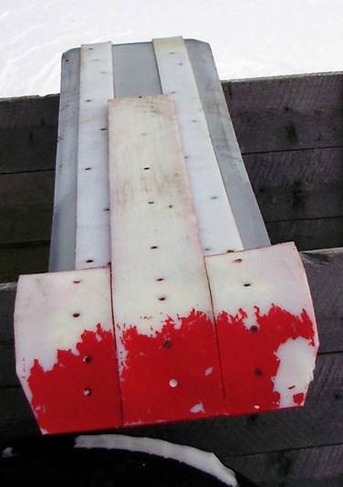

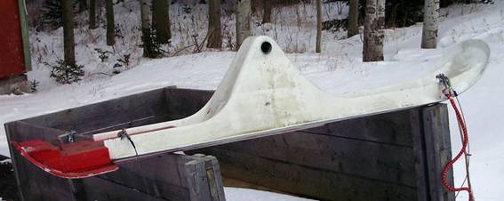

Picture 2. This is the picture I mentioned with the perspective shift on the axel.

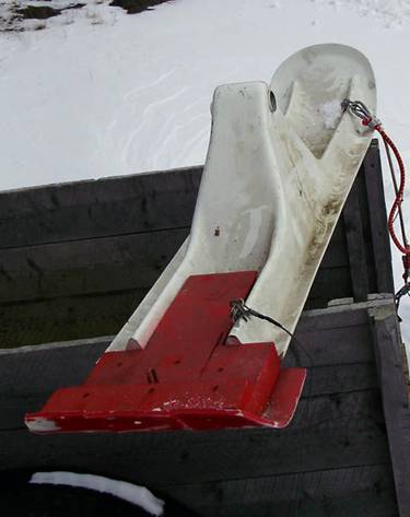

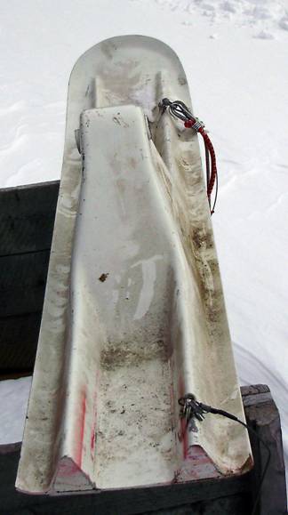

Picture 3. This angle shows the axel is straight and it also shows the two thin Teflon plastic runners on the bottom of the ski.  Notice no whear bars as the skis are not to be used on bare pavement.

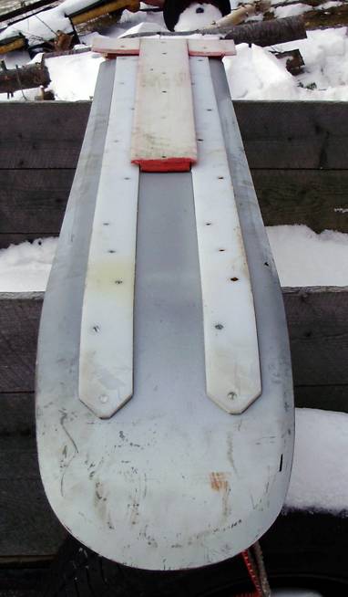

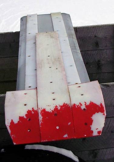

Picture 4.Ski right side up reversing insert upside down.

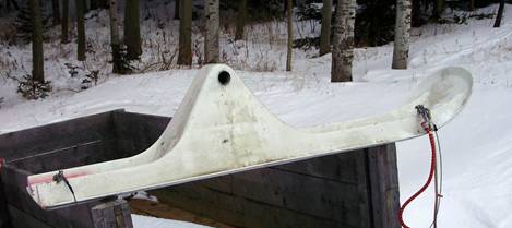

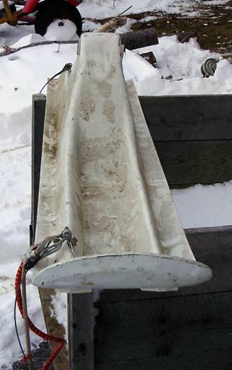

Picture 5.Reversing insert in place on ski.  Insert is held in p[lace by a cmall bungee that goes through the I screw and around the axel. ( retainer is not in palce.)

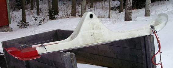

Picture 6.
Rear view of the ski with the reversing insert in place

Sorry, I didn’t build them but I expect they were vacuum bagged around a couple of foam cores. They are way too light to be layed up with wet cloth and way too stiff to be HDPE. Each ski only weighs about ten lb. if that... My cat may be heavier. The thing I was trying to show Lynn was the reverse tips the last owner made to tow the plane up to a bog he used as an airfield and the slight tip up along the full sides of the skis. The side tip up makes it a lot harder for the ski to trip while taxiing.
