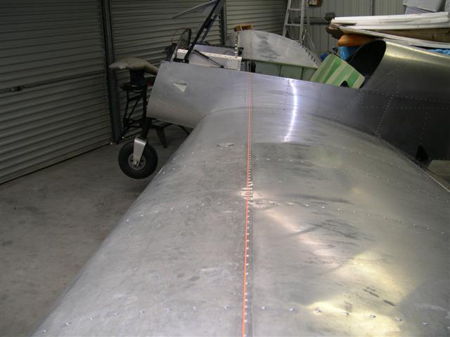

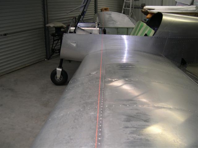

paulrod36(at)msn.com
PostPosted: Wed Dec 24, 2008 12:45 pm    Post subject: 601 problems Reply with quote
<?xml:namespace prefix="v" /><?xml:namespace prefix="o" /><![endif]--> You're not the only one..I've been putting the wings in place as a rough draft to figure out where the holes for cables, fuel lines and wires go, and once I get the temporary pins in, I see forward sweep. Not a whole lot, but it's there, and it's driving me nuts. With what we know about the spars and carry-through all being individually mated during manufacture, my original skepticism about sweep has turned to wonderment and consternation. If I pivot the wings back to the neutral position, I'm putting a load on the spar-to-carry-through joint, where ideally there shouldn't be any. Anybody got any ideas on this?

PostPosted: Wed Dec 24, 2008 1:50 pm    Post subject: 601 problems Reply with quote
Paul
Doesn’t wing sweep depend on the angle of the front spar? If you make the front spar vertical (by lifting the front wheel) then the sweep magically “disappears”!! – see pics
ge
From: owner-zenith601-list-server(at)matronics.com [mailto:owner-zenith601-list-server(at)matronics.com] On Behalf Of paulrod36(at)msn.com
Sent: 25 December, 2008 7:45 AM
Subject: Re: Re: 601 problems
Paul Rodriguez
 Filesize:  39.63 KB

bryanmmartin
Posts: 1018
PostPosted: Wed Dec 24, 2008 3:57 pm    Post subject: 601 problems Reply with quote
The forward sweep is an artifact of the 3 degree forward tilt of the
spar and the wing dihedral. If you raise the nose until the spar is
vertical you will see no forward sweep. During final assembly, the
entire spar web should be on the same plane with no bend in it.
On Dec 24, 2008, at 3:45 PM, <paulrod36(at)msn.com> <paulrod36(at)msn.com>
ideas on this?
Bryan Martin
N61BM, CH 601 XL,
RAM Subaru, Stratus redrive.
do not archive.
Bryan Martin
do not archive.
