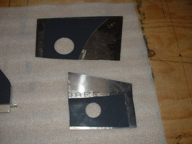

2. Before laminating the panel I experimented using extra laminate glued to .020 scrap stock. In my "Cuts"
attachment, the top sample used an HF fly cutter, the bottom a hole saw. Both were machined from the top and cut
clean with no tearing or fractures.

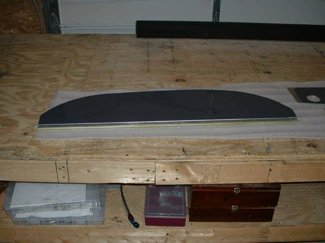

4. I originally thought I would have to screw the panel/laminate sandwich down to my bench in order to get a good,
flat bond but it's not necessary with the ACS adhesive. I sprayed both the panel and the laminate, counted to 60 and
put them together. You have minimal but acceptable working time. After lining up and putting the pieces together
I rolled them out with an edging flooring roller. That's it!
The laminate adds enough strength to enable you to fearlessly drill your instrument holes and won't scratch like
paint. Added weight is negligible.

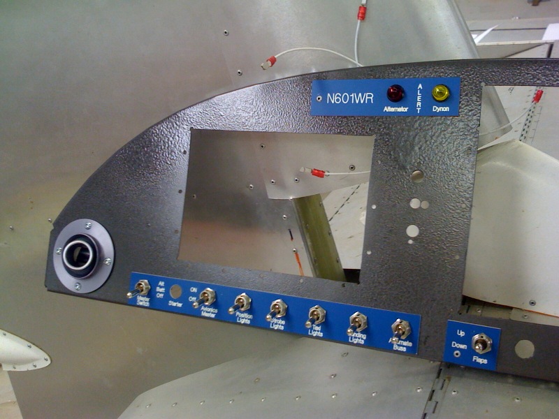

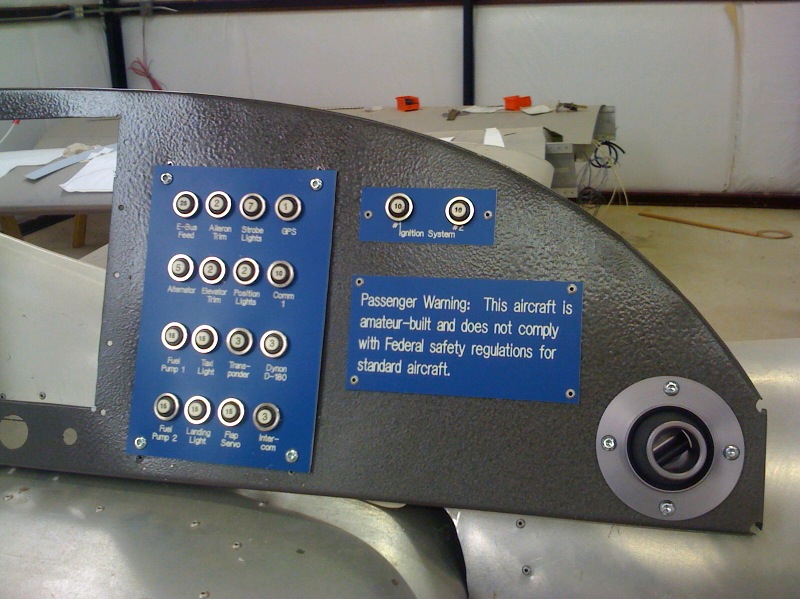

Since we are showing panel stuff here are some photos of what I did the last two weekends.
The panel is painted with RustOleum "Hammered" finish paint.
The circuit breaker panel will come out with 4 screws for service.
The eyeball vents are the ~$56 ones from ACS. One reason they are cheaper than all those $100+ versions is that you have to supply the collar for the air hose to attache to.
