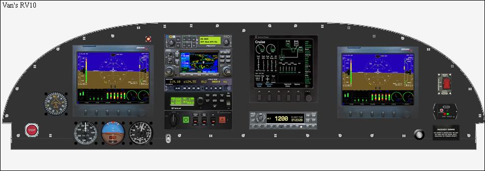

I am in the final planning stage of my panel and in order to make a precise CAD drawing I'd like to know what the minimum distance for the AFS-3500 from the glare shield and the side should be.
Based on the feedback I received I did some changes to the panel. See attached file.

At a minimum, you'll need to observe the 3/4" x 3/4" angle that attaches the panel to the glare shield (or notch it if you find yourself near a curve enabling slot). I don't think that the 3500 is deep enough that you need to worry about the glareshield converging in to the box.

I have a 4500 on the left side and a 3500 on the right side. If you can handle a Corel Draw file, I can send mine to you. I used it to design and then cut the panel.
Just looking at your jpg file, I would say that the right side needs to be moved down about an inch. The main reason is how much you need to chop the rib above. If you are going for a 4500 on the left, then I think you need to move your 3 back up round instruments and move the 4500 down similar to the right side. I did have to cut an extra 1/4" from the rib for the 4500 as the top of the case appears to sit a little higher.
