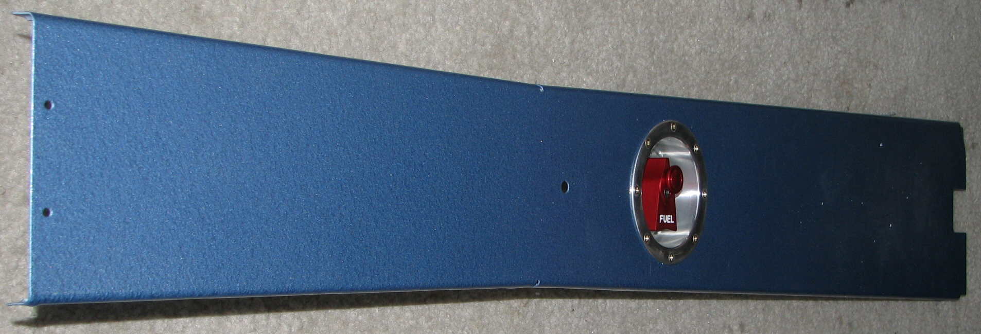

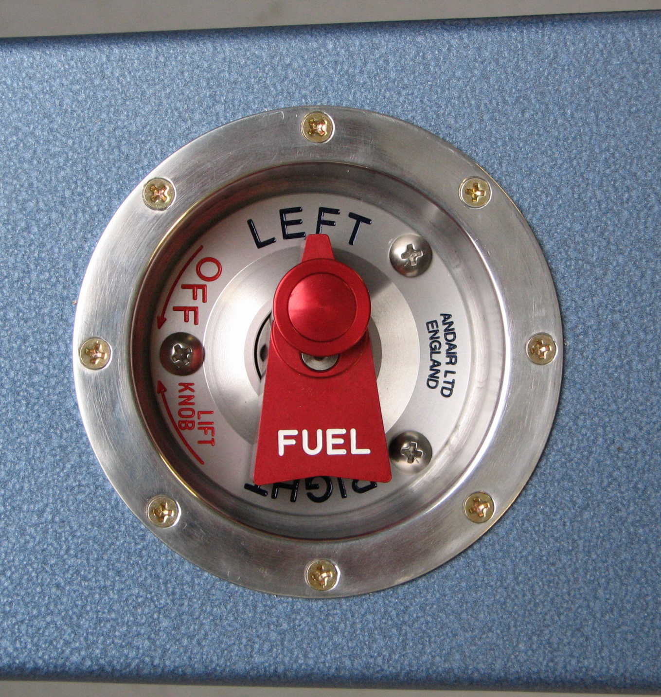

Here's what I did... and we made enough pieces to weld up 10. I finished the install, and it looks great. Routing of the scat was easy. Used Van's bridge to support a connector. Will take pics tomorrow.

Also, where I mounted mine was 5" forward of the Van's valve location. Moving it forward not only got it further out of the way, but the tunnel is wider and the valve fits perfectly in the center... of course, being recessed also created more room.

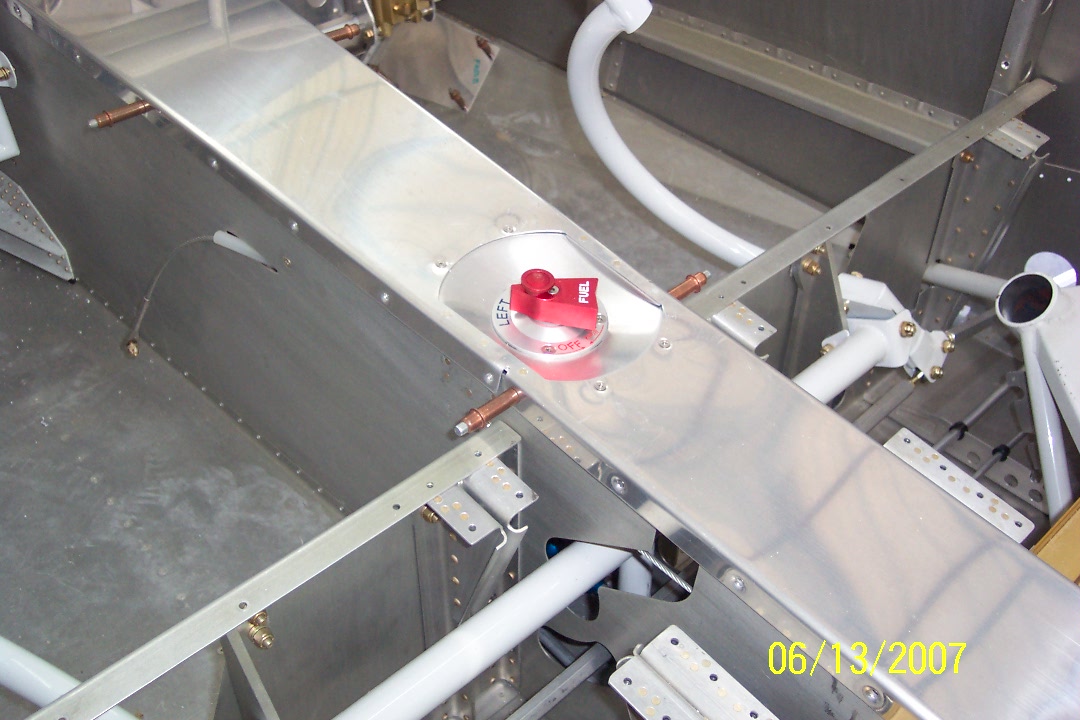

  That application looks really nice! If you have any more of those metal cups you can use them to hold your beer.
  We cut up an Cleveland wheel disk that was hanging around and mounted the valve in the center of the cup.
Robin

PostPosted: Mon Dec 08, 2008 8:55 pm    Post subject: Andair Valve Installation Reply with quote
Don't need em' for that... I bought some of those A&W cup holders..... you know... ya just roll down the window and hang em'.

PostPosted: Mon Dec 08, 2008 9:11 pm    Post subject: Andair Valve Installation Reply with quote
you might consider segmenting the tunnel cover; it makes it very easy to inspect beneath without a lot of disassembly

PostPosted: Mon Dec 08, 2008 9:45 pm    Post subject: Andair Valve Installation Reply with quote
We have since that photo was taken.
