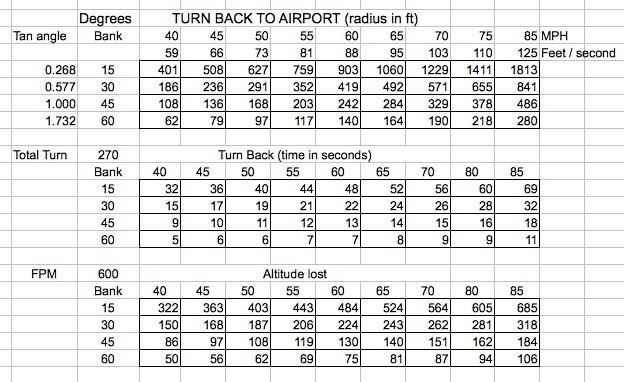

Kolbers,
The time to turn an airplane depends primarily on the bank angle of the turn and the airspeed being flown. It is a mathematical relationship that is a function of the tangent of the angle of bank. Attached is an image of a spreadsheet table I put together to show this relationship at various airspeeds and bank angles. The first table shows the turn radius (not diameter) in feet for a given bank angle and airspeed.
The second table uses this data to derive the time in seconds to make a turn of 270 degrees. I used 270 degrees because to get back to the runway you have to turn 180 to get the right heading but then you are two radii away from the runway so then you have to keep turning, say another 45 degrees then turn back 45 degrees to get re-aligned with the runway, for a total of 270 degrees of turning.
The third table takes the second tables data and ASSUMING a 600 FPM descent rate, calculates the loss of altitude in the 270 degree turn.
NOTE: This is not a recommendation for or against turning back to the runway at any time. It is simply showing the mathematical relationship amongst bank angle, true airspeed, time to turn and altitude lost in doing so.
270 degree turn data
 Filesize:  117.66 KB
 Viewed:  798 Time(s)

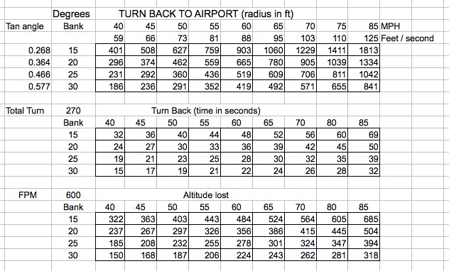

I did not use very steep bank angles in the previous table posted so I am posting another with steeper bank angles, for your amusement and perhaps amazement.
Steeper bank turn back data
 Filesize:  113.66 KB
 Viewed:  815 Time(s)

PostPosted: Tue Dec 09, 2008 6:25 am    Post subject: What is your Altitude loss in a 180 degree turn? Reply with quote
amazement.
Thom Riddle

Thom Riddle
Posts: 1597
PostPosted: Tue Dec 09, 2008 6:43 am    Post subject: Re: What is your Altitude loss in a 180 degree turn? Reply with quote
John H,
The first two tables are mathematical relationships that are independent of the airplane being flown. This means that the turn radius and time to turn are the same for any airplane at these bank angle and airspeed combinations. Ever notice how big a radius it takes to turn a jet fighter flying at high speed? It takes many miles to turn around at high speed, even in a near 90 degree bank angle. Ever wonder why gyroplanes (and helicopters for that mater) can turn on a dime? Because of their very low speed capability. At higher speeds they cannot turn so quickly or in such short distances. It is pure math.
The third table, ASSUMES a 600 FPM descent rate. This table depends upon that assumption. If your airplane descends at a different rate then the altitude loss numbers will differ linearly. In other words if your airplane descends at say 450 FPM then the altitude loss will be 3/4 of those in the table shown for a 600 FPM descent rate.
