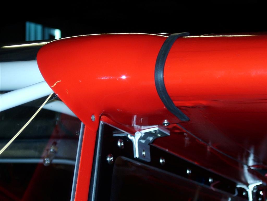

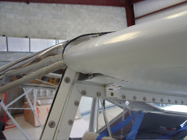

Has anyone had a problem with the wing root/windshield interface matching up?
My LP windshield does not neatly match up with the wing. The airfoil bend in the acrylic is about an inch over the leading edge. From about the 4 inches back then to the aft end, and at the cowling, it fits nicely. I trimmed it to the max, but to move the windshield any more aft and down would have caused the cowling and glare-shield interface to not have matched.  Anyway, it's already installed and there is no way to move it at this point. Kind of a no win deal here.
I talked with LP, (kudos to them - an excellent company.) They were very sympathetic and tried to offer suggestions, but they said heating and reforming, while possible, is not a viable option due to the risk of deformation. They suggested cutting back the corner of and making mods to the fairing cuff. I agree, but since it's a compound curve I don't think aluminum will work. Fiberglass may be a good alternative.
Has anyone tried this or had this type of issue? LP and I both agree it's probably due to being serial number 1. It is likely different than other, later, Series V's. The windshield is only 4 years old so it was made to fit later models, possibly with the smooth cowl as opposed to my bump cowl.
Once this is issue is resolved, the airplane is ready for its first flight. After 14+ years, I think it's time. (The airworthiness certificate was issued last week.)

Rick, I have the same problem, but my windshield extends more forward. I think my kit was the 128th series 5. Right now I have red duct tape covering the gap. It works! I have played with the aluminum cuffs, but I too see Fiberglas as the only answer. I just haven't got around to it yet.

We used fiber glass for the windshield fairing cuffs on N24ZM. Just cover the area with packing tape and lay up 3-4 layers of medium weight cloth over the area. It will take you an afternoon at most. One of these days I need to get up there and check out your project. Spruce Creek is a short (very short) flight in the Rocket:)

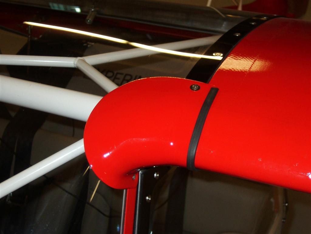

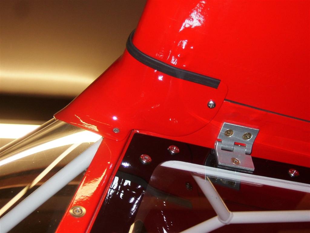

I just completed my fairings (fiberglass) and they are much better than the metal fairings. I used the brown packaging tape (comes off very easily and doesn't leave the adhesive behind) and oil-based modeling clay to get a good form. the glass is simply layed up over the tape and clay. Once it is cured, it can be removed easily using a rubber scraper under the corners. The clay will somewhat adhere to the epoxy but you can scrape most off using a spoon or butter knife and then clean the rest off with mineral spirits or wax remover. The exterior will need a few light coats of filler (unless you are a professional clay sculptor) to smooth it out and fill any pinholes...then a coat or two of primer, wet sand, and topcoat. I also used some thin rubber U-channel from Aircraftspruce and 1/16" neoprene tape to seal the edges. I will get some pics if I remember next time I am at the hanger.
Darin,
I am not clear on how you laid up the fiberglass, did you put it directly into the clay, or over the top ( Female or Male mold ? ) Since you formed fiberglass directly over the clay, what was the brown tape for ??? Did you form the clay over the windshield to get the mold shape ?
Mike
This would have been a male mold process. The Brown tape was simply to protect the window and provide a "release" mechanism for the fiberglass after it cured. The clay was used only in the "hole" created when the windshield was trimmed. I sculpted the clay to provide a smooth transition from windshield to wing as simply laying tape over the hole and glassing over it would have resulted in a less than pleasing shape to the fairing.

PostPosted: Wed Nov 19, 2008 10:16 am    Post subject: Re: Windshield fit Reply with quote
Rick,
Here are some pics of my fairings. If you take your time, they will turn out great.

MDKitfox(at)aol.com
PostPosted: Wed Nov 19, 2008 11:22 am    Post subject: Windshield fit Reply with quote
Darin,
I looked at the photos and honestly, you did an outstanding job! The listers ought to take a look at these photos. I'm encouraged. If mine turn out half as good I'd be pleased.

PostPosted: Wed Nov 19, 2008 11:40 am    Post subject: Re: Windshield fit Reply with quote
Rick,
Thanks for the compliments...I am pretty please with how the turned out. I had put this part off for a couple months and went the tape route but with the temps dropping (and an incident where a peice of tape came loose and gave me quite a scare) I decided that now was as good as any to make the fairings. Fiberglass is a great medium to work with...just make sure you protect the area you are working and make sure you have a good release agent (brown packaging tape in this instance). Clean up any epoxy drips before it cures also. Have fun.
