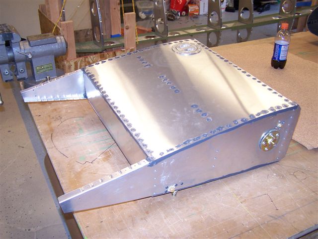

PostPosted: Fri Nov 14, 2008 2:07 pm    Post subject: HDPE fuel tanks Reply with quote
Attached is a picture of one of the two tanks I made. I'm scratch building
and made form blocks a little shorter than the wing form blocks. I put a
baffle in the middle to keep the full tank from bulging. I was going to
make the tank deeper but decided I didn't want to mess with the CG. The cap
is an ACS flush mount model. There is an aluminum block in the corner where
the fuel outlet is and the drain plug is also in that area. The vent line
will run up from the bottom in the corner where the cap is (I riveted a 1/4"
aluminum plate and threaded in for an 1/8" NPT fitting). The fuel sender is
the normal one and I got it from an off-road-vehicle supply house. I made a
new ring with threaded holes for the sender to bolt onto and Pro-Sealed it
to the inside of the tank; this was so I could have a larger area for the
sender gasket to seal. There is also a fitting next to the sender for the
fuel return if I go that route (hot fuel system?). Used "closed end"
rivets. I pressure tested it for several days using the balloon method.
The tank is completely enclosed in the wing (not a wet tank system). I put
cork strips between the tank and the skin. I just finished riveting the
wings yesterday (anyone have a cure for hand cramping?).
BTW, I found out that you can clean up Proseal with lacquer thinner.
Curt

I really like that tank, what are closed ended rivets? I assume they are not solid rivets, because you would not be able to set the second side. I also assume that you used pro-seal on the joints?

PostPosted: Fri Nov 14, 2008 4:12 pm    Post subject: HDPE fuel tanks Reply with quote
Greetings,
Has anyone considered making the tanks out of stainless steel or some
other material besides aluminum? I have seen corrosion problems in boats
with aluminum fuel tanks that make me seriously search for alternatives.
Raymond Julian

PostPosted: Fri Nov 14, 2008 6:17 pm    Post subject: HDPE fuel tanks Reply with quote
I got the Closed End Blind Rivets from here:
http://www.hansonrivet.com/w22.htm
The part number is: PASD401H ($58.54 / 1000)
I also got some PASD403H ($13.22 / 100) to attach the flanges.
I think ACS sells something like this too.
Curt

PostPosted: Sat Nov 15, 2008 9:01 pm    Post subject: HDPE fuel tanks Reply with quote
Hey Curt
Nice tank... good job, I'm scratch building mine also. My tanks will look
just like yours... except for the stub ends. Its nice to see what mine
will look like when I'm done. I'm using 5052 H32 aluminum 0.032 for
tanks... and will also have a baffle. Both tanks will use one 4 x 6 sheet
which is only about $44 at ACS. Since I am making the tanks myself I
decided to make them with the same profile as the wing.
Van's Aircraft... is a good place to get the various flanges(for rivets)
and closed end rivets needed at really good prices. I acquired the
drain(cav-110) flange - VA-112($7.80) with the rivet holes already drilled,
and the closed end rivets AD-41H(1/16" grip) and AD-42H(1/8" grip)
$0.06/per. ACS have the same rivets for $0.18/per... which is nuts. Van's
flanges are already drilled for rivets so it makes it easier to work with,
and are the only place where I could find them. That also goes for the
finger screen flange. I used AN(-4) bulkhead fittings for the vent lines
and return lines.
I was looking at the same ACS flush mounted caps... but not sure how they
can be installed as of yet, have not had time to think about it.
The fuel sender I have is the standard VDO... they wanted $20 for the
install ring and screws... so I made mine out of 1/8 aluminum, very easy to
do.
Again nice tank! If you more photos it would be nice to see the rest of
the tank!
R.D.(Ron) Leclerc
CH701 Plans(Scrap) Builder #7-6699
infow(at)mts.net
11/15/2008 10:45:59 PM

Well I think I've been convinced to build a rivet tank. I was not aware of the blind rivets and I had doubts about the longevity of proseal. So I have decided to build a riveted tank. It allows me to construct it and I can still add a couple of gallons to the total.
I also contacted the guys who I was speaking about and got his permission to post his contact info. Again I have only traded emails buthe seems honest and straight up. Said he could help with the wind shield as well. Not sure if that means formed or what? Anyway, replace the (at) with an (at) and the email will work... "Keith Cardin"kcardin55(at)yahoo.com
Now I just have to build more flanging dies for the wing ribs, hope it doesn't take as long as it did the first time ;^)
Thanks again
