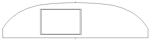

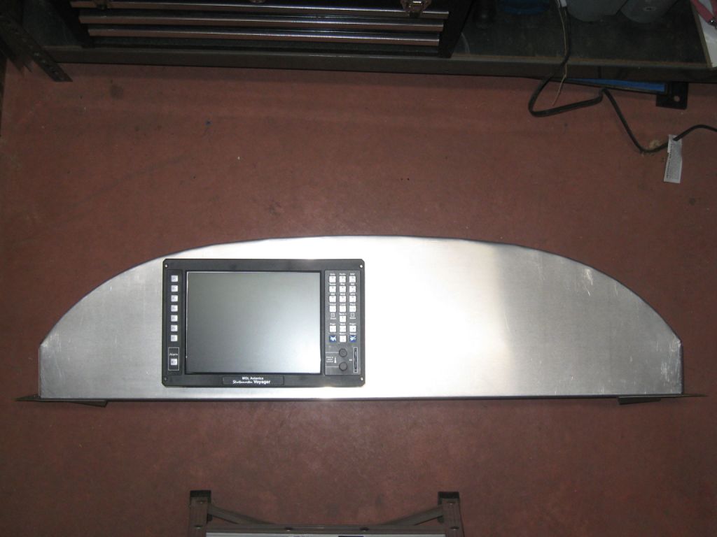

PostPosted: Sun Nov 09, 2008 11:19 pm    Post subject: MGL voyager glass panel. Reply with quote
I have 601XL and CH701 blank panels and a Voyager. I'll place the Voyager on
the panels and take some pictures. I have CAD outlines for the 601XL and
CH701 panels and the Voyager and there is at least one free CAD program on
the Web. I'll look at uploading some CAD files and some bit-map files that
you could play with in the Paint program provided with Windows.

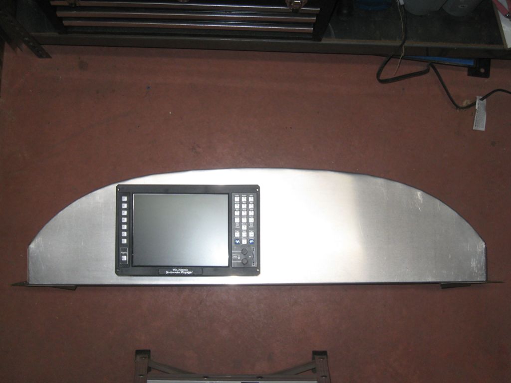

PostPosted: Mon Nov 10, 2008 8:14 am    Post subject: MGL voyager glass panel. Reply with quote
Here is my future panel......with a Voyager in it.

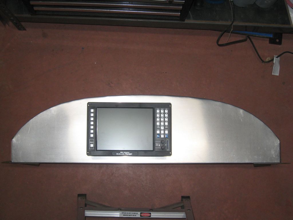

PostPosted: Mon Nov 10, 2008 9:25 pm    Post subject: MGL voyager glass panel. Reply with quote
Attached are two shots of an MGL Voyager EFIS sitting on a blank 601XL
panel. Here are Voyager's dimensions:
Overall panel size:
266mm width x 168mm height (10.47" x 6.62")
Panel cutout (zero clearance):
250mm width x 162mm height (9.84" x 6.38")
Depth behind flange: (excluding connectors)
70mm (2.76")
Bezel thickness :
4 mm (0.16")
Screen dimensions:
175mm (6.89") x 133mm (5.23") - 8.4" diagonal 4:3 format
-- Craig
 Filesize:  64.82 KB
 Viewed:  881 Time(s)
 Filesize:  67.47 KB
 Viewed:  860 Time(s)

PostPosted: Mon Nov 10, 2008 10:05 pm    Post subject: Re: MGL voyager glass panel. Reply with quote
Thanks a bunch , thats exactly what i was looking for.
Surprised how big it looks on the panel, and to think I was thinking of fitting 2 of those ha ha one for fis and the other for nav/engine.
Same some money now I think !
Kevin

Attached is a small bit-map file with the 601 panel and Voyager outlines.
This will give you a little more accurate feel for how they fit together.
-- Craig
