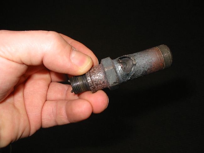

Russian spark plugs don't always 'blow-out' when they fail....
This is what happens when combustion gasses work up the inside of the ceramic core. The housing is steel.
Then when this happens to be a plug on a lower cylinder...at the front...the molten metal and burning gasses find their way right into the air box.

So, there it is, not always a big bang to let you know what has happened. Wink
Yak Plug Meltdown
