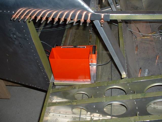

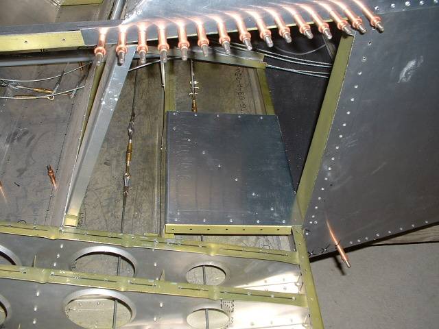

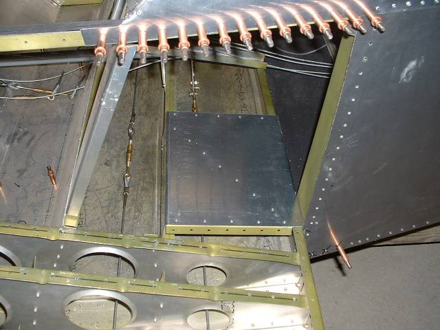

naumuk(at)alltel.net
PostPosted: Sun Nov 02, 2008 8:33 am    Post subject: D100 compass Reply with quote
Dred+All-
Unlike the XL, the HDS doesn't have a hatch near the tail. Everything's all buttoned up and I'm not going to tear the fuse top skins off or try crawling back to the tail.
One of the listers who has 200+ hours on his system installed his unit behind the passenger seat. The tray I built for the passenger side is occupied with the battery and ELT. At the same time I built the passenger side tray I built one for the pilot's side, originally intending to mount a tool box on it. I decided against it and tore it off, because the only thing gaining weight faster than I am is my project. Pictures attached for the guy from France who wanted to see some installations.
Luckily, I haven't visited the scrap yard recently so my pilot's side tray was still around. I just stuck it in position for the picture- I'll cut it down to fit the compass unit.
One question for all D-100 owners- how did you determine if the base unit and the compass are mounted within plus or minus 1 degree of each other? I assume this is in the roll axis.
      Bill
 Filesize:  46.21 KB
 Viewed:  718 Time(s)
 Filesize:  41.59 KB
 Viewed:  743 Time(s)
PostPosted: Sun Nov 02, 2008 8:34 am    Post subject: D100 compass Reply with quote
All-
Well, one nice thing about the HDS is you don't have to worry about a
flap motor!
Bill

PostPosted: Sun Nov 02, 2008 8:46 am    Post subject: D100 compass Reply with quote
“how did you determine if the base unit and the compass are mounted within plus or minus 1 degree of each other?”
Use a digital level.
-- Craig

PostPosted: Sun Nov 02, 2008 8:54 am    Post subject: Re: D100 compass Reply with quote
I did the same. Assuming that the plane is built to specs the panel and the Dynon box will be level when installed.
The mount I built for rear fuselage installation had to correct for the 3 degree tilt of that area.

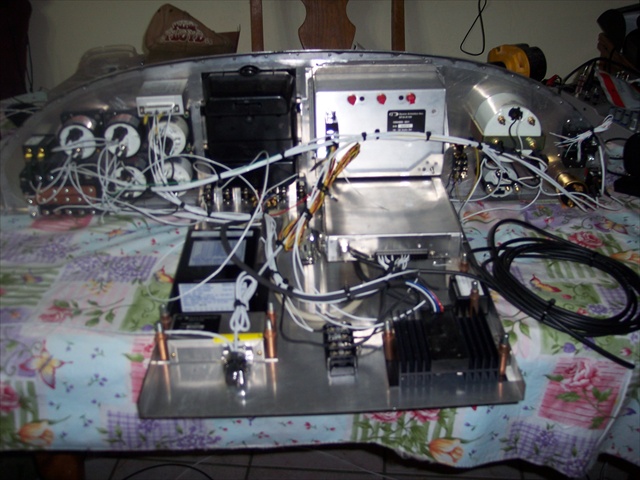

PostPosted: Wed Nov 05, 2008 8:58 am    Post subject: D100 compass Reply with quote
AOL Search: Your one stop for directions, recipes and all other Holiday needs. [url=http://pr.atwola.com/promoclk/100000075x1212792382x1200798498/aol?redir=http://searchblog.aol.com/2008/11/04/happy-holidays-from-aol-search/?ncid=emlcntussear00000001 ]Search Now[/url].
 Filesize:  122.14 KB
 Viewed:  759 Time(s)

Afterfxllc(at)aol.com wrote:
Was there supposed to be text with your photo? If so it didn't show up.
That said doesn't not mounting the remote compass remotely sort of negate the idea of having a remote compass. They provide that long wire for a reason.
W.R. "Gig" Giacona
601XL Under Construction
PostPosted: Wed Nov 05, 2008 10:32 am    Post subject: D100 compass Reply with quote
This is my 3rd panel built this way and they work perfect. Why route it in some far off location if you don't have to. But what do I know.
Jeff
Gig Giacona
Posts: 1416
PostPosted: Wed Nov 05, 2008 12:08 pm    Post subject: Re: D100 compass Reply with quote
That's great that it works for you but, quoting from the installation manual...
Keep the EDC-D10A away from any source of magnetic fields (such as electrical equipment and current-carrying wires) and ferrous material.
And if your intallation is anything like any other I've seen there are a metric buttload of "electrical equipment and current-carrying wires" where yours is mounted.
But what do they know, they just built it.
Jeff
[/quote]
W.R. "Gig" Giacona
