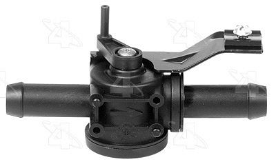

PostPosted: Sat Nov 01, 2008 9:06 am    Post subject: cabin heater Reply with quote
I think the shut off valve from Napa ($20?) is probably # 6601141 5/8" with the cable in-line to the hose. Kragen Auto # 74627 sells for around $15. You can see pictures on their Web sites.

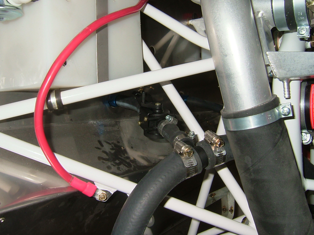

PostPosted: Sat Nov 01, 2008 11:38 am    Post subject: Re: cabin heater Reply with quote
I couldn't find the Napa part # on their website but the one listed on Partsamerica.com (#74627) is the exact valve I used. Here is a pic of it from their website and a pic installed in my bird. The supplied 1/2" coolant hose took a bit of coaxing to get over the 5/8" barbed ends of the valve but with a little lubricant they will go on.
