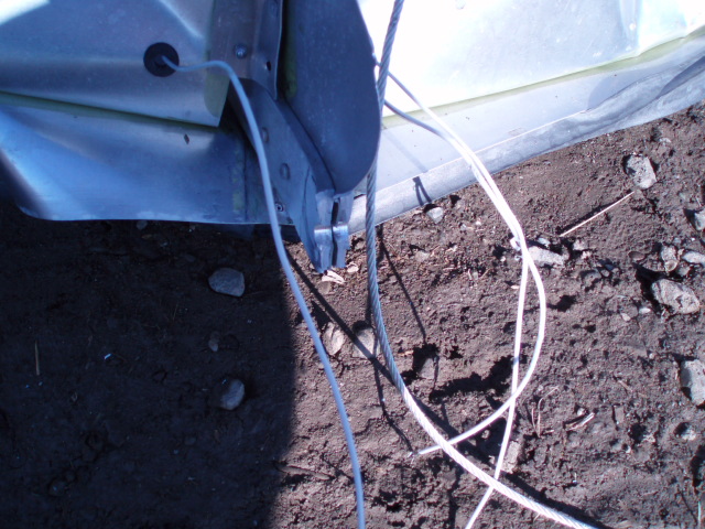

PostPosted: Mon Oct 27, 2008 5:15 am    Post subject: Re: XL wing fold in flight Reply with quote
Hello,
have a look on this page: http://www.geocities.com/mgd3/flying/flutter
The damage is like the same on the attached photo from a 601XL accident.
