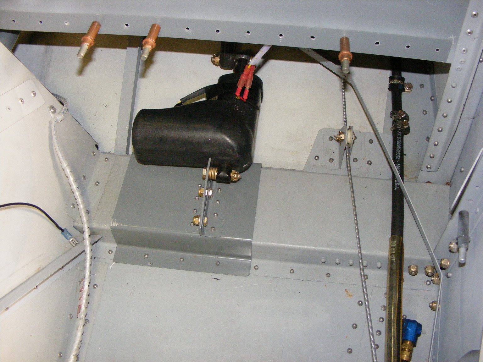

PostPosted: Mon Nov 01, 2010 11:01 am    Post subject: Re: flaps Reply with quote
Johnny. Here is a direct link to a Homebuilt help Site page with a photo of the Flap motor you want mounted on the 750. http://www.homebuilthelp.com/CH750/fuse750Part1.htm
However, you can see from this photo that the 750 has nothing like the welded Flaperon assembly in the 701. I am attaching a photo of my 701 (not flying yet) showing the motor (the seat bottom skin is removed), mounted under and behind the left seat. I mounted the base using the rivet pattern in the Landing gear channel. The entire structure exists merely for the hole. You put a bolt through it, then slip on the motor, then a nut. Done. You hook the other end to the same hole as you do for the manual system. The motors can be found at http://www.powerdrives.com/shop-online/results.aspx or Zenith I guess.
In my photo look closely there is a nut and bolt at each end of the motor. The motor is not “held down” in any way. It's just supported by the two bolts…..Geoff
