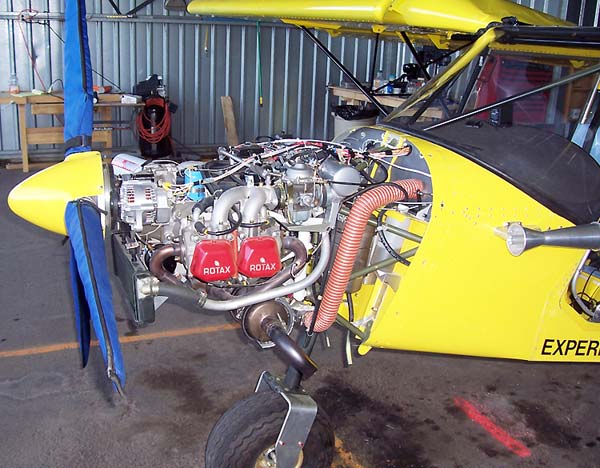

K Dilks
Joined: 22 Sep 2008 Posts: 108 Location: UK
Posted: Mon Oct 20, 2008 9:03 pm Post subject: Re: Rotax 914 turbo engine |
You have to use the ring mount as supplied as the turbo sits underneath, also this system gives very good anti vibration without the engine being overly soft mounted.
Any one seen one on a 601? Seen one on the 701 on the web site.
