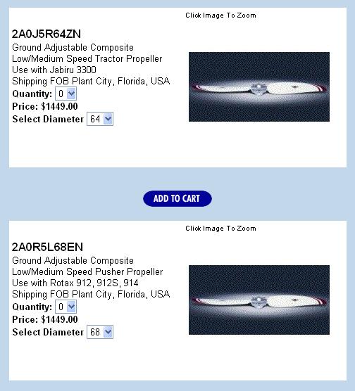

Looking at the bottom of the attached screen shot from the Sensenich web site 2A0R5L68EN looks like a prop for a Rotax in a pusher configuration. The prop I received is in my FWF kit from Jabiru USA is a 2A0J5R64ZN (the one at the top). Here is my guess at the encoding:
2A0J5R64ZN
2A0R5L68EN
The 2 is for two blades. R/J is Rotax vs. Jabiru. R/L is Right vs. Left turning. 64 or 68 is the diameter. Although I don’t have any direct evidence the fine “N” indicates the nickel leading edge protection.
-- Craig

You can also check the link below from the Sensenich web site.
http://www.sensenichprop.com/sen_html/carbon_faq-2.pdf
Joe R
2A0J5R64ZN
2A0R5L68EN
-- Craig
