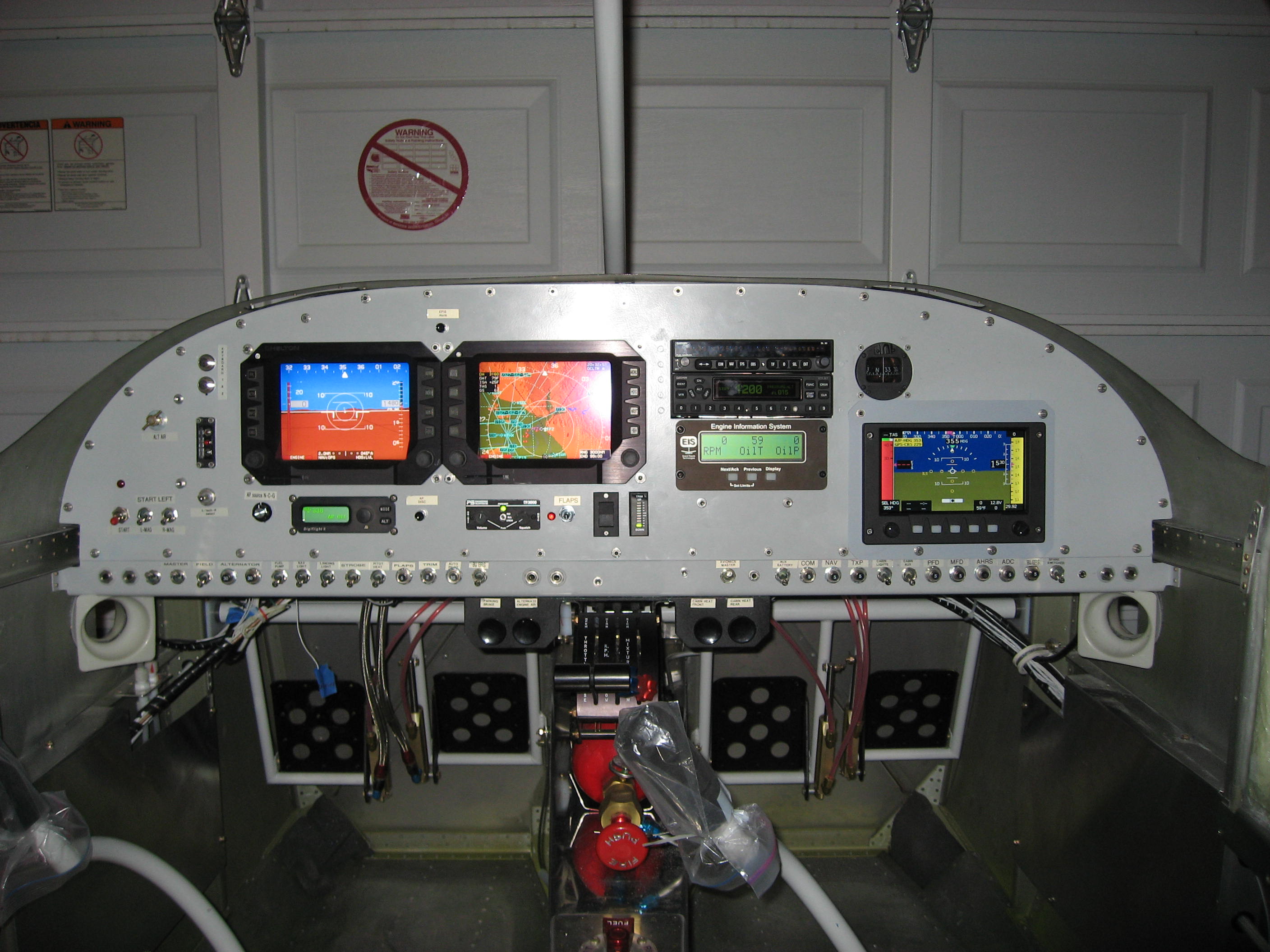

PostPosted: Sun Oct 12, 2008 10:24 am    Post subject: Alternate Static Air Valve Reply with quote
Curtiss valve is used. Check far left of panel and zoom in.
