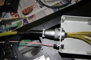

Hi Bob
Would this be 4A per wire? I'd feel very nervous about putting that amount of current through an itty-bitty pin. Although here on the southern tip of the dark continent, we don't get the machined pins, only the useless pressed ones...
If think it's fine, then I'll believe you - I've just spent big bucks on this (see attached pic) military style breakout plug, which is rated at 5A per pin. Sad
Etienne

nuckolls.bob(at)cox.net
PostPosted: Thu Oct 02, 2008 7:27 am    Post subject: Preferred Bulkhead Disconnects Reply with quote
At 09:27 AM 10/2/2008 +0200, you wrote:
2008/10/2 Robert L. Nuckolls, III
<<mailto:nuckolls.bob(at)cox.net>nuckolls.bob(at)cox.net>
>For 22 to 20 AWG wires at 4A or less, the d-subs
>are connectors of choice.
Hi Bob
See:
http://aeroelectric.com/Mfgr_Data/Connectors/Positronic/HDC_Series.pdf
Note contact current rating of 7.5A. In aircraft wire
bundles this assumes a 20AWG wire. Of course, this
drops to what ever the smaller wire is de-rated to
for bundling . . . 5A in the case of 22AWG.
per pin. Sad
Then the $time$ invested to swap horses right now
is probably not a good investment. For others watching
this thread, know that it is possible and practical to
achieve nearly full-mil-spec connections in your small
wires using the really good pins and anybody's removable-pin
d-sub shells.
