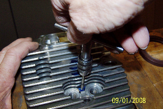

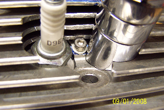

Here ya go, Tex. I had to grind a bit off the fins just above the
area, then level out the little hump, and it was clear sailing to
drill it and tap it with an 8-32 tap. I just cut the old 12mm
terminal off the t'couple lead, bared the leads a bit, shrink tubed
them right up to the bare area and inserted them into a new #8 stud
size, eye terminal. Where the leads contact each other is where the
temp reading actually takes place, so be sure to shove the bare leads
right up to the terminal before crimping. At least that's how this
anal reporter did/does it. : )

Thanks , great pictures..

Yes, I use the hole that I drilled for the screw, and the crimped
portion lays parallel to the head and very close to the surface..as
close as a few thousandths from it....as close as the screw can clamp
it to the surface. You could also do as you say, or suggest, cut off
the eye and insert the crimped portion right into the hole if you
could come up with a suitable way to retain it there. That may be how
Peter Disher did his..see the archives from Aug 25, 2008 from this
List...he has pictures there. I just forwarded this post to you. It
*does* sound like he inserted the bare wires perhaps, right into the
hole, then ran the screw into the hole. I suppose you could tap the
hole, then maybe rout a small groove on one side of the hole in which
to insert the bare wires of the t'couple. In any case, the closer to
the head, or even right into it, the more accurate the reading. What
we are dealing with here however is "uncharted waters", in that
because no one else has done this, or reported their findings, we
don't know just what the readings should be. That's where the pucker
factor for my first flight came from.
I was quick to get the plane off the ground, thinking that I'd better
get it up there and get cooler air flowing over the engine. I was
thinking that my seemingly elevated temps were the result of the
newly honed cylinders and new piston rings causing high friction, but
it was the more accurate readings of the t'couple probe placement
that revealed the higher temps. So what IS the proper temp, now that
we have the more accurate readings....beats me!! Maybe Jabiru knows.
For me, I just tried to keep it below their posted max of 392° F, but
it did go over that once, on the initial startup, running it on the
ground. That's why I quickly got it into the air, and that act almost
bit me in the butt. The tight engine wasn't climbing very well, so I
kept it above tree level, climbing slightly and getting it turned
around and landed. When I realized that the engine didn't feel any
hotter than before, I started to realize that the feel of the engine
was the same as before, but the readings were higher because the
probe was no longer 1/2" away from the head, up into the airstream,
being cooled and giving lower but inaccurate readings of the actual
temp of the head. This is all fine and good if we all do it just the
way Jabiru does it, with the spark plug probes. So I unpuckered, and
began to accept that I would now be seeing 350-380° F as the
norm....my norm, instead of the 275° of before. I guess this is where
the "experimenting" part comes in. : )
I flew to an airport about 40 miles away today, and my head temps
were running about 358 for the most part, and I've accepted that as
my new norm. It comforts me to know that I haven't changed anything
relating to airflow, so I'm accepting the higher readings as being
"normal."
I also wish that Jabiru would give us a socket for a bayonet sensor,
or at least report what such a probe placement would reveal in the
way of temps.

Just a thought Lynn. Do you still have a spark plug ring thermocouple that
you could place on the same cylinder as the newly placed thermocouple?
Reading both temps at the same time should give a good comparison.
Mervin Friesen
Sonex 122 Jab 2200
Lynn Matteson
Posts: 2778
PostPosted: Mon Sep 29, 2008 4:52 am    Post subject: CHT probe placement Reply with quote
Amazingly simple, but great idea, Craig...if I hadn't already
committed to the location I have now, I'd do it. Somebody else do it
and let me and the others know. Jim?
