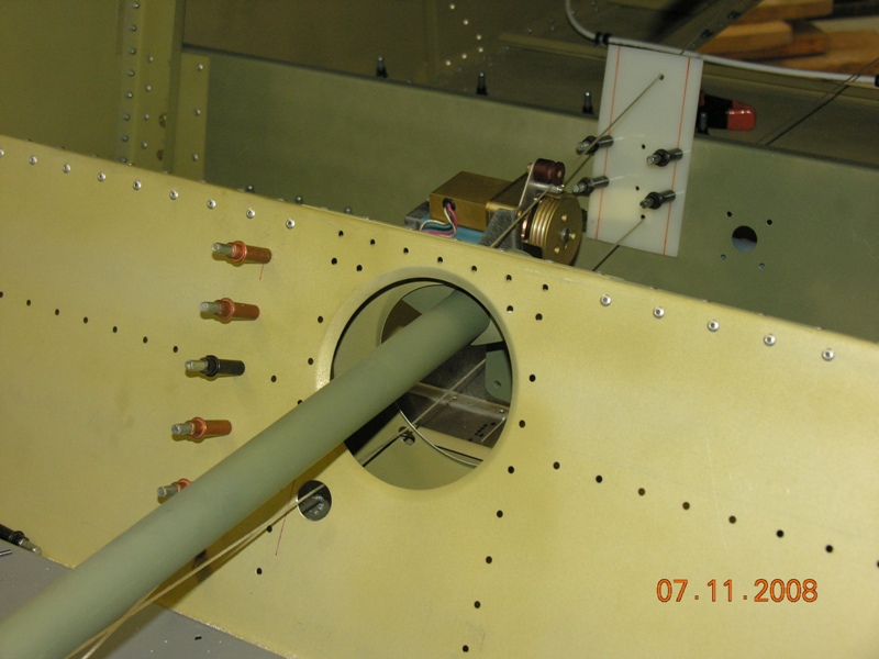

Has anyone fitted a Trutrak 2 axis auto pilot to a 601 XL?I Cm trying to fit the altitude hold servo and it will not go where trutraks drawing shows C it interferes with the rudder cable.Any help would be apreciated.Two emails and two phone calls to trutrak and have had no response.Photo attached

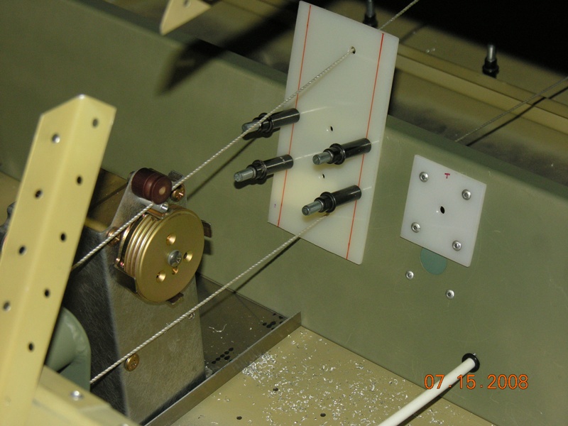

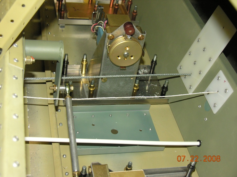

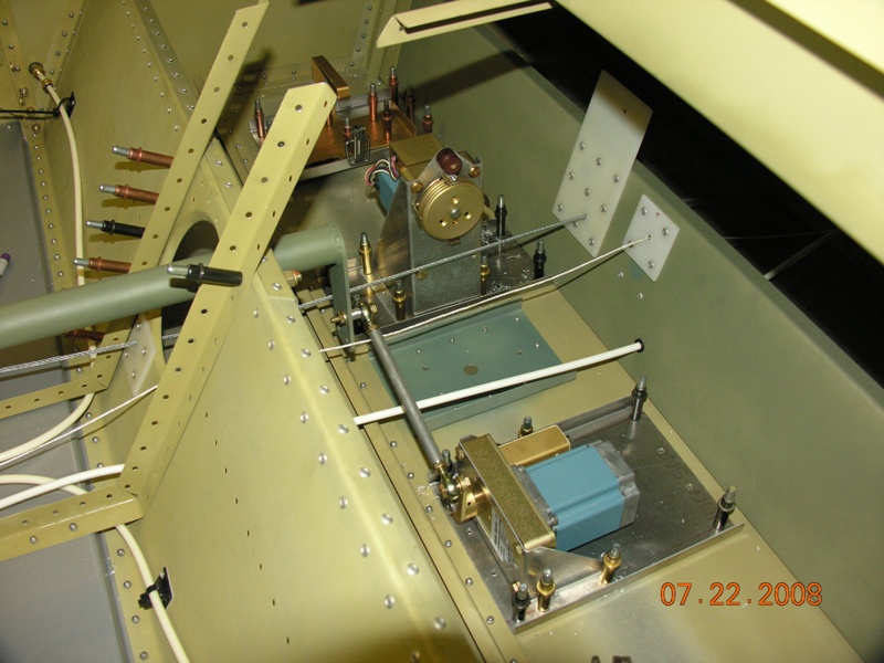

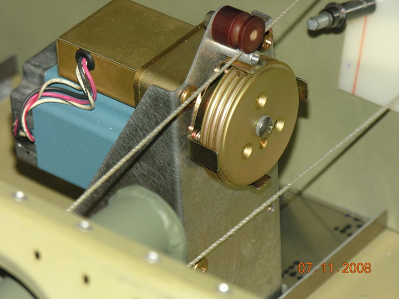

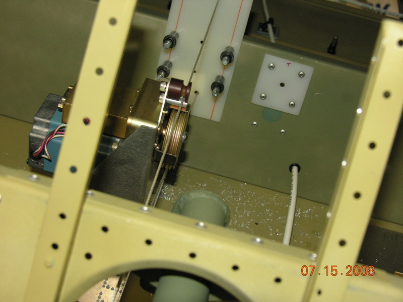

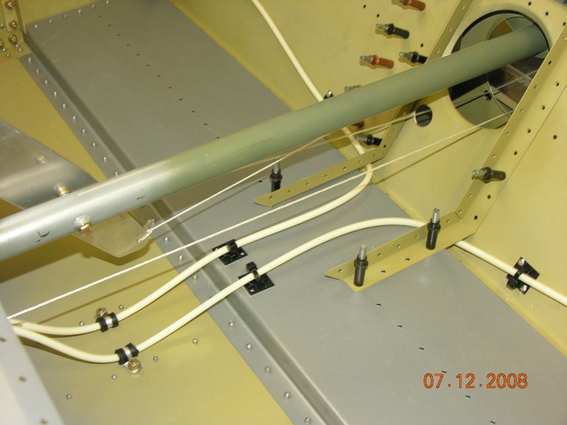

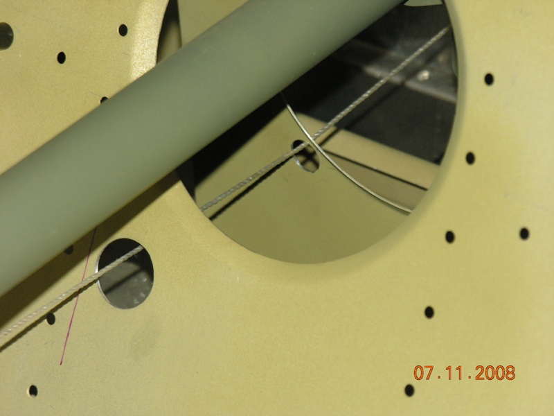

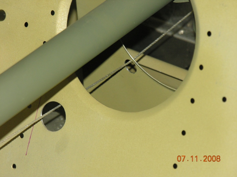

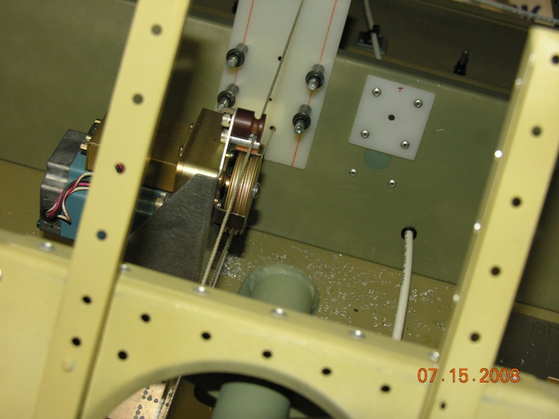

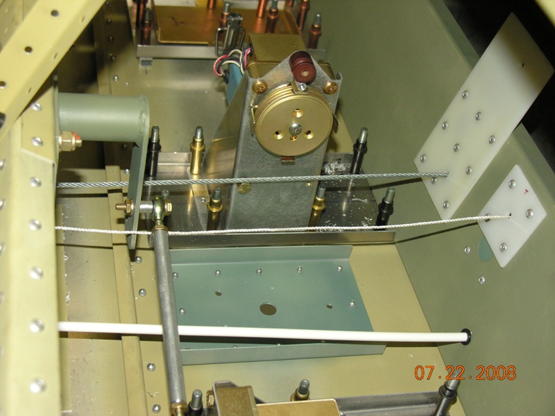

I spent considerable time installing the Tru Trak servos in my XL. It seems that the rudder cables were located differently in rev 1 drawings and the pitch servo fits with the cables that position. In rev 2 and rev 3 drawings the rudder cables were moved (I believe to reduce cable interference with each other) and the pitch servo does not fit. I originally installed the cables as per rev 3 drawing. To make the servo work I moved them back to the original position and then installed several extra fairleads to make sure to make sure the cables do not interfere with each other. Everything seems to fit now. Here are some photos of what I did.

Thanks Mate C
This explains it all.
I don't no why Trutrak could not tell me this.
