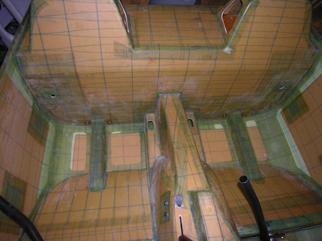

I attach 6 fairly small pictures which I hope illustrate what I'm
talking about.

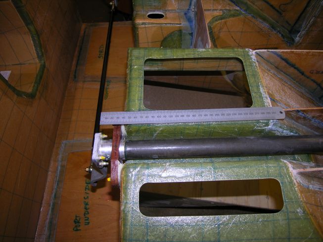

I have fitted the bearings for both ends of the CS05 torque tubes and
was pretty happy with the way it was all going until I put the
cockpit module into the lower fuselage moulding (see picture
DSCN2491.jpg) to do the check of stick movement as advised in the
manual (page 13-10). If I don't sit in the CM, all is fine and
movement of the sticks is constrained only by the cockpit sides and
tunnel. However, when I sit in it, the movement is considerably
reduced; with only about 100mm deflection left or right from centre
at the top of the stick, there's a graunching noise as the corners of
CS07/08 scrape against the fuselage floor.

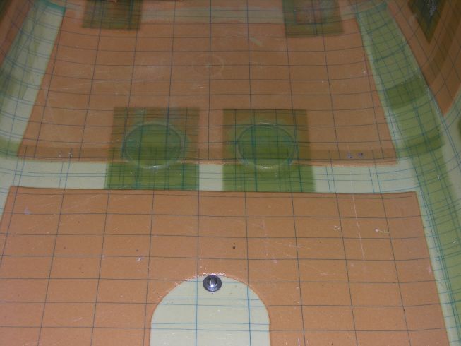

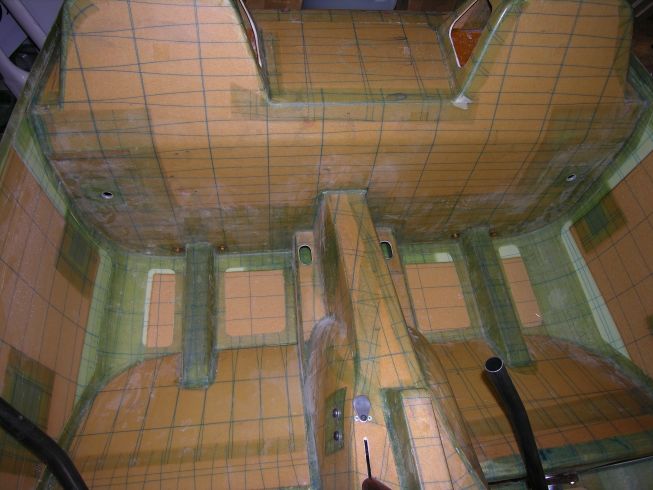

You'll see in the picture that the outlines of the brown foam inserts
in the lower moulding don't seem to have any real relationship with
the various cutouts and shapes of the CM. I'd have thought that
perhaps they would line up in places. They are not even symmetrical
port & starboard (the seats, on my CM anyway, have slightly different
shapes P & S).
I phoned up the factory when I found this and Roger assured me that
all will be well when the CM & lower moulding are bonded and thus
stiffened. However, as I look at things more closely, I am not much
comforted by that.
The cockpit flange at the bottom of the seat backrest is supported by
only fresh air, in the middle of the green area across the middle of
picture DSCN2496.jpg, and any pressure on the seat pan will bend the
CM down into that depression. That causes CS07/08 to touch the
fuselage floor where the small black marks can be seen on the brown
area at the rear of the green stripe. I checked that the clearance

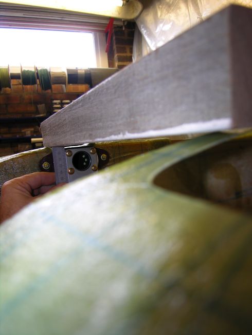

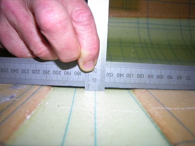

for CS07/08 is correct (~6mm) as per the manual (picture
DSCN2501.jpg), but the depression in the green stripe is about 4mm
deep (picture DSCN2513.jpg) so if the CM is pushed down ito that
locally the clearance will be badly compromised.

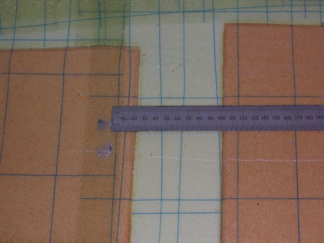

Picture DSCN2515.jpg shows the width of the green depression, with a
ruler placed against the port CS07/08 witness mark. The depression
shows the same ruler positioned on the CM underside against CS07,
demonstrating that the CM flange across the seat-backs falls between
the 25mm mark and the 100mm mark.
I think the engineering solution is to put packing between the CM and
the fuselage where there is no foam layer, so that the Redux will not
need to bridge the full 4mm gap. But what packing? It's got to be at
least as strong as the Redux. Maybe I should go the (expensive) route
of putting in a layer of Redux first with release film to fill the
gap, as I did on the ribs when closing the wings.
Has anyone else found this problem? Or is my CM/fuselage moulding a
mismatched pair?
All input appreciated!
comforted by that.
Rowland, I don't think that you have a problem. There is a lot of
flexibility in the bottom molding until the cockpit module is bonded in.
I did a similar "pre flight" test sitting in the cockpit module before
it had been bonded in and had exactly the same result. Once the module
is bonded everything stiffens up quite considerably and you'll find that
the clearance that you currently have without the weight of your body on
it will be maintained.
There is a lot of flexibility in the bottom molding until the cockpit
Rowland,
I'd tend to go along w/ Tony K's comment, though I did not experience
the issue you're having. One consideration may be your method of
supporting the canoe. I built one of Chuck Popenoe's knock down support
frames (3/4" plywood formers w/ foam pipe insulation spaced w/ 2 x 4s
running fore and aft) which gives much more support than the sketch of
the support frame provided me by Europa back in 200?. In any case,
don't hesitate to lay the Redux on thick when the time comes to bond in
the CM and take care as to not localize pressure with blocking and
strapping.
Hope this helps,
Fred

Hello Rowland,
Sorry to learn you have been crook but nice to know you are back on deck
again.
I had the same problem with the bottom corners of the CS08s contacting the
fuselage floor. My solution for this was to locally remove the inner glass
plies and then to sand out the foam leaving it chamfered around the edges to
ramp back up to the floor level. I then laid up two plies of bid into the
indentation lapping over the edges of the floor previously cut. This gives
the best part of 3mm extra clearance.
I also filed away any excess material on the bottom corners of the CS08s as
well.
the various cut-outs and shapes of the CM. I'd have thought that
shapes P & S).
I understand where you are coming from with this Rowland. It is a long
while since I did mine but from memory, all of the cockpit module parts to
be bonded should mate with glass only sections in the fuselage. It his is
not the case, would
removing some extra material from the module allow this?
Is this because some parts of the module are resting on foam sandwiched
areas of the fuselage as mentioned in my last comment ?
deep (picture DSCN2513.jpg) so if the CM is pushed down into that
Assuming I am understanding this correctly, if the module is lowered such
that the
cockpit flange at the bottom of the seat backrest contacts the glass only
area, the interference with the bottom of the CS08s will be worse, hence
the need to remove material locally as mentioned above.
Hope I have made SOME sense Rowland.
Best regards
Kingsley in Oz

Hi! Rowland.
No pictures received, however seems to me that you are expecting the
structure to take your weight before bonding without the stiffening
provided by the bonding. This is not how it all works !
Assuming the control stick movements are not stiff prior to bonding the
CM in place (perhaps you can recall my oscillating with brasso etc.
items to free off? Also check you have the assembly rivets correctly
oriented in the control tubes (if the push rods have rivets at the top
and bottom they can rub against the larger torque tubes internally, they
need to be off the vertical centre line)
Firstly put a nice (considerable radius) on the corners of the CS07/08
items. With a dummy run of module inserted and fuselage very adquately
supported so that the sides are the correct width (without stress).Then
mark out all the places that the CM abuts or is supposed to abut the
fuselage. Remove the CM and apply thick layers of stiff Redux to the
previously marked areas. Then apply similar redux to the mating areas of
the CM. Then carefully lift the CM into place allowing it to settle down
without undue bending pressure likley to deform it from it's natural
shape.
The redux where too thick will squelch out from the bond areas but stay
in place in the clear gap areas. If you shine a strong light behind all
the join areas you will highlight all places needing attention. Scrape
off all surplus Redux which has squelched out and trowel this spare
redux into area's where there's gaps or shortage ensuring the width
areas are suitably abutted with one or two LOOSELY applied pop
rivets.(Rivets only partly extended)Wipe out areas of remaining surplus
and leave to cure. Bingo!
IMHO do not pull the flanges of the CM down where they are gapped
because:-
a) you stress everthing up
b) you make indentations on the outer fuselage surface needing filler
to fill them.
You will ultimately use less weight of Redux than the larger areas of
filler needed and for my money I'd rather ride on Redux than filler as a
structure !
Further don't mess with release agent or cling film you will not get a
good bond, I say again just fill all the gaps with trowelled Redux.
Tony - that sounds good theory, but how in practice do I ensure that
everything stays where it ought to while doing the cockpit module
bonding?
I haven't yet done all the drilling and cleco-ing that is called out
in the manual page 11-6 (trial fit of CM) to fit the CM as closely to
the lower fuselage moulding as possible, and fear that I could easily
make things worse instead of better during that process. It says
"drill and cleco other areas until your cockpit module is a snug fit"
but I can't see how you get a snug fit of the relatively flat CM
surfaces against the fuselage moulding which goes up and down at
every edge of the brown foam inserts.
The manual also says "Use as few clecos as is necessary to fit the
module to the bottom moulding. Remember that when you come to bond
the module into the fuselage bottom moulding you will be able to
locally weight down any small areas that need it". If I were to weigh
down the aft end of either seat-centre tunnel, that would ruin the
CS07/08 clearance.
Why doesn't the area of the CM around the CS06 rear bearing actually
rest on the fuselage floor? It seems crazy to take care setting up
the clearance for parts at the aft end of the torque tube, and then
leave it dangling in fresh air.
regards
Rowland
Kingsley - thanks for your message. I thought about that , but I
think I'd need clearance from an inspector to proceed with that.
I'd only get about 1mm or less by doing that - they're pretty close
to the screw heads already, although any extra clearance would be
welcome.
his is not the case, would
All the CM flanges around the seat area (and the ply thigh-support
ribs) mate with brown foam areas on the lower fuselage moulding - it
covers all the central bottom area of the lower moulding (see the
pictures attached to the first posting). The only CM bottom flanges
NOT resting on foam are the outboard and rear edges of the seat pan,
although the one at the port side is wide enough to catch the foam at
its inboard edge.
Yes - see above.
if the module is lowered such that the
Yes. But the module doesn't lower into that position naturally; only
if pressure is applied at the back of the seat pan does the CM
distort to allow that flange to contact the plain glass area of the
fuselage floor.
Yes, I think we are on the same wavelength, but I'm still a bit puzzled.
regards
Rowland
| Rowland Carson LAA #16532 http://home.clara.net/rowil/aviation/
| 1110 hours building Europa #435 G-ROWI e-mail <rowil(at)clara.net>
Bob - thanks for your message. I can see now that I was associating
the 2 different instructions on page 13-10 in an inappropriate way.
Near the top of the page it says "orientate the column such that the
tube cranks aft and slightly inboard so that there is equal space
between it and each of your thighs" and obviously you have to sit in
it to check that positioning.
But near the bottom of the page it says "check that the minimum
control movement that can be achieved without interference, is 22.5
cm (9") fore and aft and 28 cm (11") laterally" but it does NOT say
you should be sitting in it for that check; I had just mentally
connected the two!
CM in place
No problem there - without the sticks fitted the weight of just the
aileron cross-link pushrod is enough to make it all fall to neutral
with the CM upside-down. I used good-quality furniture wax
(non-silicone) instead of grease on the Tufnol parts and that seems
to have worked well. I also included plastic shims when assembling
CS02/03/04 - see my website journal at
<http://home.clara.net/rowil/aviation/200808.html> for the whole
story. Note later also the method of inserting thin wires to keep
CS05 & CS02/3 co-axial and thus avoid any binding between the front
and rear bearings.
This seems a good idea, but how is that correct width determined? I
can't immediately see any reference for that dimension.
good bond
I found that when I did this on the wings, the hardest part was
getting the gap-filling cured Redux abraded again enough to key
properly with the final coat. But in the wings it was more desirable
to do it that way, as it's not possible to see where there is excess
or insufficient Redux at final bond time. For the CM bonding, most of
the areas are visible during the whole process or can be made so by a
strong light.
regards
Rowland

Rowland,
All the CM flanges around the seat area (and the ply thigh-support ribs)
mate with brown foam areas on the lower fuselage moulding - it covers all
the central bottom area of the lower moulding (see the pictures attached
to the first posting). The only CM bottom flanges NOT resting on foam are
the outboard and rear edges of the seat pan, although the one at the port
side is wide enough to catch the foam at its inboard edge.
Because I have little trust in my memory anymore, I pulled my fuse out of
the trailer this morning to check. Parts of my module DO mate with the
foamed areas of the fuselage but where they do, the module is rebated to
accomodate this. Does your module not have any rebated sections? There is
a slight joggle where the rebated sections start but they are not very
prominent..
Kingsley - thanks for your message. I thought about that , but I think I'd
It must be a pain not being able to make a small change like this without
jumping through hoops etc. It was once like the UK over here too but thank
goodness, we have the Experimental Regulations here now.
Maybe you can raise the rear bushes a little. . . . I too had the rear
bushes installed as per the book but as I said previously, they turned out
not to be quite high enough.
I hope you can get on top of your hitch at the moment Rowland. There is
always a reason and a cure but properly identifying the problems can often
not be the easiest thing to do.
All the best
Kingsley

PostPosted: Thu Sep 25, 2008 1:52 pm    Post subject: cockpit module alignment Reply with quote
I had the same problem and was told to remove the foam locally from the
inside of the fuselage where it was contacting the torque tube and then
patch over the exposed area with 2 ply of bid there by creating the
clearance required. Regards richard
