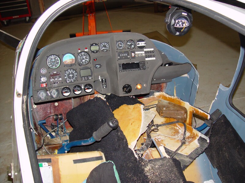

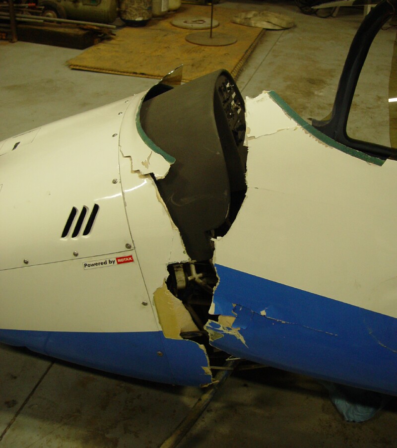

further to my eMail of Feb. 25th, 2007 I am glad to report that N81EU took to the Air again today. The harder-than-normal landing last year had sheared off one main wheel, bent the other and torn off the nosewheel, cracked into pieces the engine mount, folded like an accordeon the central tunnel and made three parts out of a fabulous fuselage. Reason was an engine failure right after take-off. I later found that during the exchange of a fuel filter, some debris from the aging fuel line had entered the filter opening and allowed sufficient fuel flow for the run-up and taxi, but full-take-off power was available for only some 80 ft of altitude.
It took me longer than anticipated to rebuild - mainly due to the fact that my employer sent me to Calcutta for one year, but today finally she (for a second time) reverted from a mountain of nuts and fibres and metal bits into a flying machine.

[img]cid:001401c91c2a$0260fea9(at)PaPASony[/img]
(breaks your heart, doesn't it ?)

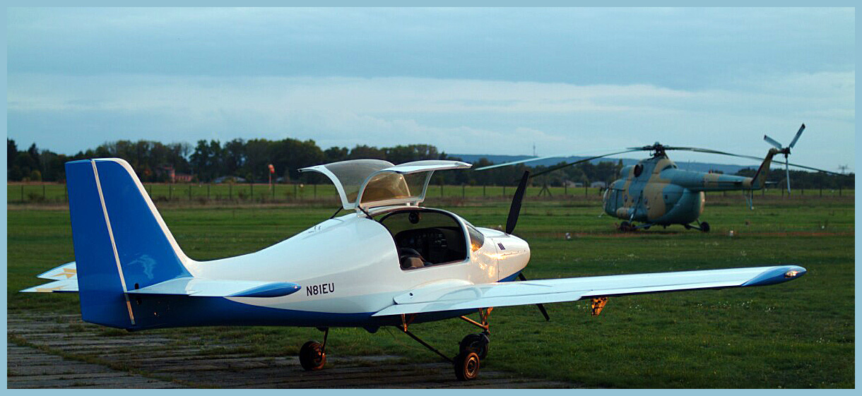

[img]cid:001501c91c2b$00032f70$0260fea9(at)PaPASony[/img]
(the compass was unhurt)
[img]cid:001601c91c2b$00063cb0$0260fea9(at)PaPASony[/img]
(taken today after the flight at airfield EDAL - former East Germany)

<81eu_ng_03.jpg>
<81eu_ng_04.jpg>
<europa01.jpg>
