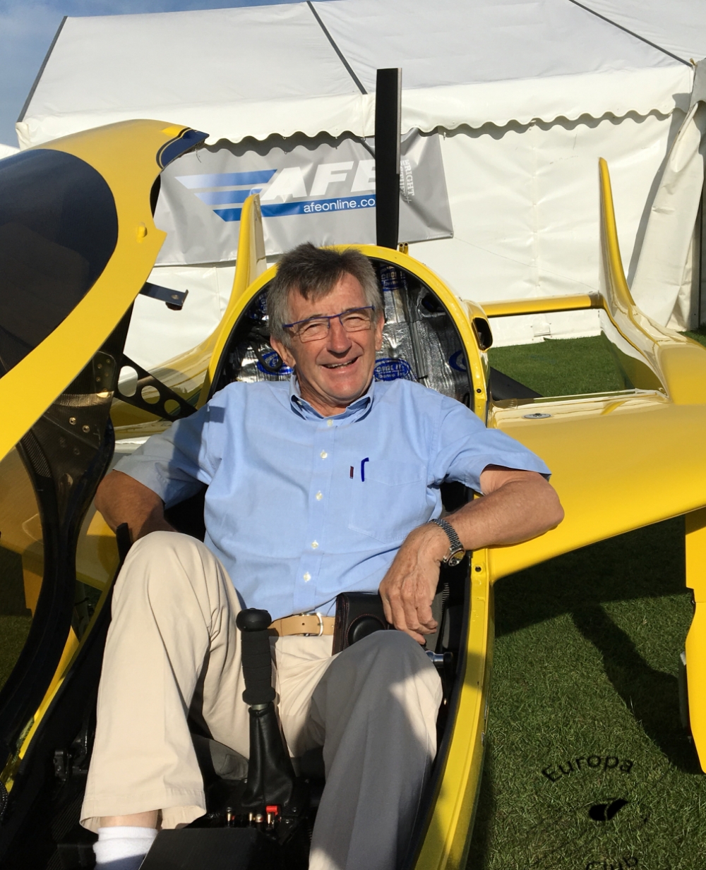

Paul M 383
Joined: 19 Mar 2012
Posts: 102
Location: United Kingdom
PostPosted: Tue Mar 28, 2023 8:31 am    Post subject: Re: Widening the cockpit - Mod 67 Reply with quote
"I wonder what demographics Europa had in mind when they designed our beloved airplanes"
Ivan Shaw is 6' 2" and not slim (I'd say that to his face, so no worries Very Happy)
https://www.theeuropaclub.org/the-europa/creator-ivan-shaw
HTH
Paul

n7188u
Joined: 15 Nov 2015
Posts: 408
PostPosted: Tue Mar 28, 2023 9:20 am    Post subject: Re: Widening the cockpit - Mod 67 Reply with quote
Yikes, that is tight (sorry Ivan, you know we love you the same) Smile
I guess he really wanted to go fast. Mission accomplished on that front.
