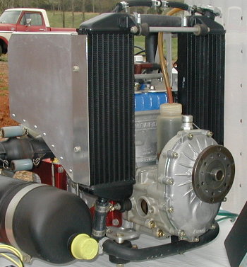

My friend Dave Lewis is trying to figure out how to route the lower hose that joins his dual, rear mounted rads on the 582 Slingshot he bought.
The airframe and engine mounts make quite a maze, complete with sharp edges. Also the lower hose nipples on the rads face forward pointing the wrong way for easy hose routing.
Any pics you have would be helpful.
He is getting close to first start up since he bought it and this is the last problem that needs resolved.

[img]cid:CFD2A6DC23EB4412A5CD10274FD445A6(at)GreensPC[/img]
Denny,
Is This what you want?
Steven

Steve,
That is the kind of info we need, we have been looking at maybe lifting the engine and running the hose underneath, but I'll foreward your pic to dave and see what he thinks.
Dennis
