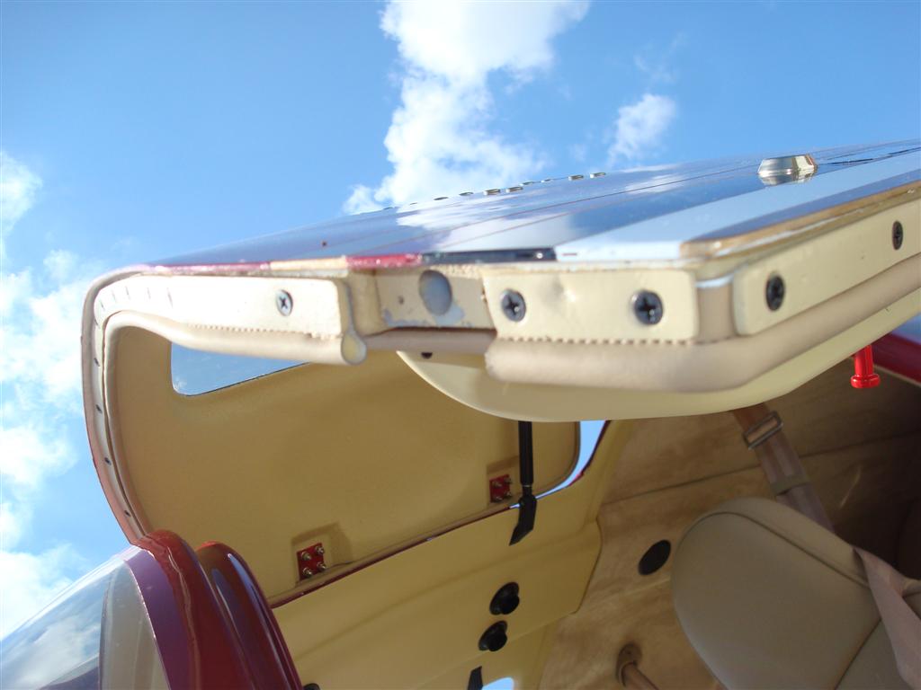

That would be Don O (for some reason his last name escapes me at the moment). But he had his interior done by Abby so she might have some good info on it.

This looks to be the same stuff that Alex sells. Not sure who is cheaper. If anyone has a quote from Aircraft Door Seals let us know. I know Alex is $68 but not sure if that is per door or for the set. Another $45 for the baggage door.

Here's a picture of Don Orrick's door seal.

That is the one that I saw at KOSH E It was a asterful job - although David mentioned that making the fiberglass trim pieces was quite a bit of work E He had Abby of Flightline *I think* make the seals out of the same material used in the interior E

I had looked at Don's seals a while back. This is one of the options we are considering since Abby also did our interior. I was just hoping to drive to, and fix the root cause of the problem. In my opinion, since many people experience this same problem, and have provided many different solutions, Vans should provide a 'factory' solution. In talking with Don about his seals, he said the 'bulb' is smaller, and this is what he thinks fixed the problem. If I remember correctly he also said that Van's factory airplane used a seal with a smaller bulb than what is supplied in the kit.
Our seals were installed per the plans, although orienting the seal in the opposite direction may help.
While placing the seal on the cabin top instead of the door may work, I wonder what the long term durability of the seal will be with people grabbing the door frame to enter and exit. Would it matter if same seal were placed on the door?

I do like the seal on the door, not the frame, just for
your reason of grabbing it accidentally. I also like
that my seal is very tight and waterproof, but I sure
wouldn't argue if it had a slightly smaller bulb as you
noted that Don talked about. I think the silicone seals
like what come with the kit would seal about as good
as you could ever find....but the size is just a tiny
bit thick to make the door close easily.
jkreidler wrote:
<jason.kreidler(at)regalbeloit.com>
Thanks, Jason
-------- RV-10 Quick Build 4 Partner Build - Finishing
http://forums.matronics.com/viewtopic.php?p 2350#202350
