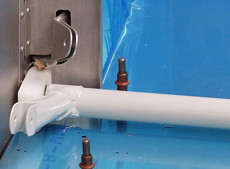

Dear Listers,
Have a look at the attached photo. The rear predrilled holes for
mounting the flap weldment nylon blocks seems to interfere with the
seatbelt attachment. Am I missing something here? The blocks are
drilled according to the plans and the rear holes are already drilled
and have the platenut installed. Do I just added some washers above
and below and call it good? Seems hokey. Notching the belt attach
also seems like a poor idea.

Matt,
My nylon blocks were so poorly made, that I decided to make a proper set of replacement pieces myself. I noted the same problem you did. I counter-bored the tops of my parts to allow the use of SHCS (socket head cap screws aka Allen head bolts) to retain the flap weldment. This eliminated the interference issue you have noted. Using the SHCSs also eases future maintenance of this assembly.
Charlie Kuss
PS Sorry, but I never took any photos of this mod. If needed, I suppose I could take a few.
