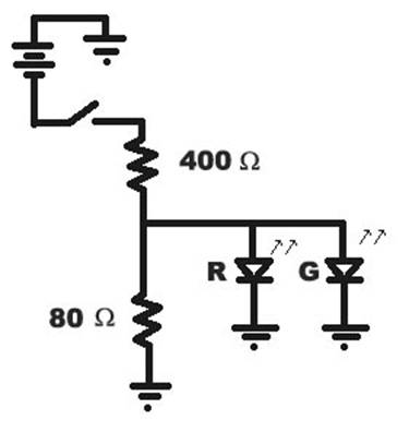

You may also try a simple voltage divider circuit....  Most NOT ALL LEDs will light on around 2V and a couple of milliamps of current.  Convenient size red and green LEDs can be salvaged from old Christmas lamps... look for an old store display that’s being turfed out.
[img]cid:image003.jpg(at)01C912BD.E1FB9510[/img]This diagram should work for 12V... you may want to play with the values of the resistors a bit.  The calculations I made using the 400/80 combination was just for one LED.  Two LEDs will probably be around a 200/40 combination.   ¼ W resistors should suffice.  You can even add a white LED for the tail.  Current draw should be horrendous....  less than 0.03 Amp per light. Continuous burn (not switched) it will flatten your battery in about three years.  (1- LED)
The two resistors in the circuit produce what is known as a voltage divider circuit and should produce close to 2V for the LEDs.
If that’s too complicated you can always run the LEDs directly off a replaceable penlight battery without the resistor circuit.  Just wire the LEDs in parallel.  A great place to use all those old half used camera batteries.
One thing not mentioned about the coloured LEDs is, they only emit a single wavelength of light so if you combine the light of a red, green and blue LEDs you can make a nice cockpit flashlight that will not cause your pupils to close down as regular flashlights do.

"A LED is a LED" is not entirely true unless you are not too interested in
high light output. High intensity LEDS are a pretty new and exciting
development. There are LED products on the market now that weren't
available a year ago. Keep in mind that they are amperage sensitive so
output will vary with voltage shifts as we put the 12 or 14+ volts through
them depending on battery condition or charge voltage - hence the
requirement for a regulated power supply. It's not like buying a couple
of fifty cent LEDs and putting a resister in the circuit to keep from
flrying them, unless all you need are low light output panel indicators.
The Lancair guy, I helped in the build, is in the forefront of LED powered
fluorescent tube replacement technology here. It won't be long before all
interior lighting is LED based and the incandescent bulbs, fluorescent tubes
and twisted bulbs will be in museum displays for our grandkids to look at
and laugh. These units won't be full of the LEDs available at Radio Shack.
Again, go to Kitplanes and read the three articles on this subject ending
with the October issue. The Modules recommended in this article are
available from Mouser for $9 to $11 a pop depending on color. It is
interesting that the current requirement varies with color and the power
supplies are slightly different to provide for that.
Also keep in mind that these are collision avoidance items and light output
is an important consideration.

Spot on Lowell!
That's why I recommended getting the LEDs from a scrapped Christmas
displays. LEDs do give off different colours depending on the doping of the
semiconductor and as you well pointed out because of the different doping
the current draw will vary. White and blue are actually sort of fluorescent
lights in their own right as the colour is given off by the fluorescing of
UV light given off by the junction. That makes those LEDs slightly more
expensive. I have found by using white LEDs year round (on my deck) that
after a year or so the white ones degrade and eventually fade out completely
no doubt because of UV light from the sun. I also have red and green LEDs
in my lamp posts at the end of the driveway ( red right return same as
navigation ) they have been lit 24/7 except for power outages for three
years now. I decided to check them the other day and they are the same as
new. Yes they are red and green strings (30) of Christmas indoor/outdoor
lights.
The Christmas lights are usually wired in strings of 30 wired in series so
the voltage drop across each LED is 110/30 = 3.6V... The really beautiful
thing about them is they give off almost no heat so that puts their
efficiency way up through the roof. The other nice thing is they are turned
off for more than 50% of the time. As diodes they only allow forward
current to flow when the threshold voltage is achieved, that only occurs for
less than 50% of the AC cycle.
You make very valid points on the high output LEDs but most of the red and
green units are not of that type... they are however just as bright as most
of the incandescent nav lights. High power lights are generally the lighter
colours, white and blue are examples but as you mentioned new ones are being
designed and built every day.
I noticed the other day that even the traffic lights that are now being
swapped to LED are much brighter when you are facing them but off to the
side it is hard to tell if the light is on or not in open shade.
Noel

From: Noel Loveys [noelloveys(at)yahoo.ca]
navigation )
Ah, but then you use the IALA system B, my friend! If I ever drive to your home, I would be confused, accustomed to the European system A that has red on red and green on green when sailing TOWARD a harbour! Smile

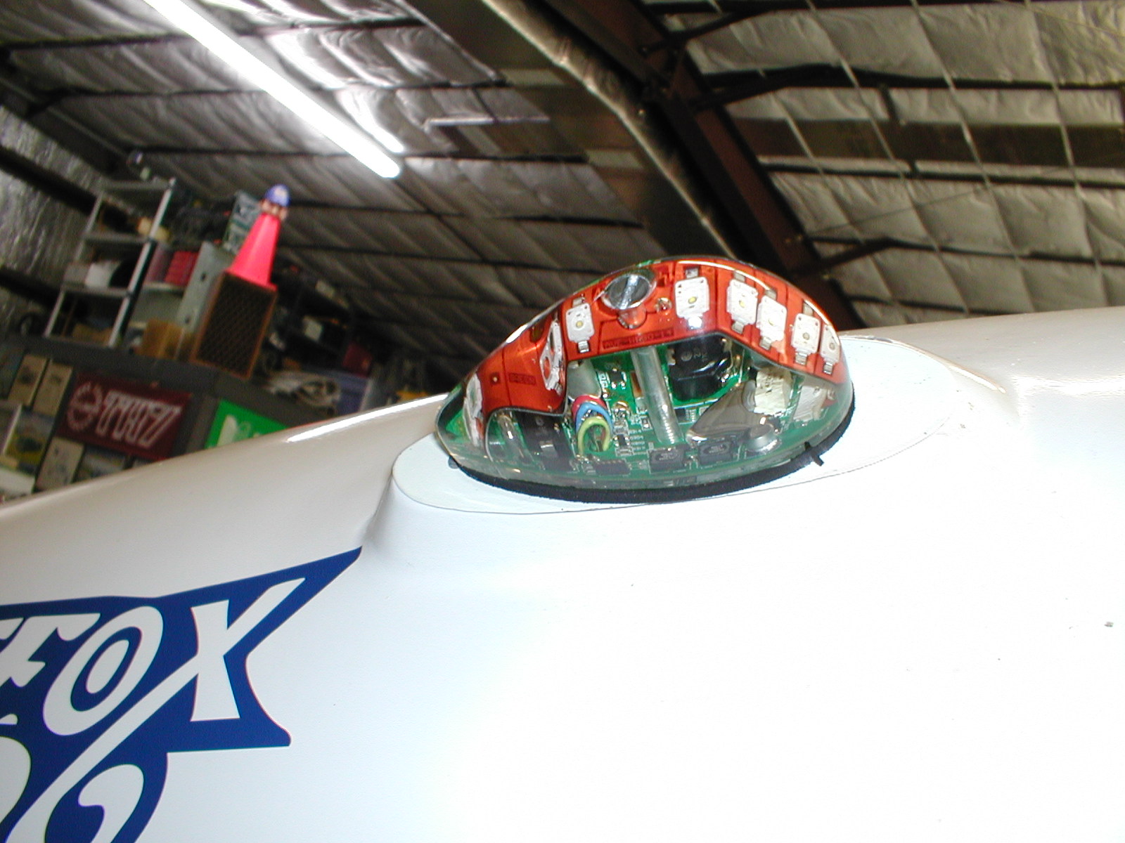

Just sold my Whelen wingtip strobes on Ebay for almost $400. That really reduced the price of my Aveoflash strobe/running light led units that I installed on my aircraft and bought from Spruce ($600 the pair). These self contained units fastened right to the wingtips with a minimum of effort and I am in business.All sealed in a lump of plastic with no power pack.It couldn't be more simple! Power use is 750 ma for the two. They are bright ! (even with the leads attached to a simple 9 volt battery) One of my better purchases(next to Lowells trim system--but not that good!)
      Dick Maddux
      Fox 4-1200
      Pensacola,fl
Psssst...Have you heard the news? There's a new fashion blog, plus the latest fall trends and hair styles at StyleList.com.
 Filesize:  324.15 KB
 Viewed:  710 Time(s)

There are 12 volt, 5mm LED's available on eBay. THe colors red and green are available. One of our local flyers recently installed an HKS 700 on his Thundergull and with everything turned on, he was overtaxed on amperage. He ordered some of the 12 volt LED's and with a little backyard (Experimental) engineering replaced the incandescent bulbs in in wingtips with several of the LED's. So far...so good. They look good at night. I think he spent around $20.
Travis Smile
