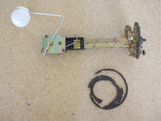

I had a problem with the VDO Neoprene Fuel Sender Seals on my 601XL.
I originally sealed them with a thin coat of Sealube and I had no problems
for the first
1/1/2 years using 100LL exclusively. Then I placed 92 octane auto fuel that
contained ethanol of 10% into my
tanks. The station assured me there was no ethanol in their fuel. I should
have tested it prior to pouring it into the tanks. I tested it after it was
in the tanks. I thought that I could burn this one
tank off as long as I remained below 3000 Alt I should not have any real
problems.
It was in my tanks for 2 weeks before my fuel filler caps were becoming very
difficult
to remove, the fuel drain valves began to leak, and the VDO Fuel Senders
began to leak.
I drained the tanks and tried to reseal the tank senders without any luck so
I pulled them from
the normal access holes which turned out to be much easier than I expected.
I have attached a picture of the total destruction of the gasket material.
These are the original seals
that come with the VDO Fuel Senders.
I found new VDO seals available from http://www.Eguages.com for about $5
each.
Whether it was the ethanol or some other additive maybe this report will
save time, money, or increase safety.

davgray(at)sbcglobal.net Guest
Posted: Tue Sep 02, 2008 3:41 am Post subject: Leaking VDO fuel sender seals |
John
I misspelled the egauges addresses in the original post
Here is a better description and the corrected source address:
Part No: 226-053 Notes: Neoprene, 2 1/8" bolt circle (54mm). By VDO.
Actual page address of sender and gasket
http://www.egauges.com/vdo_send.asp?Sender=10_180ohms
Gary Ray, 601XL, WW Corvair 2700 cc
davgray(at)sbcglobal.net (davgray(at)sbcglobal.net)

Check the test kit. The process for ethanol removal is the same as the test kit. Apparently 10cc of water is enough to dissolve all of the ethanol out of 20cc of E10. I'm sure this is the method the guy at our local chapter was using to remove ethanol from gas. Makes sense to me.
http://www.fuel-testers.com/MPG_gas_efficiency_E10_ethanol.html
And you're not really costing yourself any money either by getting rid of that garbage ethanol, the ethanol just robs you of power and fuel efficiency by a considerable amount. |

What I gather though is, being that the PIC is federally licensed, and the Fed doesn't require oxygenates in fuel, and the PIC is responsible for the safety of his flight, the Fed rule should supercede a state mandate on an oxygenate provided it meets octane requirements which is 91 octane or higher. Sounds like a 93 mo-gas with the ethanol removed for a STC'd plane meets that requirement. Plus, it's considerably cheaper. If anyone ever questioned it you could just say that "during pre-flight I must have accidentally drained all the ethanol out of the fuel, because man, I was standing there for an a hour trying to get a clean sample due to all that garbage and condensate in the fuel." LOL
| Gig Giacona wrote: | In Texas that is probably true because there is no state requirement that fuel meet the ASTM D-4814 specs. There are several states that do have that requirement.
http://www.autofuelstc.com/autofuelstc/pa/LeadD-4814.html#anchor749413
The Peterson aviation site has all the info on Auto Fuel STCs and you could ever ask for.
| wjones(at)brazoriainet.co wrote: | In one of the classes for my IA renewal a couple years ago the FAA
instructor said that no auto fuel made since 1990 met the requirements of
the STCs for certified aircraft use .I can only believe that he knew what he
was talking about don't know for sure .You may want to check this out with
your local FAA .
Wade Jones South Texas
601XL Franklin 0-235
| | - The Matronics Zenith-List Email Forum - | | | Use the List Feature Navigator to browse the many List utilities available such as the Email Subscriptions page, Archive Search & Download, 7-Day Browse, Chat, FAQ, Photoshare, and much more:
| Back to top |
Gig Giacona
Joined: 10 Jan 2006 Posts: 1416 Location: El Dorado Arkansas USA
Posted: Thu Sep 04, 2008 1:20 pm Post subject: Re: Leaking VDO fuel sender seals |
I think I'll just play it safe and run 100LL. That is after all what the guy who built my engine suggested.
