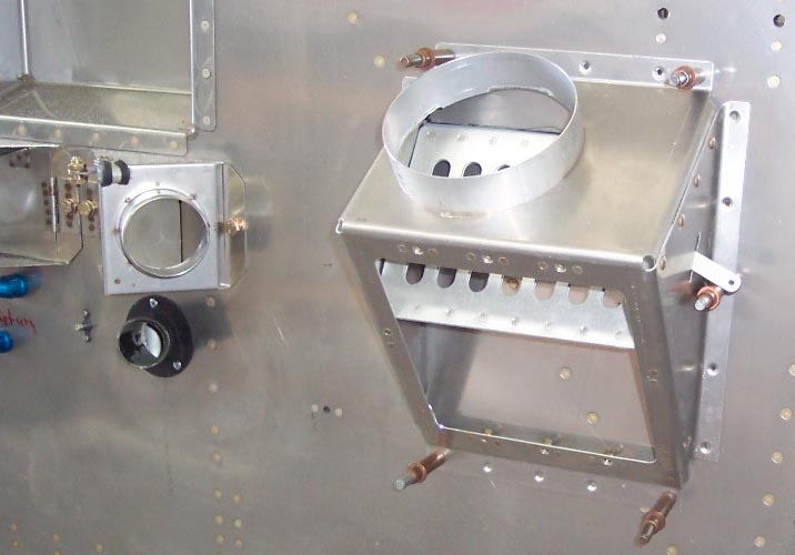

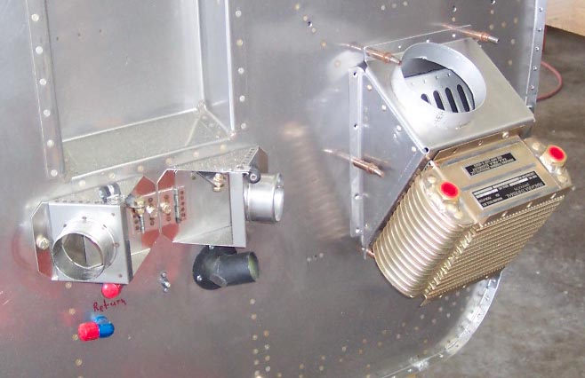

PostPosted: Tue Sep 02, 2008 8:21 am    Post subject: In Flight Adjustable Oil Cooler Reply with quote
We added the gate style control to the oil cooler housing to be able to
control the temp with the pull of a knob. This is common in other RV
models.
Photos attached.
Robin
