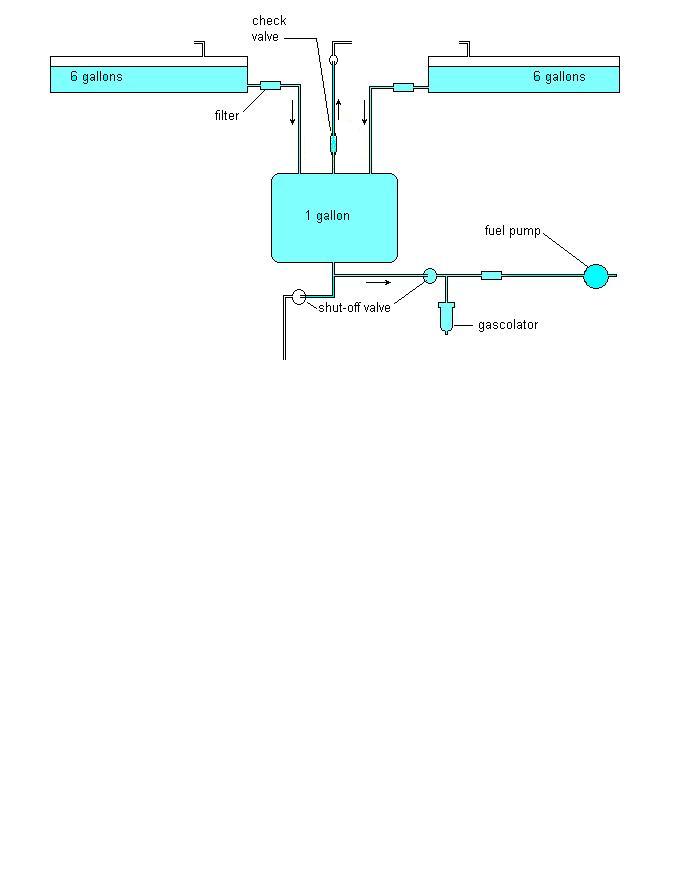

Hi Dan. I have two 6 gal wing tanks and a header behind the seat. Each wing tank flows into the header and the header feeds the engine. Everything runs downhill. The wing tank levels equalize nicely in this configuration.
The header tank is vented to the outside of the cabin. There is an in-line valve in this vent that is open for fueling (to bleed air from header during pre-flight) and closed for flight. (I tried an Andair check valve here first but it did not stop fuel from being sucked out into the slipstream). So far all this has all worked very well. I've attached an illustration. The gascolator is really superfluous but harmless and easier to leave in than to remove.
Marco Menezes N99KX
Model 2 582-90 C-Box

I build a Model I with this arrangement. There has always been a little confusion about it. The bleed valve atop the firewall header tank is used to purge the air out of the tank during preflight. It’s kind of a messy operation. But if the valve were left open, the air would all leave and fuel would pour out continuously because the tanks feeding it are higher. In later designs, Denny Aerocraft routed this vent, without a valve, to a line that returned to one of the wing tanks. However, your arrangement will work fine, but you have to remember to purge the tank. One Model II friend of mine had a forced landing because he wasn’t regularly purging it.
It’s true that fuel does not drain evenly from the tanks in early Kitfoxes – tiny pressure differences between the tanks and small differences in fuel line resistance causes this unevenness of flow. It turns out that one tank will nearly empty before the other one starts catching up, but doesn’t cause any problems - the engine feeds off the header tank just fine.
Two other things blocked fuel in early Kitfoxes that caused engine stoppages. One was the “uphill” hose routing at the wing root, forwards above the door. The other was locating the tank shutoff valves before any vertical drop of the fuel line. Not only does fuel not like to be sucked uphill, but air gets trapped in unsmooth places like a valve where head pressure isn’t great enough to overcome it. Both these issues, the uphill travel and the shutoff valve placement, were identified by Denny Aerocraft as problems that needed to be fixed.
In later designs, the header tank was moved behind the seat and vented with a line to an upper fitting on one of the fuel tanks, no bleed valve needed. This arrangement allowed for some head pressure before going through any shutoff valve. It also ensured there was no uphill run before reaching the header tank. I’ve flown this improved arrangement for 350 hours without any problems.
However, I believe your arrangement can work fine if you do three things:
<![if !supportLists]>1) <![endif]>Purge the air every day before flight.
<![if !supportLists]>2) <![endif]>Move any shutoff valves located at the wing root to a lower location to get some head pressure going into the valves.
<![if !supportLists]>3) <![endif]>Route any over-the-door fuel lines to run more or less straight down behind the seat to get some head pressure before going uphill along the floorboard and then to the header tank. Although this route is more circuitous, the fuel will appreciate the extra head pressure before it tries going uphill.
Because gravity-fed fuel pressures are so small, literally hundredths of a pound, it doesn’t behave like house plumbing. It’s more like rain water running down a sidewalk – it’s easily diverted or stopped. Another thing I recommend against is the use of T fittings in gravity-fed fuel systems. Fuel easily gets trapped at junction by an air bubble - it’s much better to use a Y fitting.
