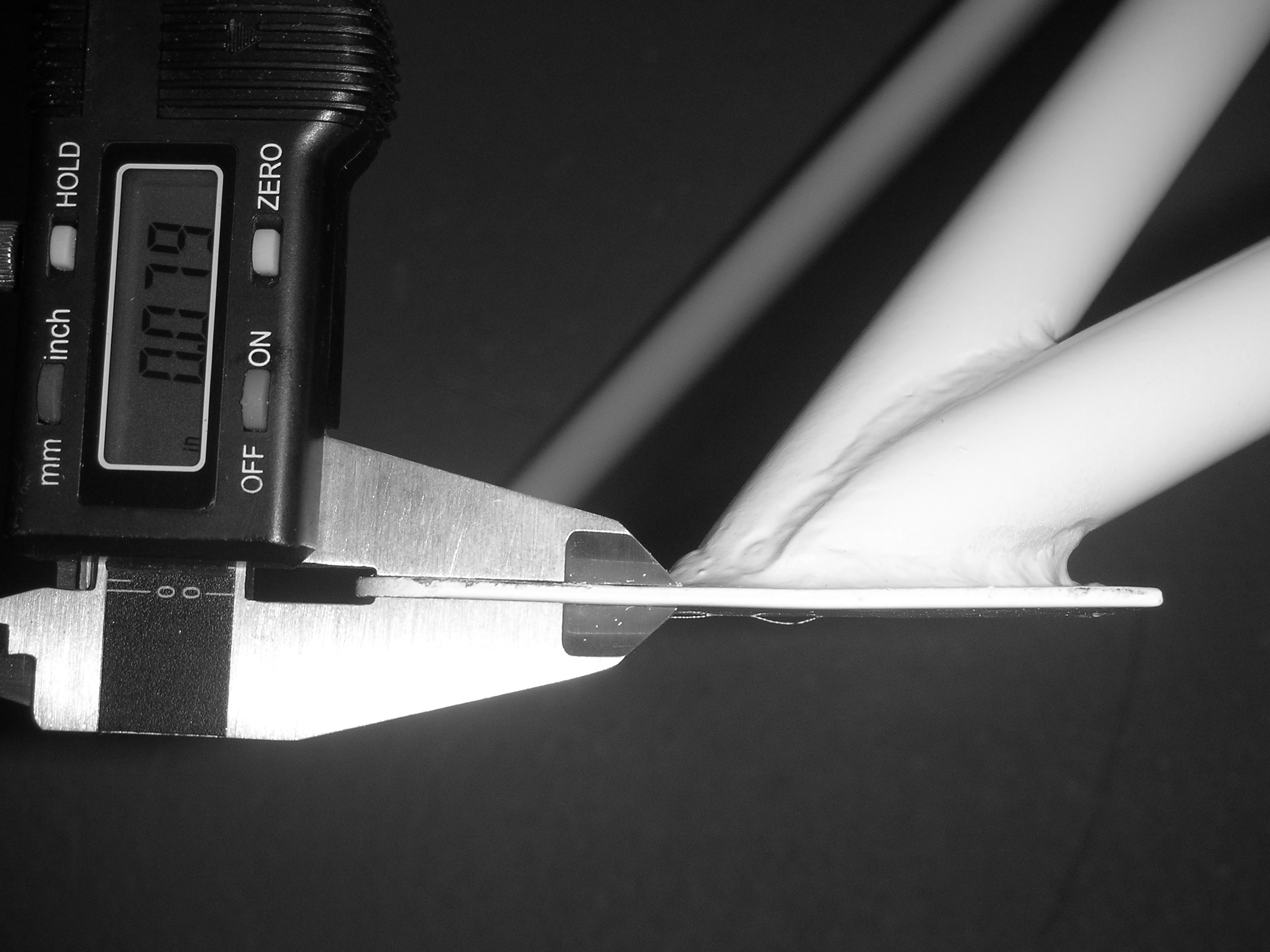

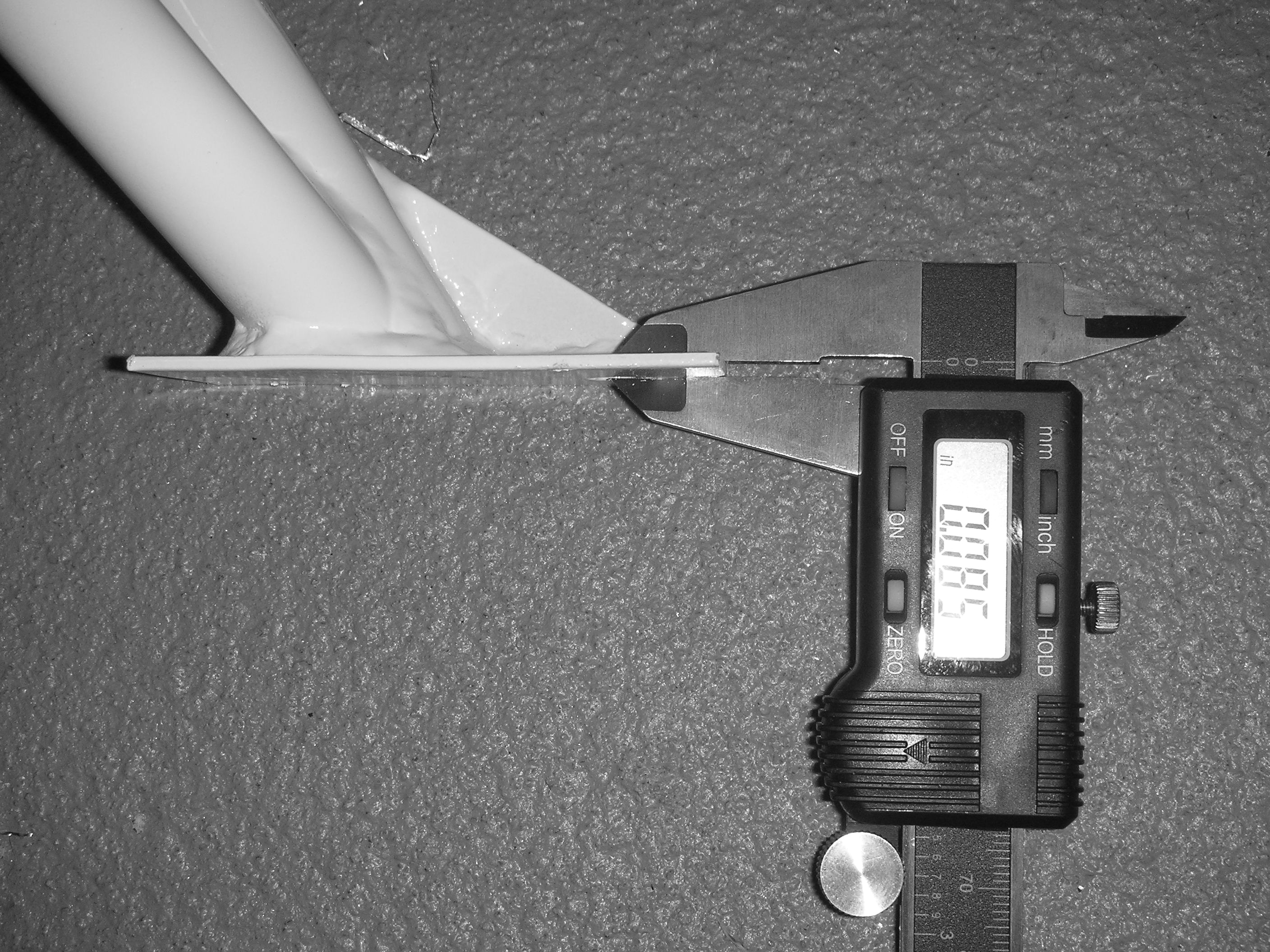

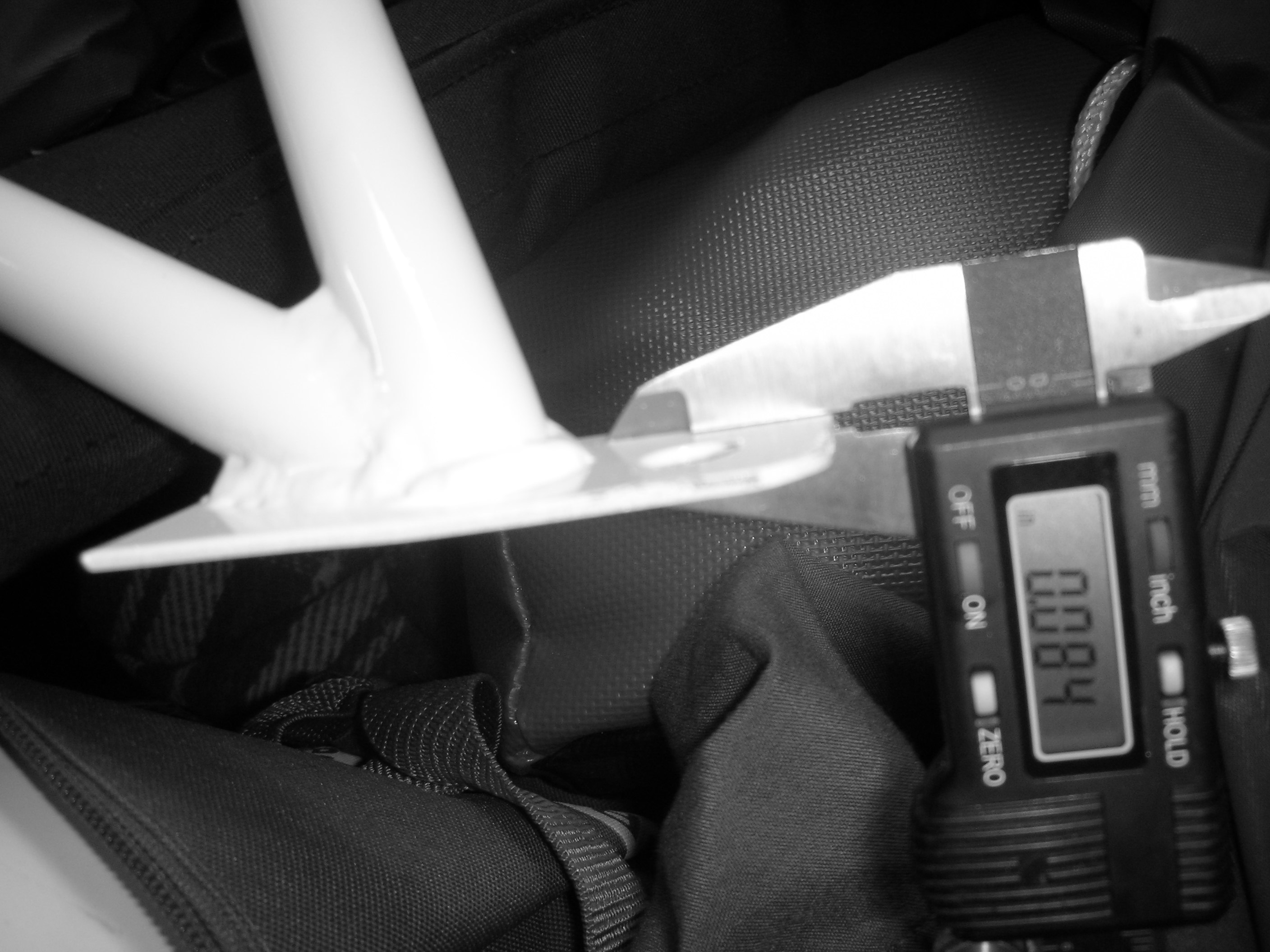

Looking at my Engine Mount for a3300 on a 601xl [Supplied by Jab USA] and noticed the Firewall Attachment Plates are only 0.080” thick on the Upper L/H and both bottom plates. The upper R/H is 0.125” thick. On the Zenith drawing6-JE-1 it specifies that all should be 0.125” thick. Has anyone else come across this anomaly Cheers

Here are some pics of the suspect Engine mount

PostPosted: Wed Sep 03, 2008 7:38 am    Post subject: Firewall Attachment Plates Thickness? Reply with quote
Not sure what the problem is , I suspect just the thickness of the powder
coating and nothing more, it is highly unlikely that someone has use
different thickness materials.
nick

The problem is that the plate should be 0.125" [1/8] thick and they are only 0.080" [3/64]thick. [ they are painted only] They used the wrong thickness material.Received an email from Jab USA stating that their welder does not use 0.080".I wonder where they then got this Engine Mount from? Rolling Eyes
notsew_evets(at)frontiern
PostPosted: Wed Sep 03, 2008 1:41 pm    Post subject: Firewall Attachment Plates Thickness? Reply with quote
Looking at my 3300A mount it seems thick. Like .090. Both sides are the
same....
Possibly the botton plates are .060. ????
These mounts should not be powder coated.
Cracks can develop and with powder coatings might not be seen.....
I know many builders do powder coat but Jabiru suggests not....
PostPosted: Wed Sep 03, 2008 1:55 pm    Post subject: Firewall Attachment Plates Thickness? Reply with quote
Your probably right. I was guessing at the thickness.....
I got my mount from Jabiru West.
It looks beefy....
SW
