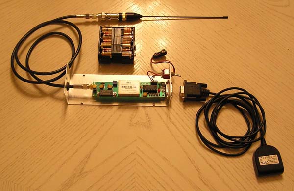

Sam Buchanan wrote an article for Kit Planes (Aug. 2008) about the Amateur
Radio guys (hams) and a system they had for automatically reporting
position. He had put one in his plane and the article was about using it. I
thought it was the neatest thing I had seen for some time so I got the
equipment and made a transmitter for myself. I made mine portable and
powered it with a battery pack I got at Radio Shack (a plastic holder
containing 8 AA batteries) and got a 2 meter rubber duck antenna at Fry's
Electronics. The switch is so I can turn it on and off. I taped the rubber
duck antenna to the shoulder belt near the cabin roof and laid the unit on
the rear seat with the GPS antenna laying on the glare shield. Seems to
work great. I like the idea that position is available real time on the
internet and friends/family can track and anticipate your arrival/rescue as
required.
Total cost is under $300 and the next step is to mount it in the plane and
wire it into the plans 12V system with a switch just in case I'm doing

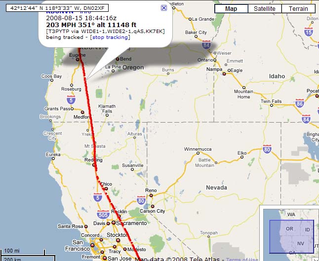

something I would not like recorded. On the picture on the track the
position bubble pops up if you click on any of the dots and give speed,

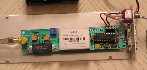

heading, and altitude. The transmitter is only about 5 inches long, required
from 9 to 30V and comes with a db-9 connector that you solder to the board
and than connect the GPS antenna. It has an SMA connector for the
transmitting antenna so you may need either SMA to BNC adaptors or a cable
made up with the required ends. Hey, I have tracks to/from Oshkosh and a
trip from Yuma thru CA to Oregon, Idaho, and back home. I used to fly to
burn up gas but now it to make tracks!

small serial wire to it. The pictures Albert put out don't do it
justice as to the small size, either....it's deceiving, but these
things are tiny. They're about the size of a screwdriver handle,
but weigh maybe as much as two AN5 bolts an inch long. Real small.
So even for the weight conscious they're no worry.
speed,
required
board
cable
