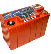

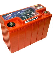

I think you are talking about the Odyssey "Dry Cell" battery series? If so, they technology they use is "absorbed glass mat." The Odyssey folks call them "Dry Cell" because if you were to break open the case, no electrolyte would run out. It is totally contained within the glass mat material.
So, yes, a bit of advertising hype. But it is still an excellent battery. I have an Odyssey 680 in my (under construction) Europa. The battery is 5 years old. I've been using it to test the panel as it was installed. There were periods as long as a year and a half where the battery sat unused. It held a charge for those unused periods. After 5 years of such abuse, it still turns the engine (Rotax 914) over quite briskly. Prior to first flight, I'm troubleshooting a few last gremlins in the instrument panel and it will run the panel all day long. When it's time to replace it, I'll have no hesitation replacing it with another new Odyssey.
material.
Odyssey.
The Odyssey batteries are a product of the old
Gates-cum-Hawker-cum-EnerSys prismatic cell batteries
built here:
http://www.odysseyfactory.com/about.html
Got to tour this plant a few years ago while on
assignment with Raytheon/H-B. The full line of
their products can be seen at:
http://www.odysseybatteries.com/
Without a doubt, these products are at the leading
edge of battery quality and performance . . . with a price
to match. As I recall, about 700 folks running a highly
automated manufacturing process produces about 60,000
batteries a day!
But it's still an SVLA battery loaded with the same
water-acid mix used by their competitors.

B&C offers a 12 a.h. with fat-wire connections . . .
http://www.bandc.biz/BC103-1.pdf
I believe this is the Odyssey PC545
http://www.odysseybatteries.com/battery/pc545series.htm
which has a 14 a.h. capacity at the 20 hr rate.

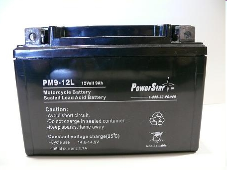

Do you have a specific part number for Deka? While looking
for them I found this "Power Star" product on Ebay
It's a 9 a.h. device, probably at the 20hour rate. This makes
it a 4.5 a.h. battery for powering an e-bus for 3 hours . . .
i.e, about 1.5A ebus. Size is L = 5.91 x W = 3.39 H = 4.21
A 9 a.h. battery would weigh in at about 7-8 pounds.
 Filesize:  78.79 KB
 Viewed:  626 Time(s)
