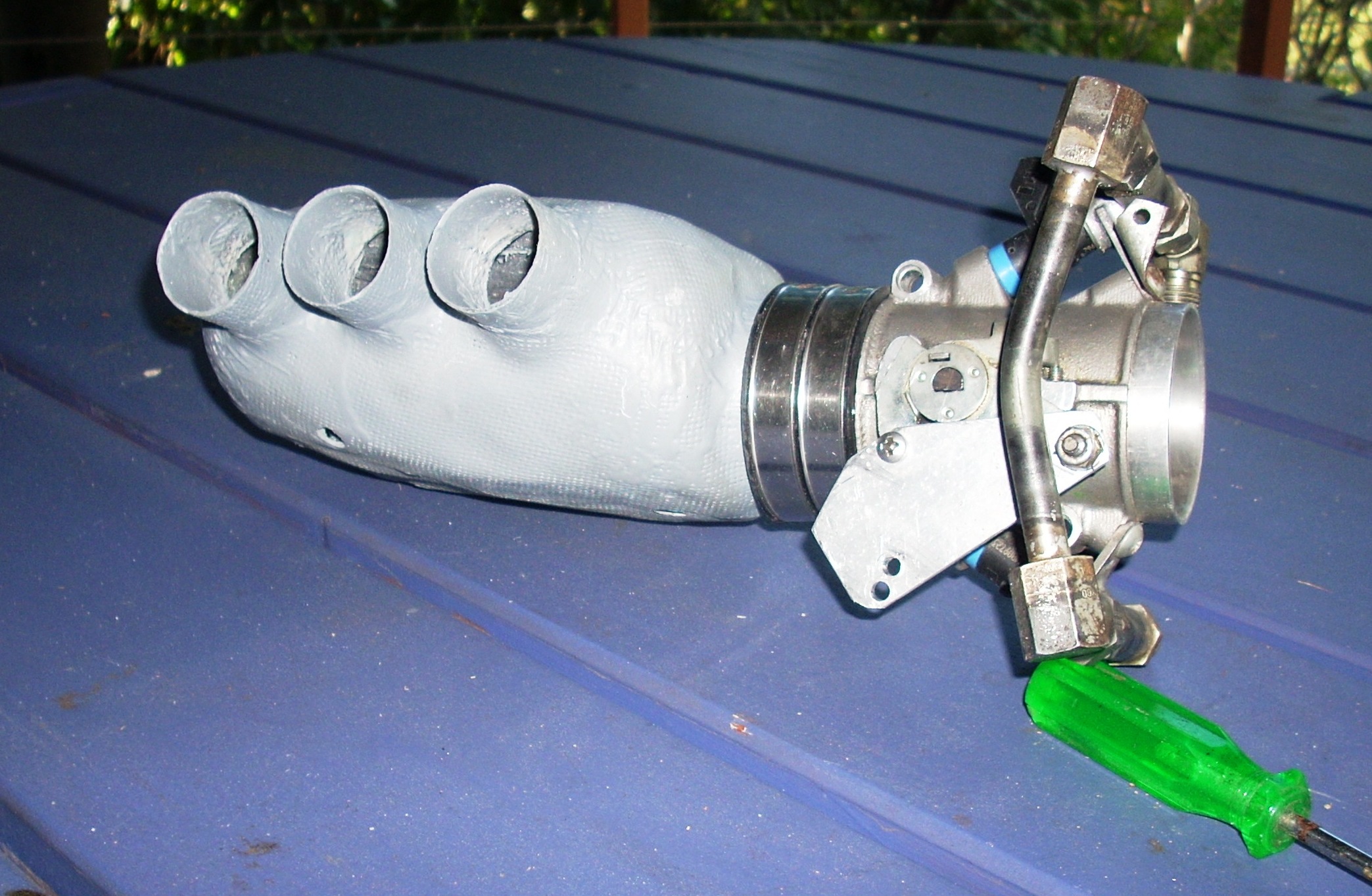

I have a 3300 in a Quickie now designated a Q-200.
I have conducted many trials to overcome the tendency to run rich above 2700
and discovered that the carb as supplied is fitted with a large float needle
seat 2.25mm which is released by Bing for use with gravity feed. I got
advice from the Bing engineer in Germany. I tried the Bing recommended 1.5mm
seat and it was too lean but got rich when I started the electric boost pump
ie even the smaller seat was leaking under pressure from two pumps. The carb
power needle was selected by Jabiru to provide a compromise performance
setting using the 2,25 seat. I also noted that EGT varies with engine load.
According to Doug Smith it is intentional by design to run the engines over
rich above 2700 even to use up to 40LPH. That is a conservative way to
protect the engine from burnt valves. I was using 36LPH.
Now I have fitted a single barrel twin injector throttle body (Jenvey) and
can over ride the ECU injector dwell time (mixture) with a potentiometer but
EGT still varies. It is even at top of climb then goes to 10deg variance as
the aircraft accelerates. When the EGT is 100degC or more variance the
engine starts to run rough due to unequal boxing power strokes and I would
not be surprised if this contributes to broken flywheel bolts. The factory
told me they often find the RH side is 100degC hotter (like mine) and they
recommend playing with the scat hose intake.
I blame the lack of a plenum. The carb is fitted direct to a collector which
is very restricted inside. Even the entry is restricted.
I have made a 6 port plenum in fiberglass (pic attached) and hope that this
will improve the fuel/air distribution. Ideally it would be an updraft
design but I don't have the space.
I am getting 170KTS CAS at 3000 ft ( 4mph true) at 3000 RPM WOT. My prop
is a Sterba 55X72" pitch and is a bit over pitched but I think the engine
has more potential and of course it is not really fully run in and is tight.
I suppose the Esqual performance will be close or better than the Q-200.
Good luck with the barrel nut job and I look forward to hearing from you.
Cheers
Peter
Queensland
OZ.
