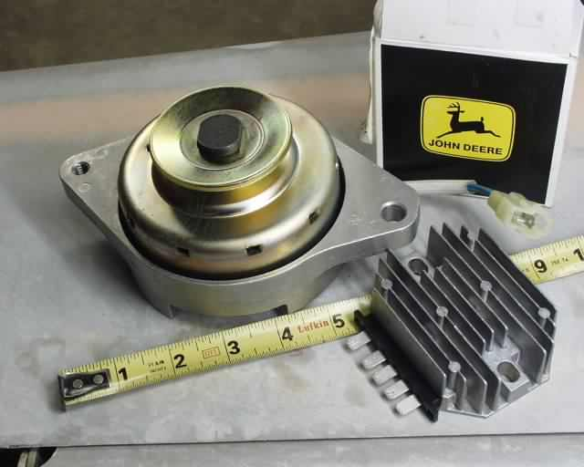

Hi all,
I have a question concerning using a dynamo at higher engine speeds. I am looking at reducing my FWF weight, and considering some of the smaller alternator installs. I am currently using a ND IR alt, which is fine, but in lurking around, I'm becoming rather concerned about the weaknesses of these units. Unfortunately, not much else is available in this class; i.e. size and weight. All of the externally regulated alternators I've seen are much too large and heavy for my application.
I'm installing Z-13RB on my new plane, and plan on incorporating Z-24 alt disconnect contactor in line with the OV module.
However, my Suzuki G10 three cylinder runs at 5000rpm in cruise, and 5500rpm on takeoff. The JD AM877557 PM alt puts out 20amps at 2500rpm. I'm running double that. Short of re-doing my belt drive setup with a 12 inch pulley, what are the ramifications of running this little alt at these speeds? by the looks of it, the small pulley on the unit would spin it up to 10,000 rpm. I'm aware of the mechanical limits (bearings, etc), my question concerns the power output to the system.
Any help would be much appreciated.

At 07:52 AM 8/11/2008 -0700, you wrote:
Hi all,
these units.
Can you give us your perceptions of "weakness"?
??? I got lost here. Z-24 speaks to classic,
wound field alternators like ND . . . are you
looking for a wound field or permanent magnet
fielded machine?
Mechanically, no problem. Raising the speed increased the
AC voltage to be "rectified and regulated" down to
14v for operating your equipment. There ARE switch-mode
regulator designs that would handle this job nicely
but that's a whole separate development program.
Valid concerns as I've suggested above. Those things
run 20-30 VAC output at 5000 rpm so you need to plan
on 2x that at 10,000. Increasing speed is a good way
to get more energy OUT of the PM package as long as
the electronics can handle it but it's doubtful that
any regulator presently exists that fill your
requirements.

I have a couple of hundred hours on a JD 20 amp PM alternator spinning
at about 8500 rpm with the JD regulator. Occasionally up to around
11,000 rpm. My somewhat hazy memory is that it needs more like 6500 rpm
to put out 20 amps. Someone (Langford??) has a website with a bunch of
info on using these. I fitted a multi-v pulley that probably loads the
bearings a bit less than the original single v pulley.
From memory the unit is around 4.5 lb plus regulator compared to around
6 lb for the conventional 40 amp ND alternator that I mentioned earlier,
so not a big weight saver. I don't have any reason to think either is
more reliable. In fact it seems that the JD regulator will fail if you
start the engine with a totally dead or disconnected battery. A small OV
relay will suffice on the JD unit instead of a heavy contactor though
and mine is wired between the alternator and the regulator. There are
smaller PM units available such as Kubota units.
Ken

PostPosted: Tue Aug 12, 2008 5:38 am    Post subject: Re: John Deere dynamo Reply with quote
<snip>
Only what I've read of your attitude/opinion (for lack of a better term) on them around the list. Correct me if I'm wrong, but I get the overall impression that you do not believe IR alternators belong on aircraft. Of course, it is possible that you don't agree with how John Q Builder tends to install them, i.e. no OV protect, no Alt disconnect contactor, etc. I get this from some old postings on the subject, and the deletion of any schematics that show IR alternator installations. I should add that there isn't much available for my type of engine (Geo Metro auto conversion), and weight is a significant issue up on the nose of the Kitfox.
<snip>
>>>fielded machine?
What I'm looking for, ultimately, is to shave about 10lbs from the nose of my aircraft. To that end, I'm exploring options for various components. More specifically, I'm looking for 20-40 reliable amps for my electrically dependent FI engine. Beyond that, I'm open to suggestions.
I was referring to the old Z-24 that depicted the alternator disconnect contactor for the IR alternator, driven by the alt field wire, that completely disconnects the alternator from the battery (system) in case of OV condition. That's what I'm running now on my current install. The note on the new Z-24 again leads me to believe you are not in favor of IR alternators on aircraft. Again, correct me if I'm wrong here.
<snip>
That's why I'm asking. I should point out that I'm not very electrically/electronically savvy (..got to know my limitations). That's why you, this list, and Aeroelectric.com are such valuable resources for me. I'm asking the advice of those much smarter than I on such things.
<snip>
>>>requirements.
>>>Bob . . .
My electronics are minimal. I'm running an EFIS that draws about 100mA max, my GPS and Radio are handhelds that are plugged in to charge, and a small portable intercom. I've got Kuntzleman strobes and LED Navs, and two 55watt landing lights. If it all dies, my pressure driven AoA gives me speed, and a ball keeps me centered, the rest is VFR (blue up/brown down). GPS gets me to "Nearest", and my radio will last a while all by itself. I'm strictly Day VFR, with no provision or desire to night or IFR. Night someday, NEVER IFR in this plane. So my number one concern is keeping the EFI and fuel pump running. My new plane will have Z-13RB installed to this end. I don't even plan to put in the endurance bus, as I've got nothing that needs it. It even works to the end of having the second small battery in the back to help offset the CG of the heavier engine, rather than just putting in dead weight.
In the end, I think the JD dynamo will not be cost effective. For what they cost, I'd be shelling out $40 per lb for the weight savings. Probably not worth it overall.
Bradley

Sounds like a 3.5# SD-8 would do nicely for you. There are
thousands of LongEz and VariEz aircraft flying with this
machine as the only source of engine driven power.
But if you wanted to put a little 35 or 40A wound
field alternator on, that would not be a bad
decision either . . . internally or externally
regulated.

By installing Z-13RB with Z-24 integrated, I'm providing for the bad alternator all together, by disconnecting it from the system entirely. From then on, I am carried by the battery(s), and need to design enough ah margin to get me home or nearest, anyway.
Ummm, I'm sure they're great units, and would do fine. But I can't use the gear drive.

No ones talking me into anything. I'm trying to decide how to proceed
on my new airplane.
I haven't analyzed it. I have no idea how to check the ECM and coil
draw. Right now I have 55amps, Z-24, and 17ah running the motor just
fine. I have two readily available alternator options, both 40amp, one
weighs 6.5lbs, the other 4.5 lbs. I'm just trying to figure out if
there's a better way to wire up the new airplane. If I can install the
JD dynamo with external reg, spin it up to 9000rpm, and live to tell
the tale, I'll consider it on its merits. But I would like to know if
it's feasible to do so, or a bad choice due to something I'm not being
told by the advertising.
Bradley
Beemer
KF2 (and now an M3!)
Middle Georgia

I didn't grasp until now that you were running an
automotive conversion . . . okay, how about the 3.5
pound cousin to the SD-8
http://aeroelectric.com/Pictures/Alternators/Kubota.jpg
This critter is good for about 12-15A when turned
fast enough and assuming that the companion regulator-
rectifier isn't over-stressed by the higher input
operating voltage. I've prayed a bit over the
schematics for an exemplar device . . .
http://aeroelectric.com/Pictures/Schematics/3-Phase_PM_Rectifier_Regulator.gif
. . . and it seems likely that the device would
tolerate the higher rpm. In a few months, I'll have
a drive stand up and running and will be able to
test the hypothesis in the shop. If you're willing
to invest in the experiment, you can supply results
that would be of interest to lots of other folks
here on the List.
I haven't analyzed it. I have no idea how to check the ECM and coil draw.
Right now I have 55amps, Z-24, and 17ah running the motor just fine. I
have two readily available alternator options, both 40amp, one weighs
6.5lbs, the other 4.5 lbs. I'm just trying to figure out if there's a
better way to wire up the new airplane. If I can install the JD dynamo
with external reg, spin it up to 9000rpm, and live to tell the tale, I'll
consider it on its merits. But I would like to know if it's feasible to do
so, or a bad choice due to something I'm not being told by the advertising.
The risks for trying are low. The regulator's stability
might be less than idea and/or the regulator could fail due
to higher than design voltage. As long as you have OV protection,
risks are to the regulator only.
One thing we DO know is that automotive wound-field alternators
do live happily in airplanes running 10,000+ RPM. This is the
next-to-zero-risk approach.
How much time are you willing to invest in the experiment
to validate the 4.5# decision?

Bob, this is a switching type regulator, isn't it?
I'm using a PM generator, and I'm unsure about the regulator that came
with the kit. From what I can gather, it appears that Harley-Davidson is
still using linear regulators. I'd rather avoid that extra heat and
wear if possible.
http://www.ernest.isa-geek.org
PostPosted: Sat Aug 16, 2008 12:17 pm    Post subject: John Deere dynamo Reply with quote
At 12:05 PM 8/16/2008 -0400, you wrote:
<echristley(at)nc.rr.com>
Uhhh . . . I guess you could call it that. It's not the
legacy switch-mode regulator where duty-cycle controlled
switches, inductors, capacitors and catch diodes do high
efficiency voltage shifting.
These are simple series switches that either reduce
throughput by delaying the time between waveform zero-
crossing and the firing of an SCR at the optimum later
time to throttle throughput. It's exceedingly simple
and adequate to the task if not terribly efficient.
These regulators use single junction diodes AND
4-layer SCRs. Total voltage drop in the on-state,
especially in a 14v system chews up quite a chunk
of system efficiency. They're better at the higher
voltages so a 28v version is not quite so bad.
I've often thought about rewinding one of these
things for say 60-80 volts of 3-phase AC output
that would then be rectified and conditioned by
a REAL switch-mode supply. But pencilling the numbers
wasn't a BIG improvement in efficiency and a BIG
increase in parts-count.
still using linear regulators. I'd rather avoid that extra heat and wear
if possible.
I doubt that any one does a true linear regulator
at these power levels. They HAVE moved from the
pure shunt (waste what you don't need) type of
regulator common to 1970 designs) to a series
configuration that does not waste as much energy
overall. The only heat issue is in keeping the
regulator itself cool . . . and as you can see
in pictures of the various products offered, the
BIG guys are in cast housings with fins. There
are no significant wear advantages between the
various offerings as long as things stay cool
enough.
