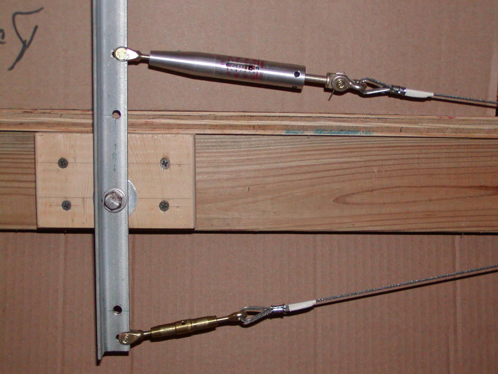

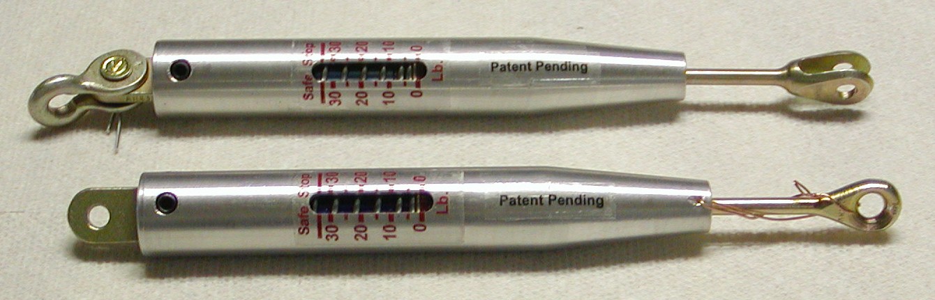

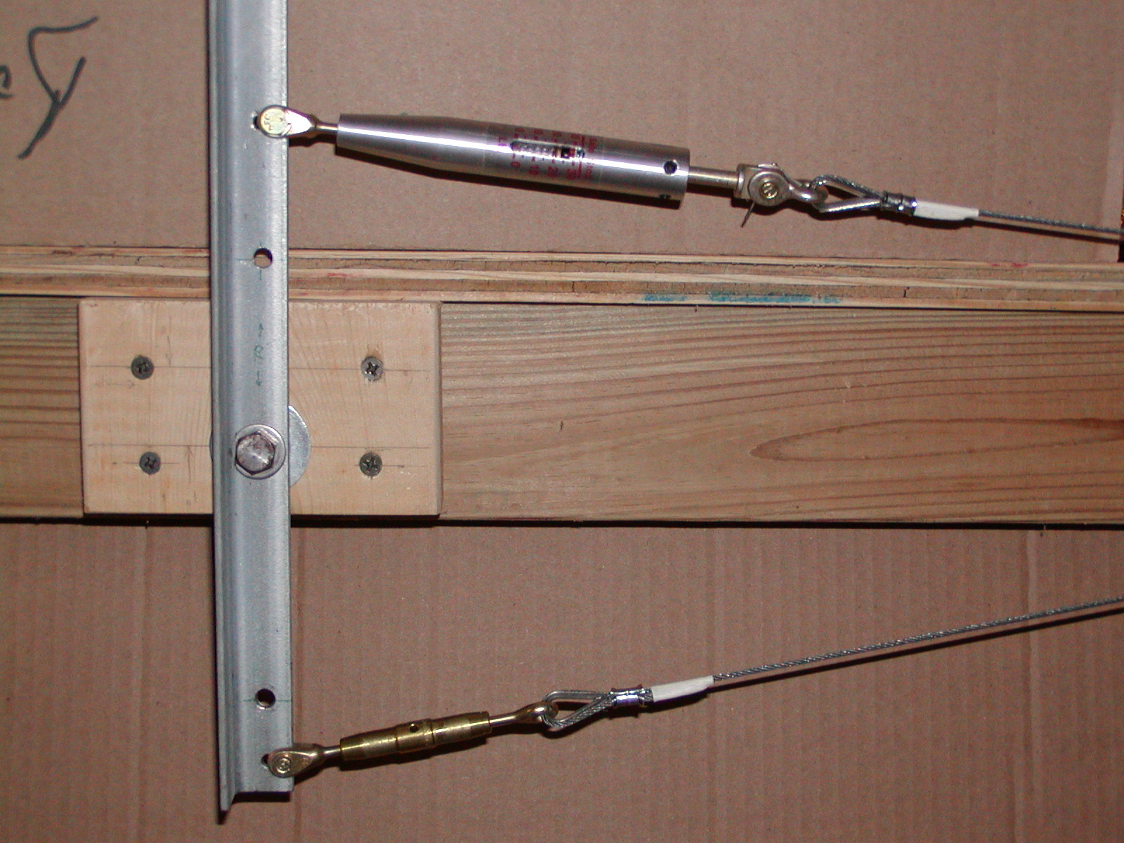

PostPosted: Mon Aug 11, 2008 5:54 pm    Post subject: Re: aircraft cable tension meter - a new solution Reply with quote
Zenith builders-
With Chris Heintz's letter and this thread of interest on the 601 list, I have been told by my patent attorney that it's OK to talk about this: For a year in my spare time after completing a 601 fuselage as part of a team build, I've been developing and preparing to patent a device to allow in-line setting, adjusting, and easy visual inspection of the tension in cables. The patent covers aircraft and other applications. It takes the permanent place of one turnbuckle in any of the 3 axes, serving that tightening function during installation. It's in testing now for ultimate strength, and will be shopped around soon. Based on the CNC production prototypes, I expect it will cost $60-80 each.
The prototype in the attached photo (on its control simulator for test and evaluation) has a nominal setting of 30 lb as shown. It hits a hard stop in the event of a 10% dynamic overload that prohibits flutter, and will maintain at least some cable tension in the event of a component slip of up to an inch that can immediately be detected at visual inspection since the device is in-line all the time.
I would appreciate the interest feedback from this small but dedicated group, on both the technical aspects and price points. The aircraft cable version is such a small niche that I'm not sure it's worth chasing.
Regards to all -
David Glass
(fuselage builder, N253DG/601XL/3300A, in airframe integration now)
A pair of in-line tensiometers, with different end hardware configurations, in relaxed state.
 Filesize:  134.83 KB
 Viewed:  1436 Time(s)
CNC production in-line tensiometer on test stand (David Glass)
 Filesize:  456.99 KB
 Viewed:  1450 Time(s)
David Glass
