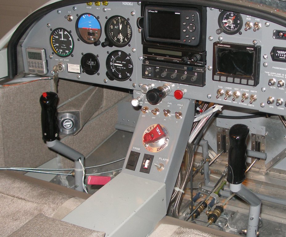

PostPosted: Sun Aug 10, 2008 6:38 am    Post subject: 6k2-3 side fairings Reply with quote
Chris,

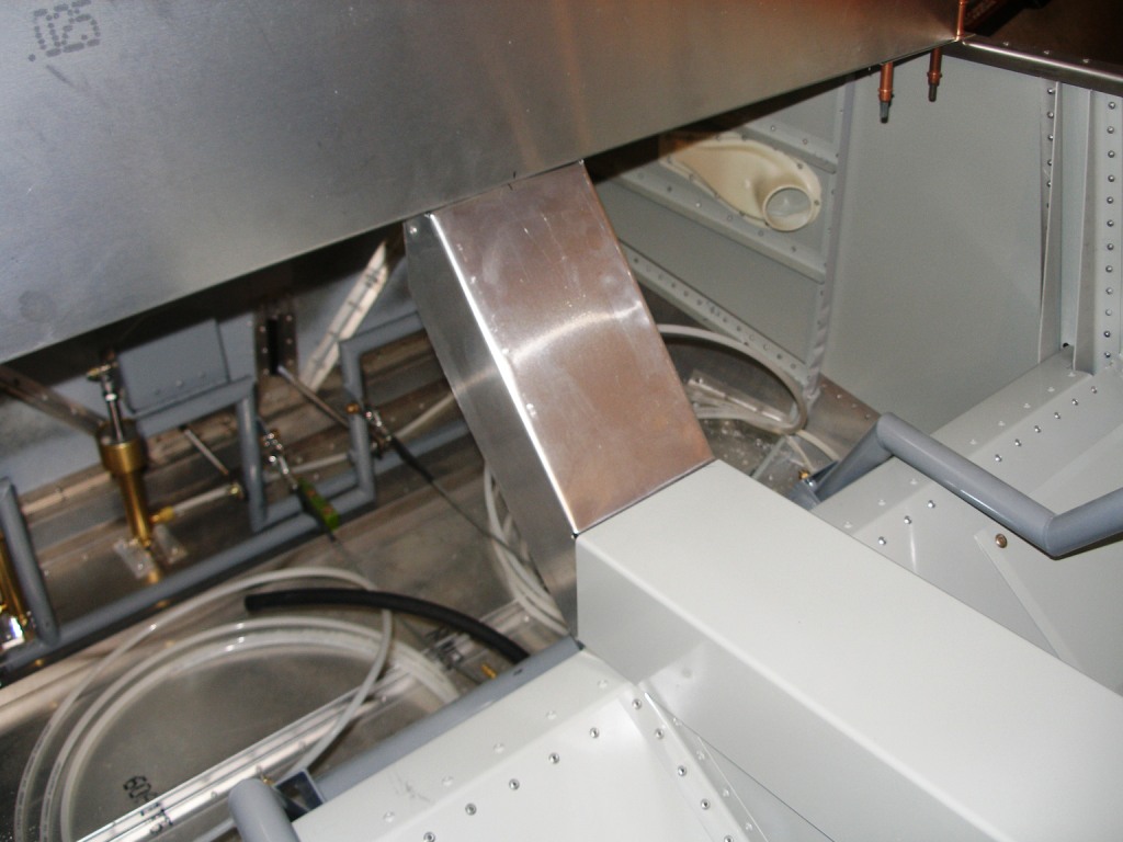

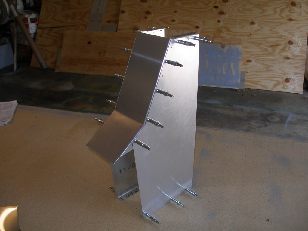

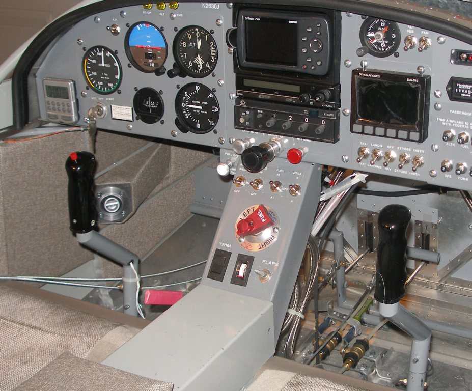

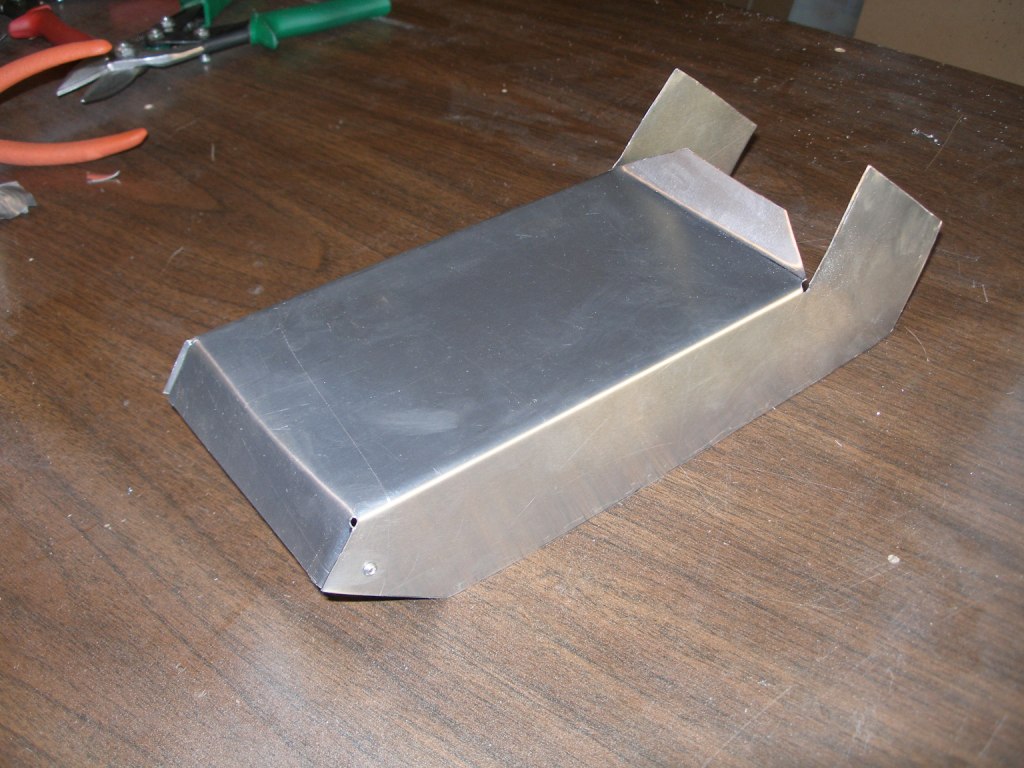

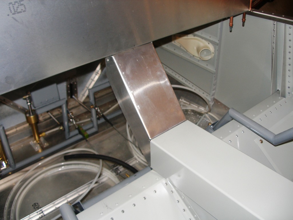

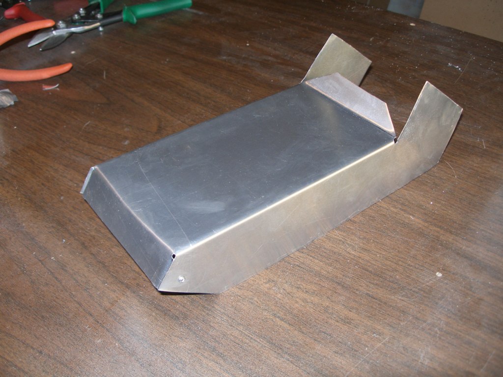

I have attached photos and drawings of my center console.
The first photo is the console that came with my kit, which doesn't
work with dual sticks.
I actually made two more console panels, but this is the final one,
.025" 6061-T6 (would be better with 0.32").
The drawings are in two parts because it is larger than a letter-size
piece of paper. The match line should be exactly 10" long for correct
scale.
I may someday figure out how to make fuller side panels to hide some of
the miscellaneous "stuff" under there. None of it is in the way, but
it looks cluttered in the photos.
Let me know if you have questions.
Jay in Dallas CH 601XL N2630J "Lil Bruiser"
