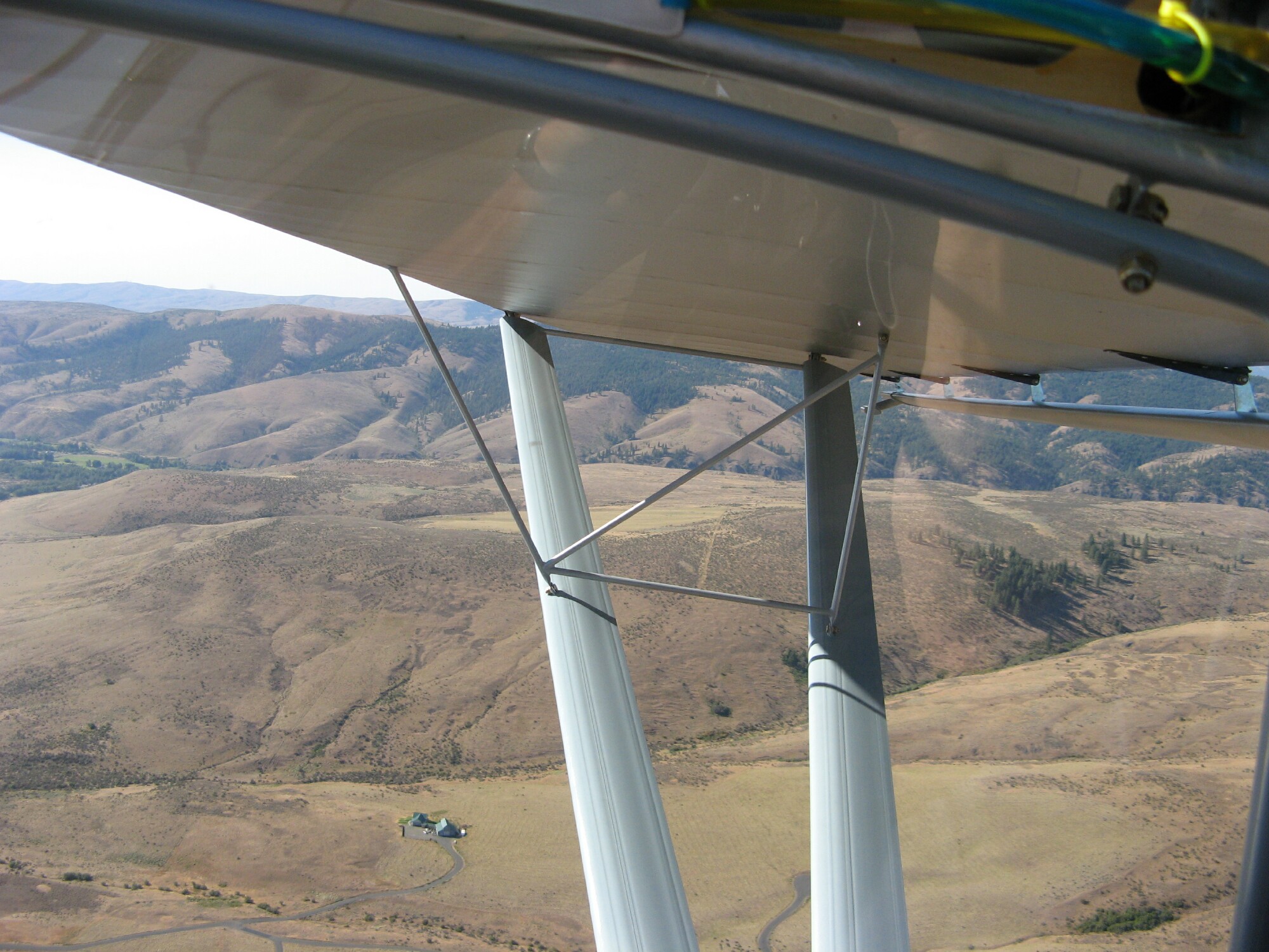

I have a set of wood wing strut fairing. They weigh eight pounds so I guess they may be about 10 pounds total when installed. I would like to somehow temporarily install them to find out if the benefits outweigh the weight gain. Does anyone have a good idea how to securely attach them for some testing and then be able to easily remove?
My classic 4 has a small engine so every ounce counts.

Tom Jones
Joined: 12 Mar 2006 Posts: 752 Location: Ellensburg, WA
Posted: Wed Aug 06, 2008 8:09 am Post subject: Re: Temporary strut fairing |
| Mnflyer wrote: | | Hi Tom, I installed the PVC type fairings in May of this year and got about 6 to 8 mph increase in cruise. I had all the balsa cut and spade when these came up for sale, and the installation is a lot simpler. |
I looked at the PVC fairing at the Arlington Fly in then ordered a set. I test flew yesterday. Check out the attached pictures of the Airspeed before and after. You will have to take my word that these are both straight and level. I don't have a VSI. This is a Classic 4 with a 503 mind you. I am pleasantly suprised!

Hi Tom C that looks pretty good for the strut fairings. About 10 MPH!! Just curious C how did you end up with a front tank in a Kitfox 4? I thought they went away with the Kitfox 2. Do you also have the wing tanks? Jim Chuk Kitfox 4 building C Avid MK IV flying C MN

Mnflyer wrote:
> Hi Tom C I installed the PVC type fairings in May of this year and got about 6 to 8 mph increase in cruise. I had all the balsa cut and spade when these came up for sale C and the installation is a lot simpler.

I forgot to include the weight of the PVC fairing in my earlier post. Bare fairing with aluminum cuff for lower ends was 11.5 pounds.
For what its worth department. I reweighed the airplane after fairing instillation. It has gained 26 pounds total since I weighed it a little over a year ago.
Besides the fairing this weight includes a fire extinguisher, hand held radio on the panel, hand held GPS on the panel, portable intercom on the butt rib, operator's manual and other paper work, baggage sack with 1/4" plywood bottom, plus all the miscellaneous clamps, screws, fire sleeves and such that continue to find their way into and onto an airplane. It all adds up to some pounds after a while.
